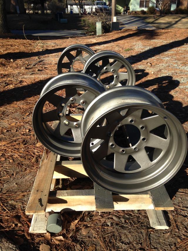

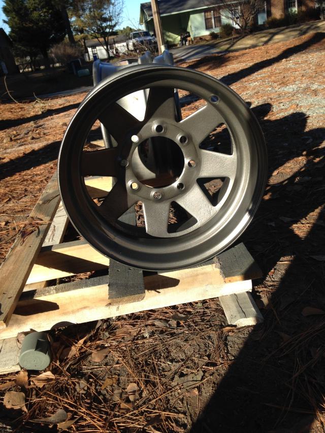

I used VHT Engine paint because it uses heat to cure and is chemical resistant. This means salts and detergents won't mess with it. I just baked each wheel in the oven for an hour at 200*. So far the finish is rock hard and I am very happy.
