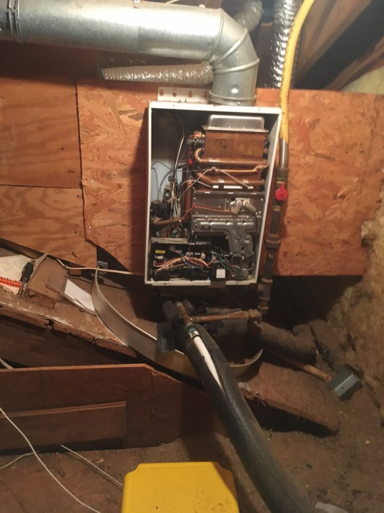

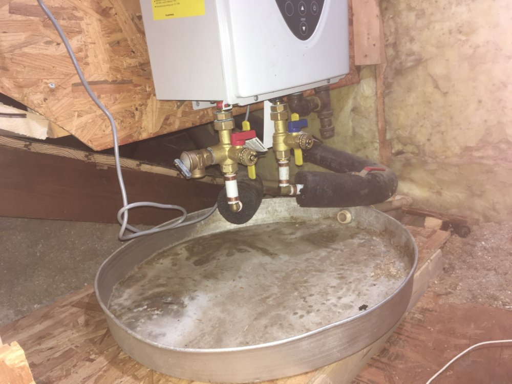

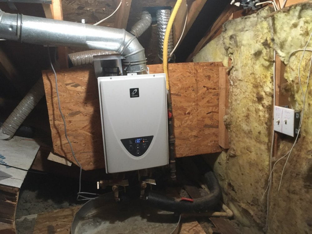

Well, the new water heater has been installed over a week and is working great. In the end I spent a little less than $1400 (Takagi tankless $579 and $797 on labor/valves) on the whole project. I now have the isolation/flush valves and it should be to code. Basic Plumbing out of Garner is who did the install. Locally most of the plumbers I spoke with, including Basic, wanted to use Navien brand heaters. In my case, for a model with comparable specs to what I had, Navien was almost twice the cost as well as physically larger. Given my space constraints, I went back with Takagi. It had over a gallon higher GPM than my original at almost exactly the same physical size. I purchased the Takagi off the web myself so I didn't have any mark up there from the plumber. I could have supplied the valves too but I assumed Basic would provide those. In the end the valves cost me about $5 more than if I had ordered them myself. There is a $150 rebate from Dominion Energy for any tankless heater with a EF .80 or more.
I did all the wood work in the attic to create more room under the heater for the valves, proper clearances and a level support for the pan.
This is what I started with.
This is how it was looked when it was done.
No condensation drain at the top where it attaches to the flu? My tankless required one unless you could slightly angle the flu down. Mine was on an outside wall so that was not a problem. Otherwise condensation can drain back into the unit and damage the coils.
That one looks like a non-condensing. No drain needed.
