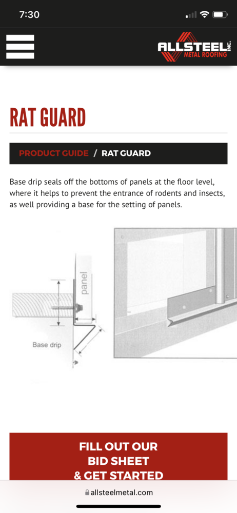

The bottom of the panel basically rests on the flat plane of the rat guard, so unless the rat is about 1/8" or less, it can't fit through the gap. That combined with the closure strip makes it pretty well sealed and insect/rodent proof.

Oh yeah, I get that. I thought you were saying that just those strips were a suitable substitute for the metal rat guard.
