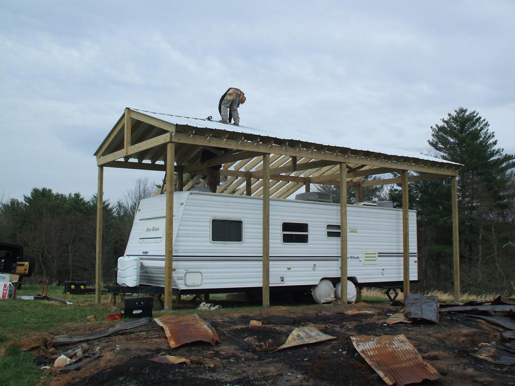

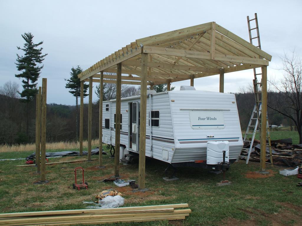

I (with the help of some friends) just put this up. All stick built. Posts are 4x6's and concreted in. It took a couple of days to do.
Did you burn the old one down?
Got any pics of the building?

We built a pole barn similar down at my grandads for the same purpose.
He has friends everywhere, but 92 years will do that for ya.
I got 12 decommisioned power poles and cut about 12" off the bottom of each and then trimmed the top to length...
Not really. I've got some in process pics and a bunch of pics of it stuffed full of junk that I haven't sorted out and turned into a shop yet.
