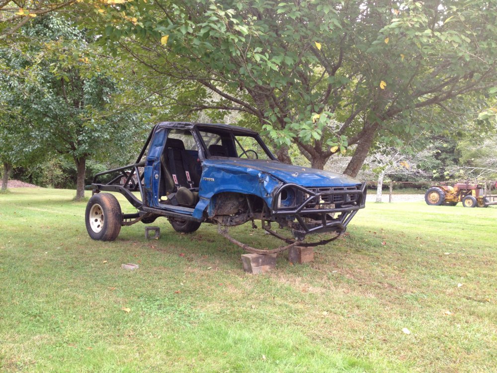

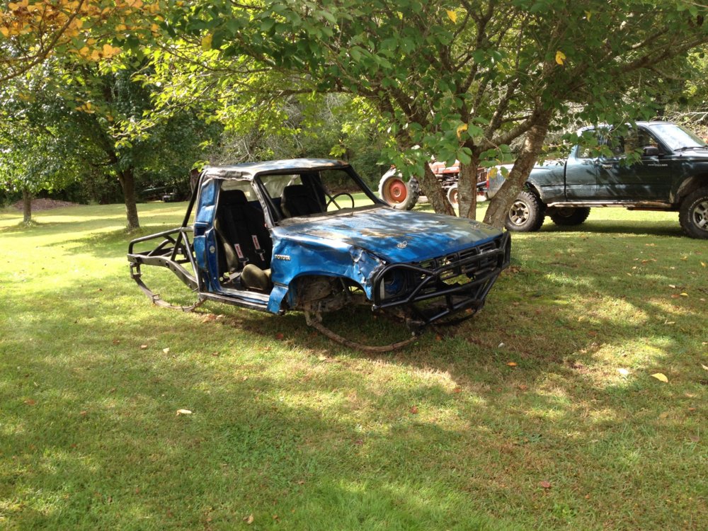

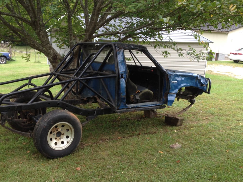

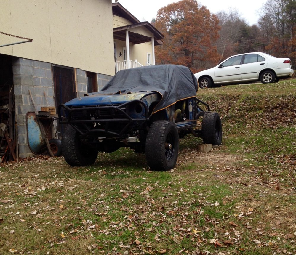

Some friends stopped by Saturday and dropped this off...
I already have most of the large components to put it together, although some toyota purists might consider what I am about to do heresy....

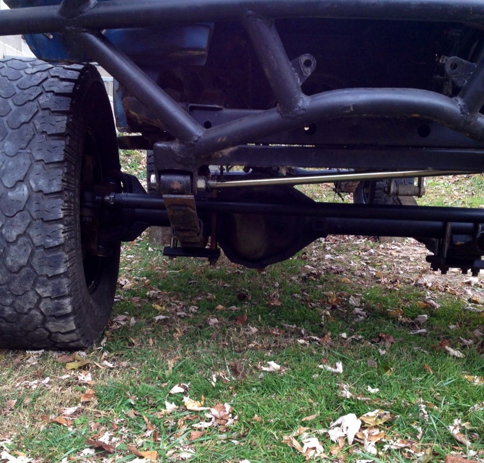

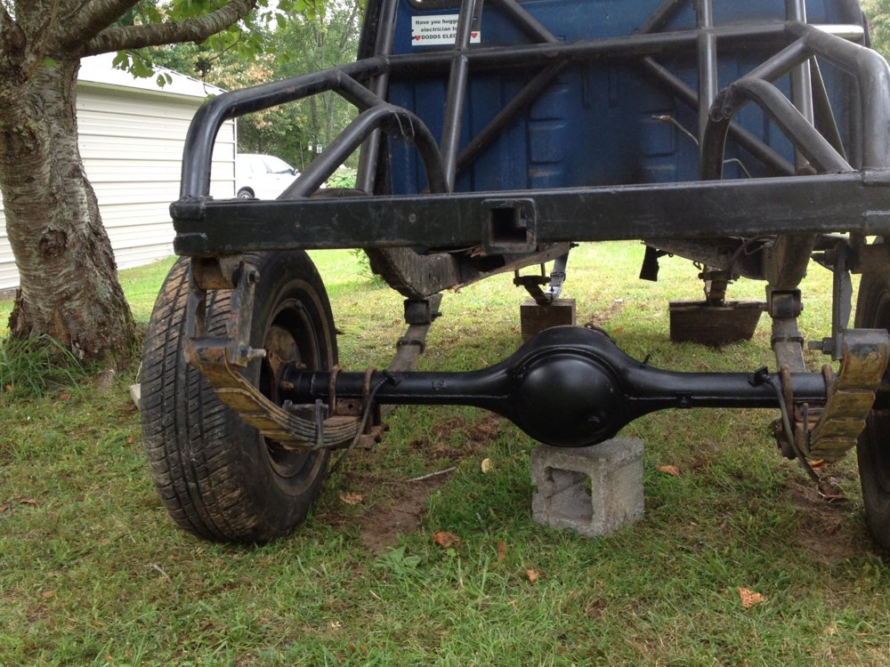

Plans are 4.3L on propane/SM420/dana300 with twin-sticks. dana 44 front and an isuzu 12-bolt rear. Since I dont really want to put 39" tires back on it, and my axles are already set up for SUA, I'm going to try and make SUA work.

Amazing how much longer the wheelbase looks now than in that pic. I wonder how those springs will flex in a SUA set-up?

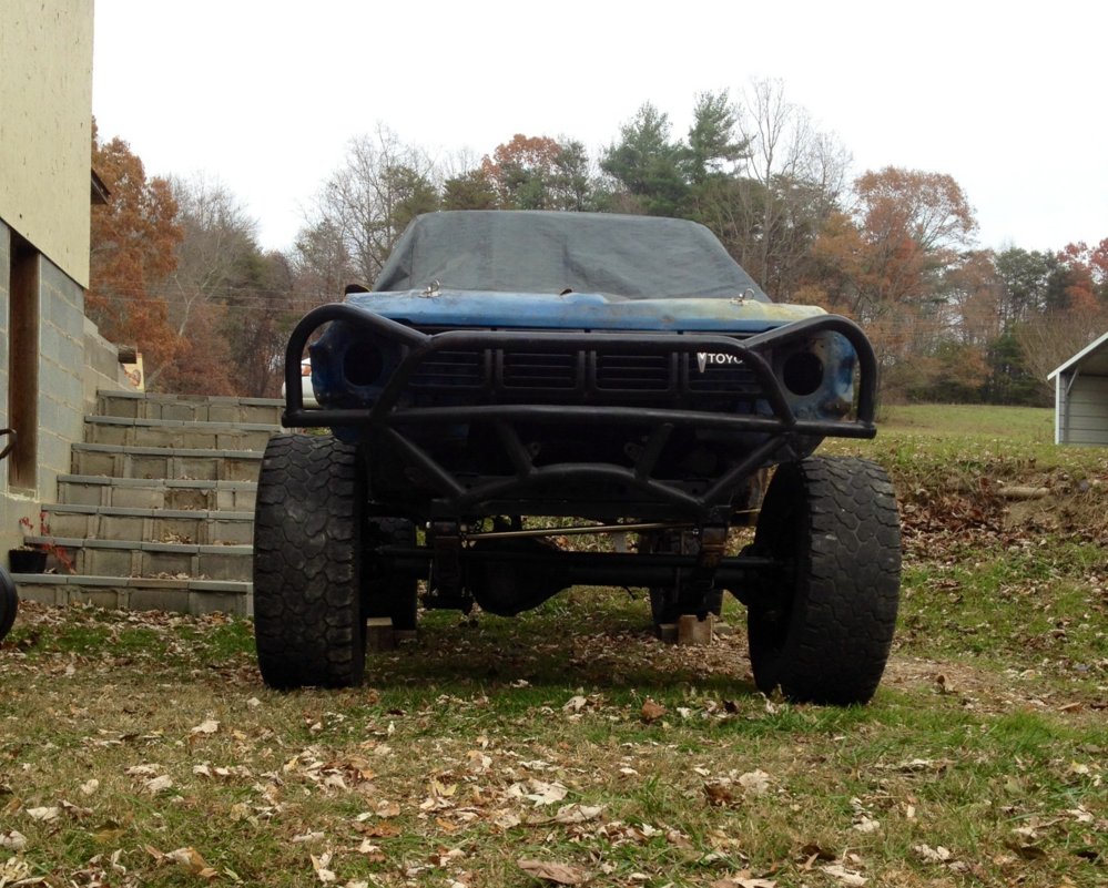

that front bumper looks pissed off
I know, and I like it. I took the fenders off because, let's face it, there's just not a lot of fender left. But if I cut the bumper down to fit the narrower front end, it will ruin the look. So now I need to find a way to fit some fenders back on. I've got a good idea, if I can make it work.

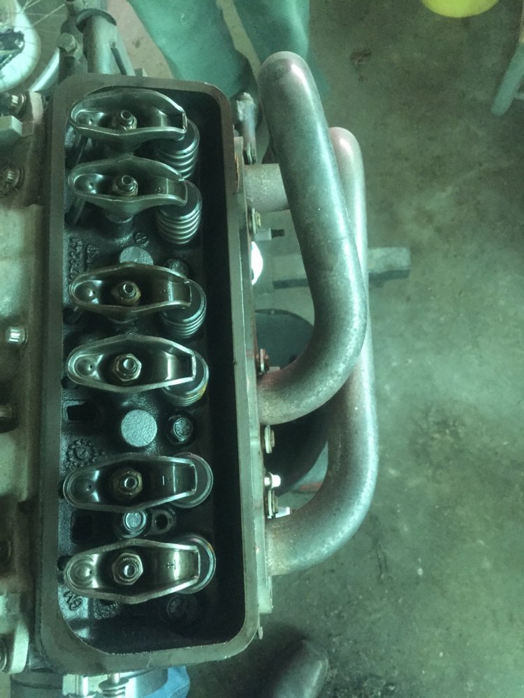

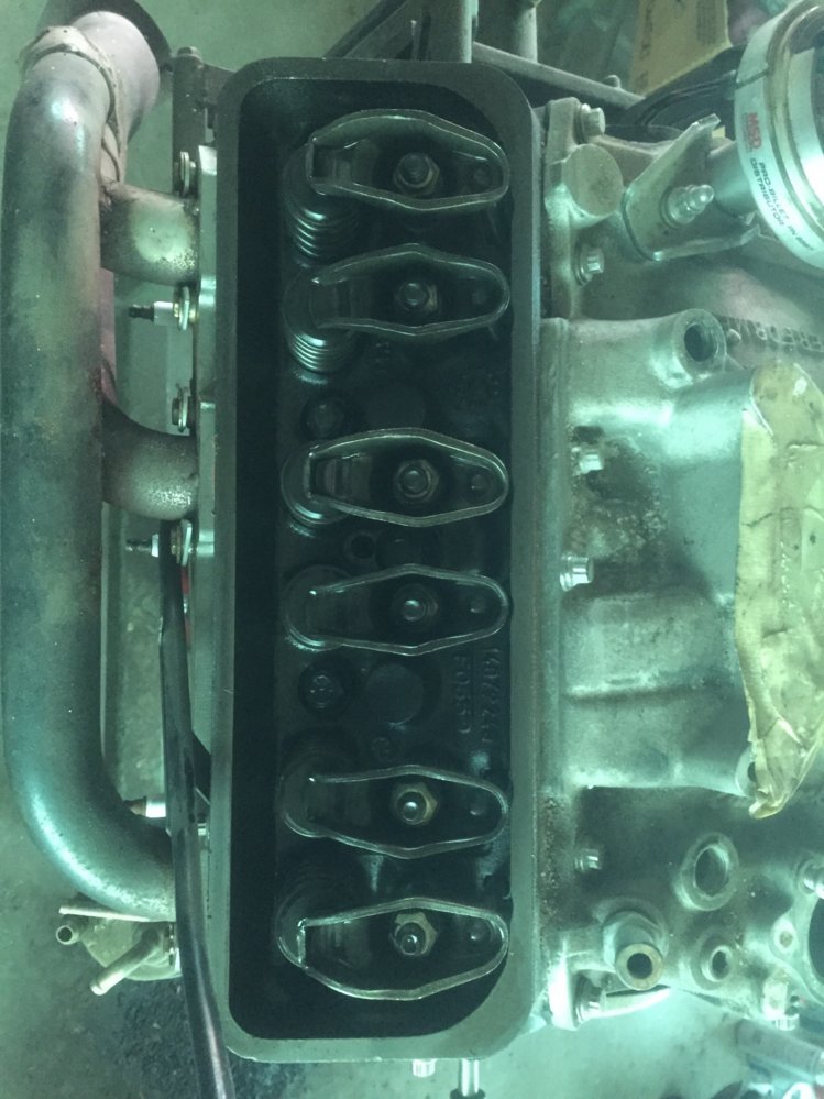

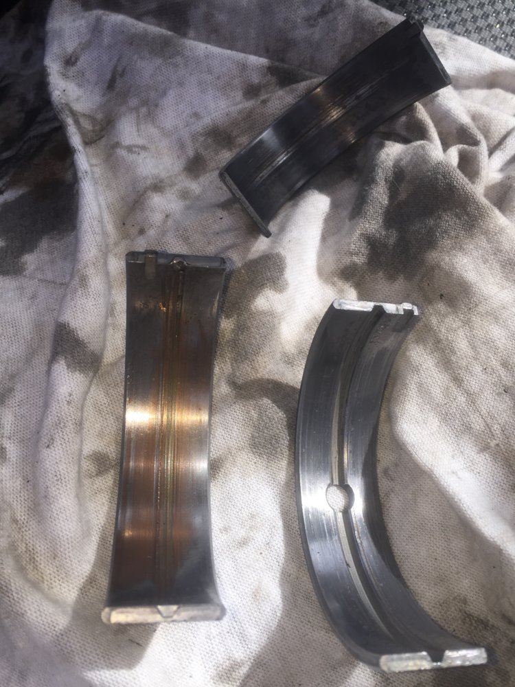

Today I decided that I wanted to pull the bottom end apart on the 4.3 and make sure it wasn't about to explode. Good thing I did. The guy I bought it from had never heard it run. He said the previous owner had told him it had a mild performance build and was ready to go. It had been sitting a couple of years before I got it, and has been sitting a couple since. My original plan was to rebuild an engine I already had, and really only got this because it had a carbuerated intake (for the propane conversion) and an MSD distributor. I think I will keep this one. It looks like someone spent quite a bit of time balancing the rotating assembly, but it still needs some work on the bottom end. Everything else seems to be in good shape and it has lots of compression (I've never seen one this clean under the valve cover).

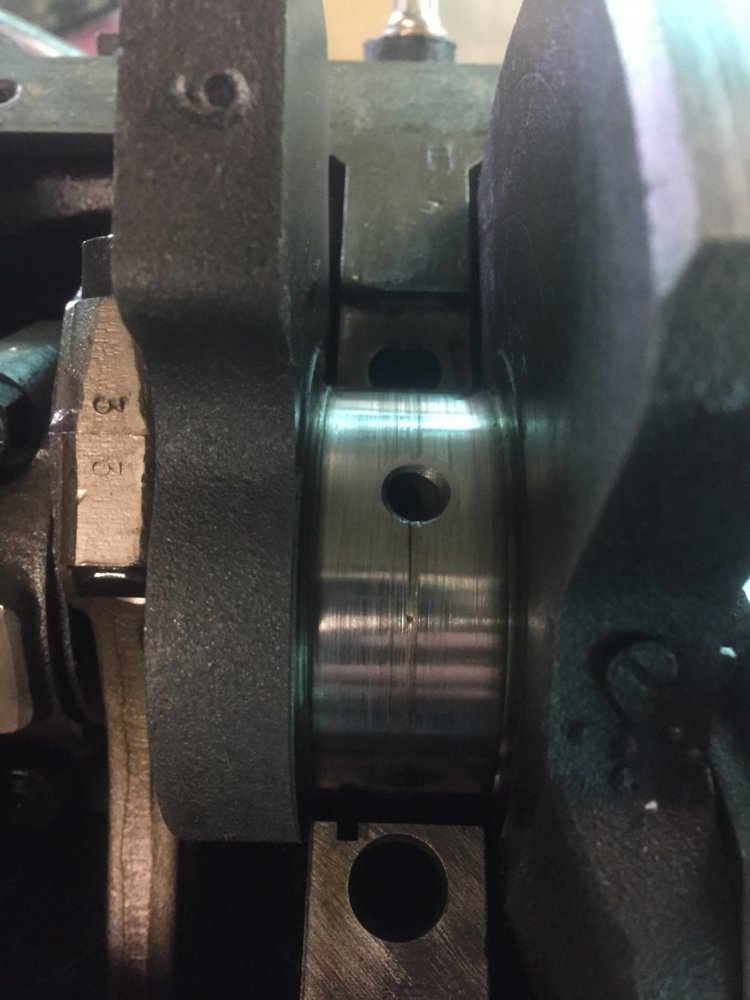

Gonna try to polish the crank rather than grind it, since it has previously been ground .020", according to what was stamped on it. And also because I have $0.00 left to pay a machine shop to do it.
I really hope I don't find anything else wrong, but am thinking that I may as well pull the cam out and check it while I'm in there. If I find more problems there, I'll just tear it completely apart and start from scratch. I should add that I have no idea what I am doing, but it didn't take long to figure out crank bearings aren't supposed to look like that. That's a rod bearing in the background, almost as bad as the crank but not quite.
