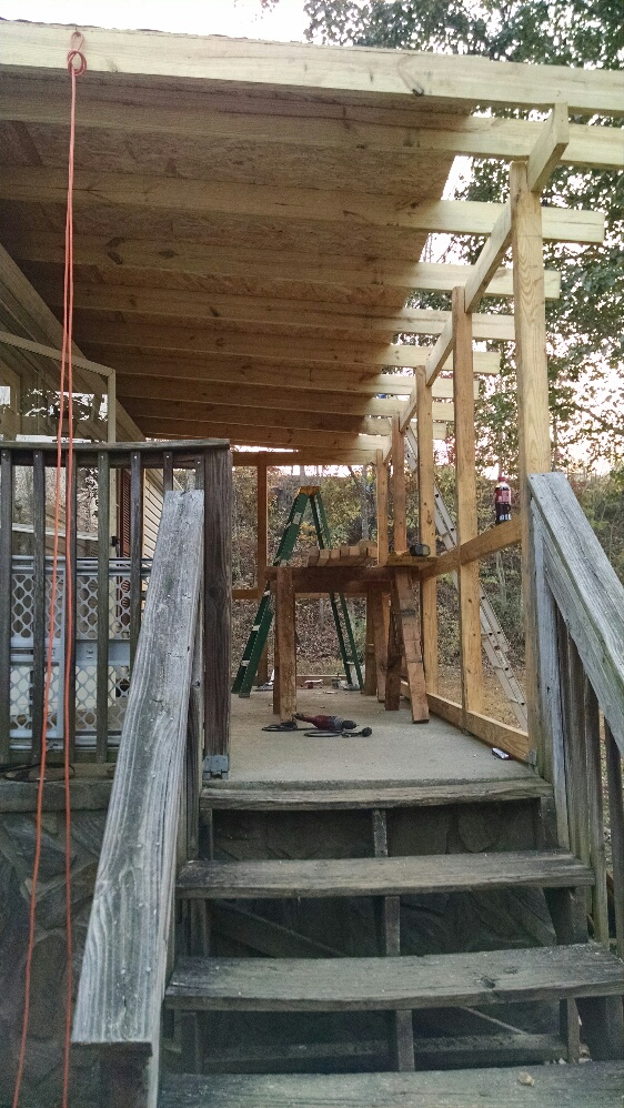

Poor picture due to lack of day light, but this is what I'm working with. I'd love to do a gable off the ridge, but that's not in the wallet.. friend suggested going off higher on the roof but still takes more material. Yeah, buy once, cry once.. just need to get like 3-5 years out of it to redo whole roof in tin. Tarring the tin to the asphalt is not out of the question.. was hoping there was more carpenters/roofers/home owners/mobile home installers with tips/experience.. i maybe counted the forum diversity card wider than it is. This isn't anything I'm going to point fingers and say well you said it would be OK., I'm doing it anyway just looking for tips or tricks. If you don't want your suggestion public, you can pm me or call or text me at 8286744O38. And I'm looking to finish it off by/on Monday, so rafters are going up Sunday, the handrails are what's on the saw horses. (I was a rough & finish carpenter years ago, so I'm just dusting off my tools.. been long enough I forgot why I like my pants legs to cover my boots!!)

Yeah, I didn't get to remove those rails on the porch yet, it is getting narrowed for a screen door in the future and it looks like a horses ass since it's all weathered and then the stairs will be too wide.. never ends d-:
lol I would have fixed them steps first!
I think some back woods nail bender put the stair stringers in backwards, they seem too steep/ wrong hand rail angle... Back porch stairs are the same way.. going to have to do a gable roof on the rear because it's 12' wide. Front was only 8'.
