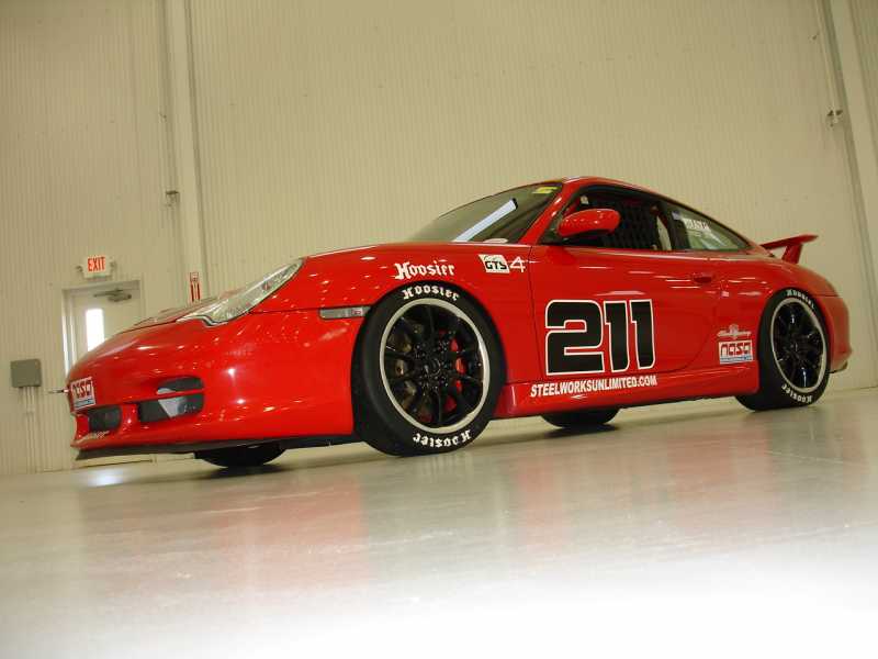

I know it's not a 4x4, but it was different to work on, people said I was losing what little off road credibility I have with it in my garage. Porsche GT3 that races in the NASA Series;

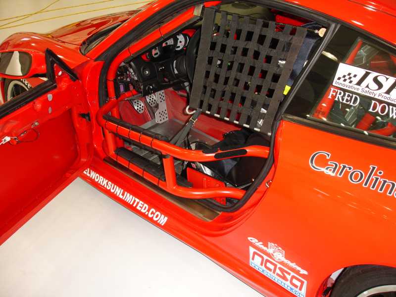

Cut the doors out, cut crash bars out, owner wanted the door bars as far out as possible. (Owner didn't like the idea off a car hitting him with them 2' away from his leg, plus rules state you have to be able to get out of the car within 10 seconds with the HANs on). All out of 1 3/4" .120 wall chrome moly. Got them a ty wraps width off of the outer skin.

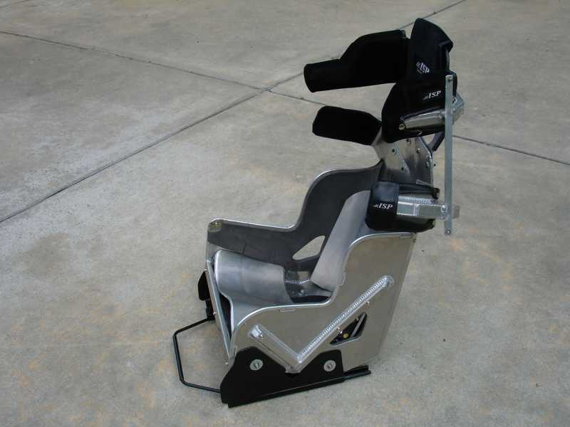

Made the seat cradle, cut floor pan out, lowered pan/seat in the car and made computer mount.
Nice work. So two feet wasn't enough room for the driver?:rolleyes:

It's not my car, I meant 2" of room prior, oops my bad. Owner did say he placed 1st & 2nd this past weekend in his races.
He said he hits around/above the 150's on the road Atlanta course and the road course at Charlotte motor speedway on the banked section? He said Vette's kill him on the starightaways, Porsches make up for it in braking and the turns.
