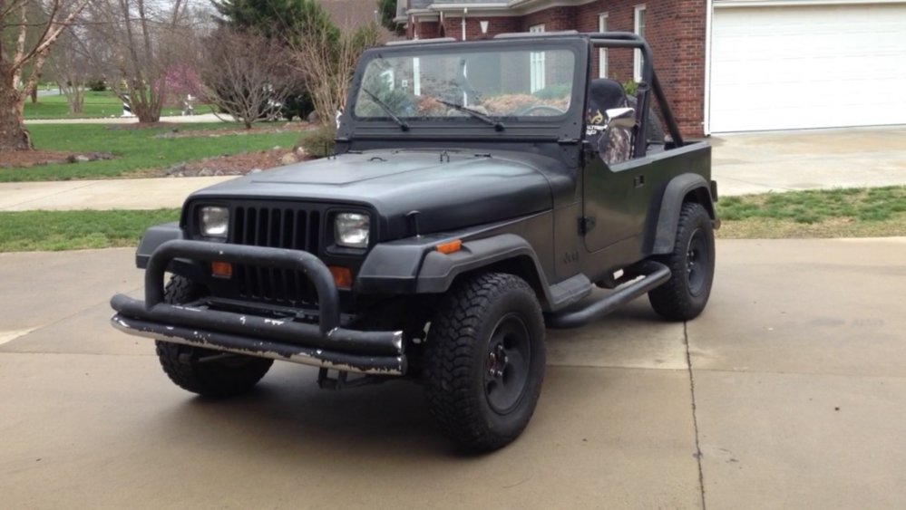

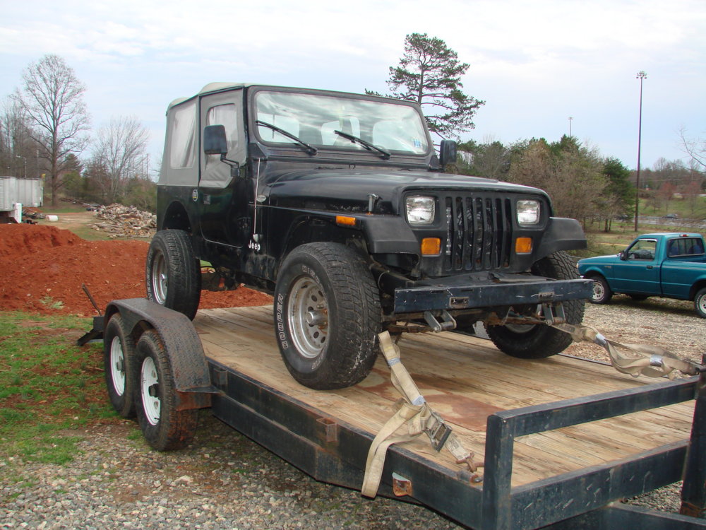

Here is my '88 rust free wrangler when I brought it home. I post these pics cause they are both 88 models and black.

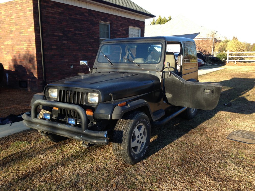

I'm thinking it needs a new transmission, the sound stops when the clutch is pressed but everything in the bellhousing is brand new, I figure beat up input shaft or something along those lines. I want a 5.3 but it'll take some time to put all that together. It runs a 2.5 right now, so it's no surprise the ax5 is junk. Mine was actually red with a subpar rattle can job on it. You can see the red where the black is chipping. My plan is white with a khaki soft top. As the interior was painted black too, I'll vinyl paint it tan or khaki. I've already picked up some rio grande seats that are all torn to shreds, but my passenger seat's frame was so rusted it had no support, so I wanted reclining. I plan to remove the covers and get some nice similar style fabric sewn in to the cloth parts, the leather and backing is still good. Right now I want to get a cheap ax5 so I can at least drive it while I gather drivetrain parts. The big goal is 3rd gen chevy v8, 1 tons, xj springs rear and wagoneer up front. We'll see how long it takes to get there.

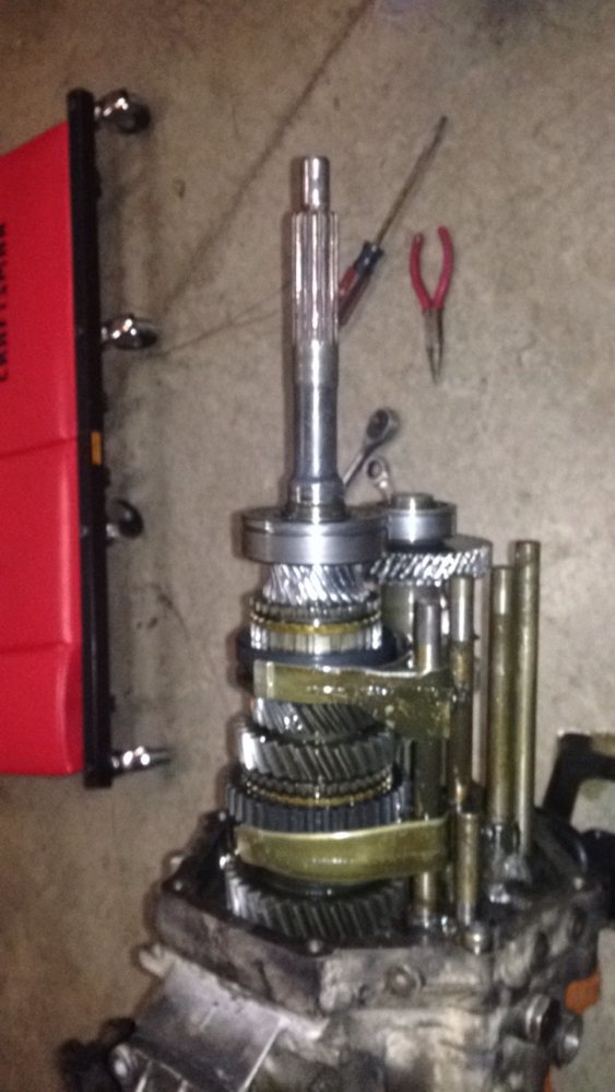

Alright, progress has begun. I pulled the tranny out and cracked it open.

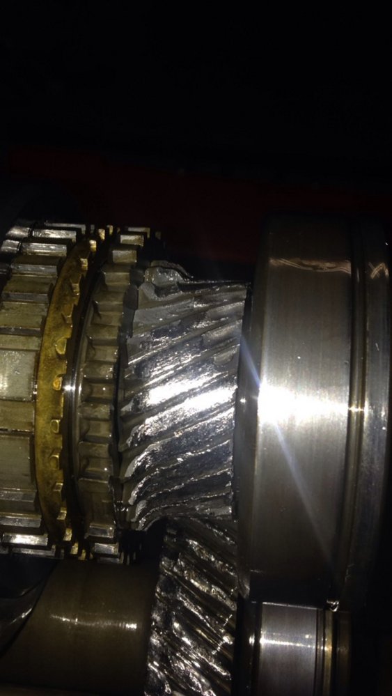

The input shaft is shaved down to nothing and it beat the cluster gear up a little bit too.

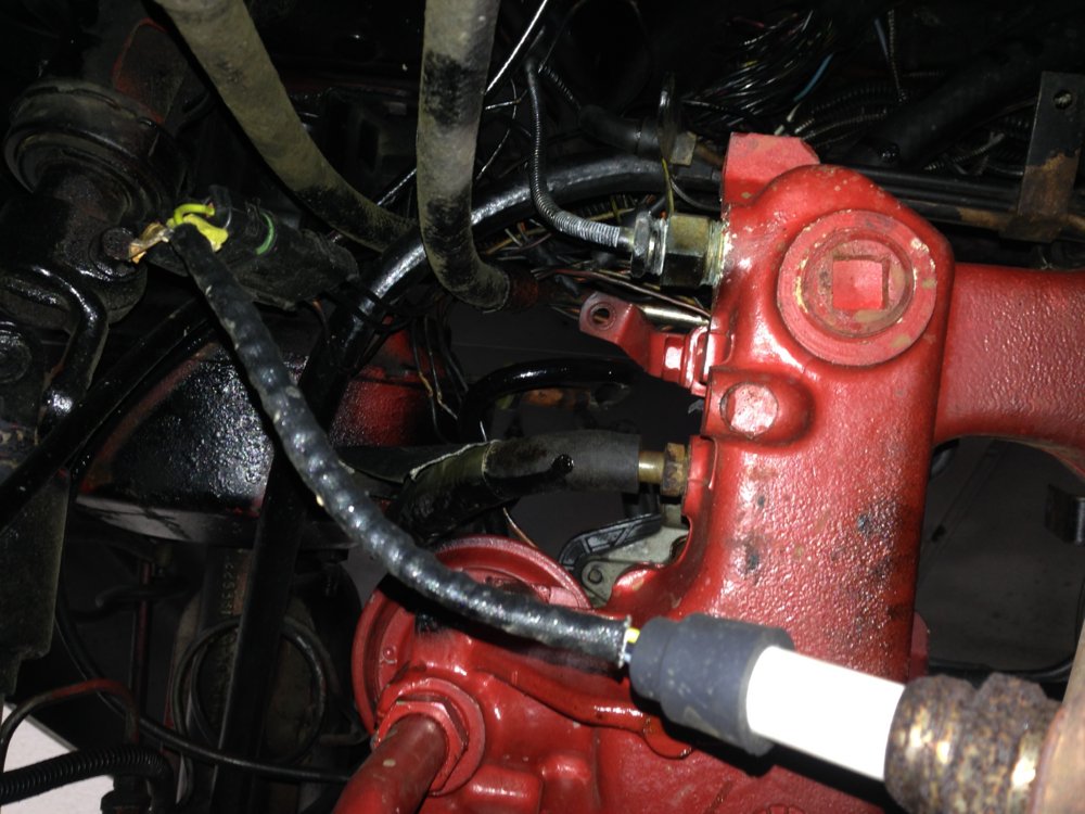

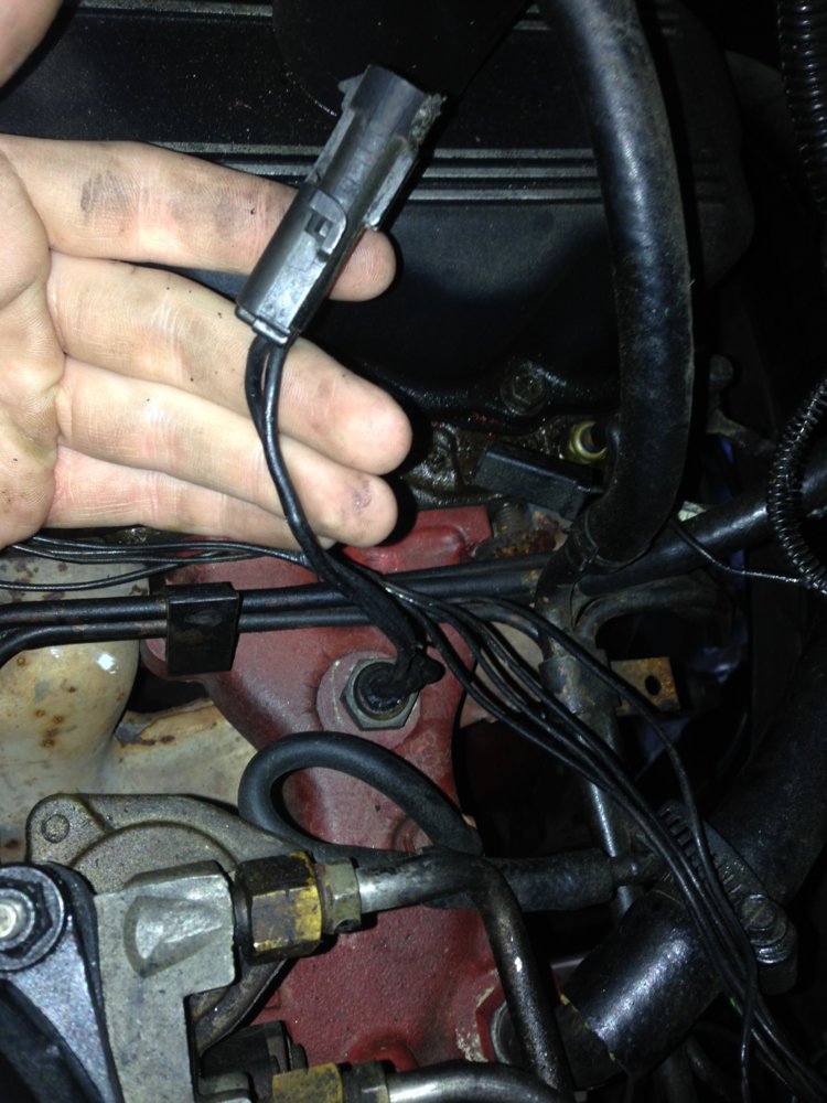

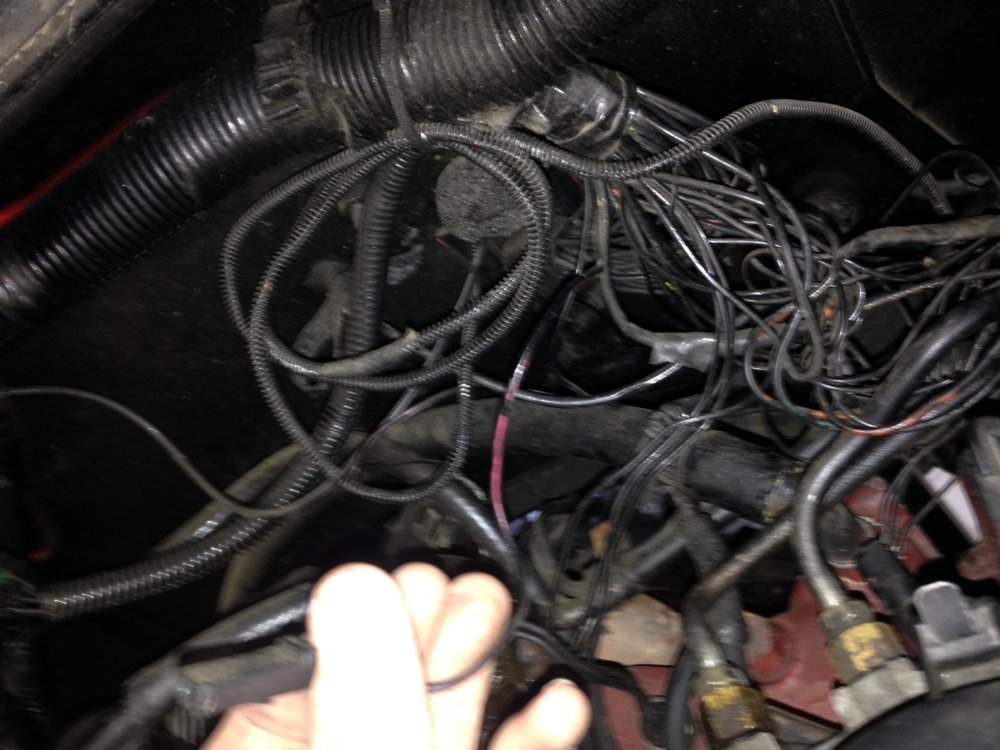

Both have been ordered and should be in by the weekend. I'll finally be able to drive it. On another note, I got a new coolant temp sensor to fix some startup problems I've been having. Well I found a whole other set of problems. What is this and why isn't it plugged in?
Look at how bad the gauge wiring is.
Is this supposed to run to a gauge because it looks like it's supposed to be where my new sensor goes?

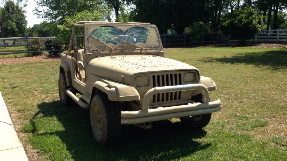

Took the Jeep out on some real trails and was really impressed with it. Got it stuck because of lack of ground clearance, which is to be expected right now. I need to cycle through the transmission hopefully one last time and get reverse working. I'll post some pictures tomorrow. You'll see, but I hate mud.
Just realize I never posted the picture. The mud sucked, but it wasn't supposed to happen that way, it's just what happens when a Grand Cherokee is over confident and gets stuck right beside the already stuck YJ. The inside looked the same. Since then, the transmission is perfect, took me long enough, but for a first time rebuild I'm really happy with it. She's a ton of fun to drive and now I'm cleaning her up more.
