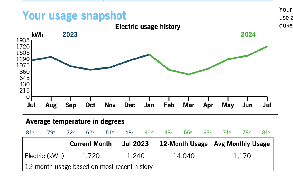

Seems that a lot of people I know are using a lot more power this year, and having pretty high bills. Duke data shows the average temps are about the same.
We are getting solar installed at the house (hopefully by end of September) since the ROI with a Duke rebate right now is around 5 years. Maybe it is just all my electronics :laughing:
I noticed the same thing on ours. 142KwH more this year in July than last year's billing cycle. Both show 80* avg temp. Variables would be me not working from home last July and I realized just the other day the timers on our Tstats had been reset from when we had the units serviced a few weeks ago so I was probably running AC more on the weekends when we aren't here.
Nothing has changed for us regarding when/what is consuming... BUT the "average temp"s aren't exactly accounting for the 2Q2024 90*+ temps we saw.
Bills (house & shop) are definitely up about 30%-ish

Edited to add: Our bill is way up, even when you account for the electric car usage. I have spent more days working from home compared to this time last year. My son is playing WAY more PlayStation. That’s probably it…the PlayStation.

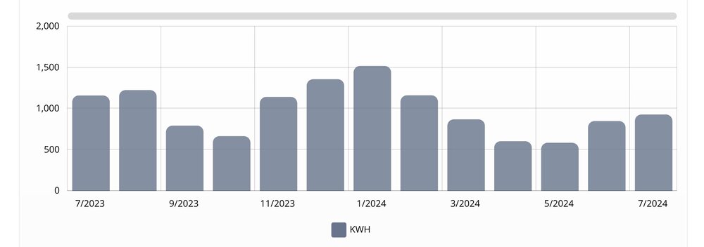

Got me curious, so went and looked at my usage. 3000sf, one level. Two reptilian humans in the house, we keep a/c set to 77.
Central Electric Membership Corporation Average rate 12c/kwh summer. Our highest bill is almost always for January usage, around $200.

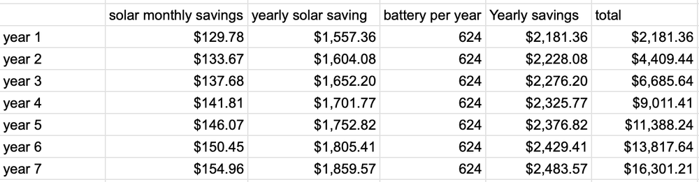

Also some places tried to tell me a 3 year roi and I showed them my math and they were like yeah that’s true I guess. They got crossed off the list
Can you share? I've been looking at DIY solar, but I don't like the ROI.
Take a look few posts up for my screen shot.
My math did 70% of power bill covered by solar (I average 180 a month), 3% yearly utility increase.
The ROI is hard unless there is additional rebates (although I am not sure what the install cost you would save would be). Let me know what else you might want for data.

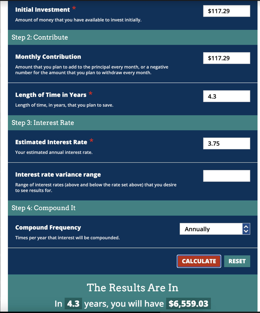

This is the BS one of them fed me (if you are financing you can't get 3.75% now, his math for the battery is 10 years, who knows if you will still live there in 10 years and he counts all that money up front instead of monthly, among other flaws in his math)
Initial Investment - $31,046
30% Federal Tax Credit - ($9,314)
Duke Rebate - ($9,000)
Battery Control Incentive - ($6,240) - ($52/mo over 10 years)
Net Investment $6,492
Your payback would be about 4.3 years not accounting for the increase in home value which is about 4%
