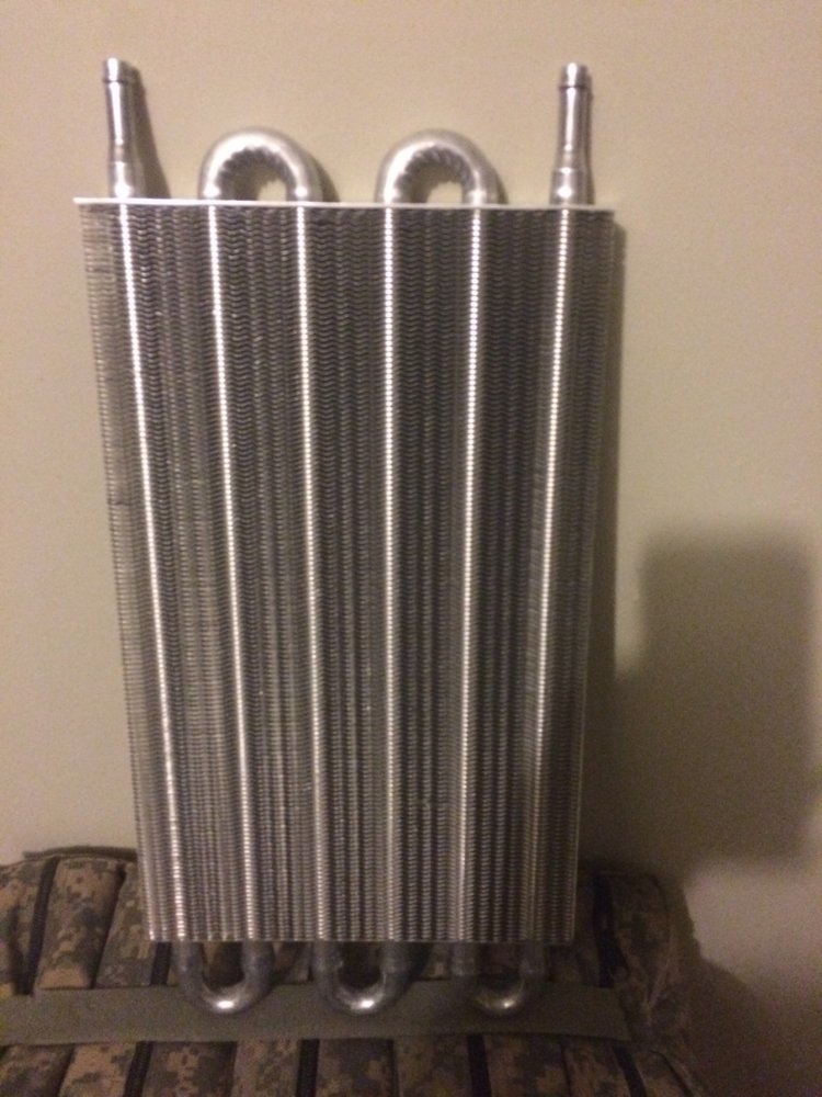

Well either way I'm done with the idea and bought another cooler that will remote mount out in front of the radiator. It is 10x14 with 6 passes through the fins. Along with aiding in cooling it will hold more fluid to assist in heat dissapation.

The larger cooler adds volume to the whole system that helps to keep overall temps lower.
