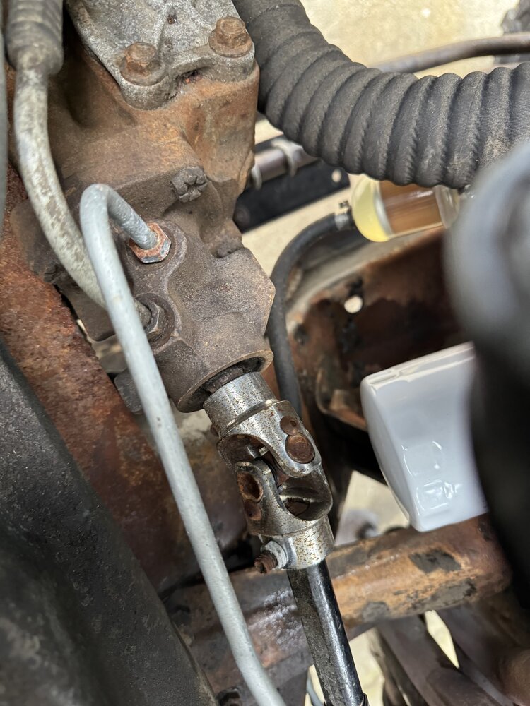

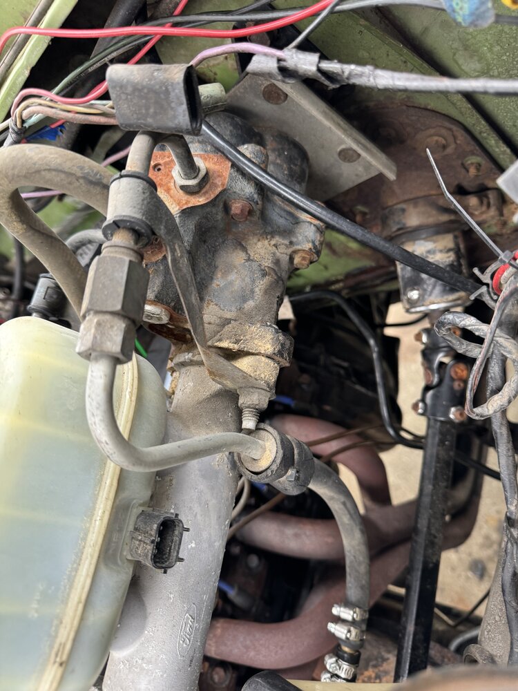

I have a 2004 or so super duty hydroboost and a 1999 super duty steering box on my f100. I need help figuring out how to make a custom pressure hose to come from the hydroboost unit to the steering gear. I had cobbled together a line with a barb fitting which worked for a short time but I need a permanent solution. Can I buy fittings to adapt the o ring and Teflon seal fittings to AN?

You will need to know what size you need. I used one like this on the XJ:
Ok thx. May have to go that way. I found an off the shelf hose that works (almost). The fitting at the booster end has too much thread so the teflon is not engaging. šŸ˜”
thread tape? Avoid any and all fittings using tape or dope in a hydraulic circuit. O-ring boss or tapered metal to metal.
Take the line that you have put together there to a legitimate hydraulic hose shop and tell them to make you one. For whatever reason, oems have decided that power steering fittings need to be a bunch of one off random bullshit and by the time you've bought and tried 6 different fittings you could have just had a much nicer hose with correct bends built.
I found a hose at Napa thatā€™s exactly what I needed. Weird how the same year and fitment has several slightly different hoses available! Iā€™m ordering a second for just in case. Thanks for your input gents
^this. Just had a situation with an old Mack dump truck at work that had a bad pressure line and Mack didnā€™t carry it anymore. Took it up to the Hyd Shop and they built it on the spot. Boom done. No fittings or hopes and dreams it was just done.
Secondeded
