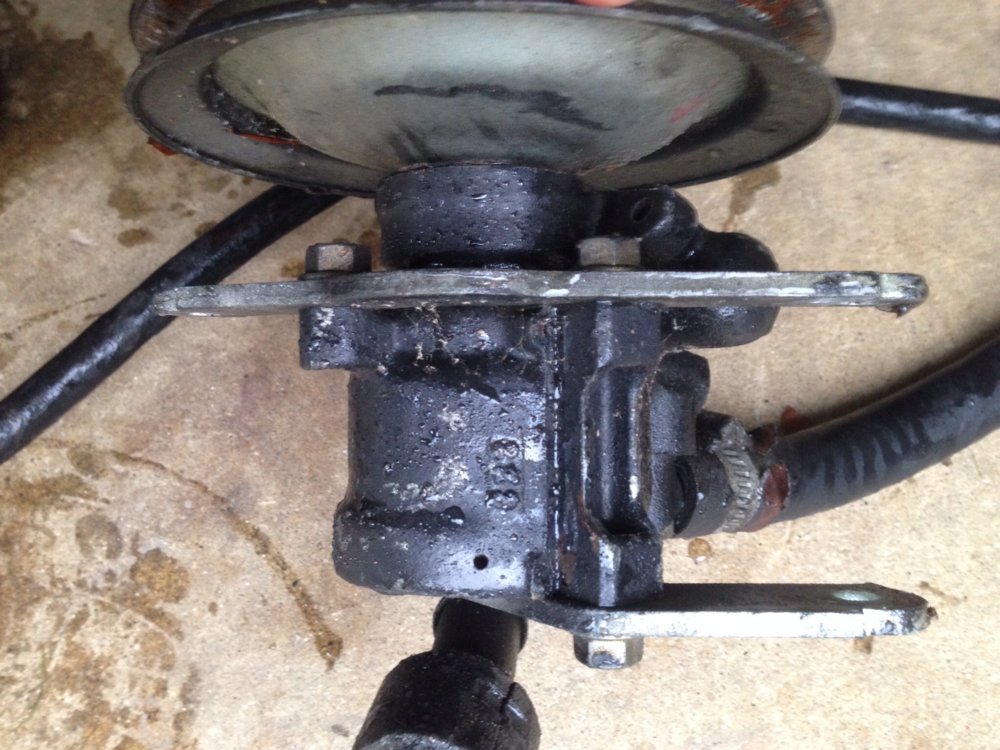

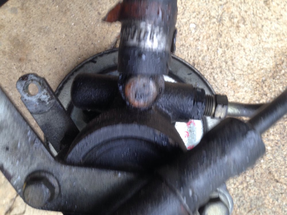

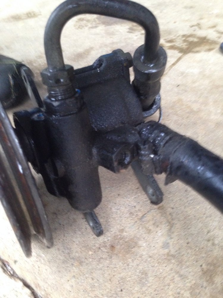

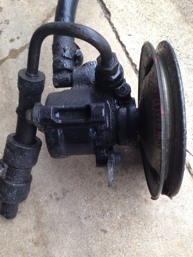

Here is the pump in question.
I've done a few hydro assists on toyotas using the stock toyota pump that performed fine. You can drill out the fitting a little bit to get a little more flow if you find you're over running the pump with the box. But sneak up on it. Don't drill too much or it's trash.
What ram did you run off the stock pump?
My Toyota is a FJ60 and they have a totally garbage pump. The mini truck pumps are significantly better, but if I have to reinvent the wheel to get steering back I was hoping to upgrade as much as I can (on the cheap).
Cool. Thanks Rodney. I will look into it. I can't seem to find much on the volvo pump but it is identical to a sunfire pump. The sunfire even had metric fittings. Off of a street rod parts place the stock sunfire pump flows 3-3.1 gpm. Still can't determine a projected psi or any concrete numbers for the volvo unit.
