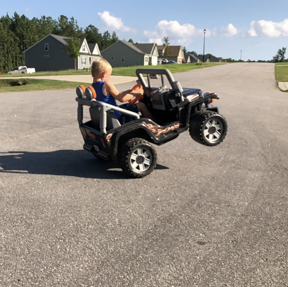

I used the highest amp hour sealed ups batteries I could find when my kids had the power wheels. Didn't take long before we started hooking them up in series for 24v power. These would generally last 1-1.5 hours so I had several sets that we would rotate through. My son would get bored with the stock stuff, but once he started shredding and drifting with the 24v's he'd run them 3+ hours. Hence the need for several sets of batts.
I used to order the gear boxes by the box too. 24v and bouncing around took it's toll. Told little man to stay in the throttle - none of this on and off start stop sillyness. He needs to commit and go for it. Which he did quite nicely.
The peg perego stuff held up pretty well for us. Specifically the John Deere Gator which is nice, wide and stable, and the large 4 wheeler that actually had some suspension did pretty well.
When he finally outgrew them there wasn't much left of any of them. But both the JD and the quad where junkyard finds that we scored for free. A new one should last you about 10 years before the plastic is too brittle. Keep em out of the sun best you can. It's a ton of fun to watch kids learn how to drift around the swing set, go mud bogging in their own dug out holes, start putting screws in the wheels for more traction and so on...
I did the 20v drill battery conversion to both of ours and my wife could drive it around. If you take a bike tire cut it in half and screw it to the back wheels they will do wheelies.
