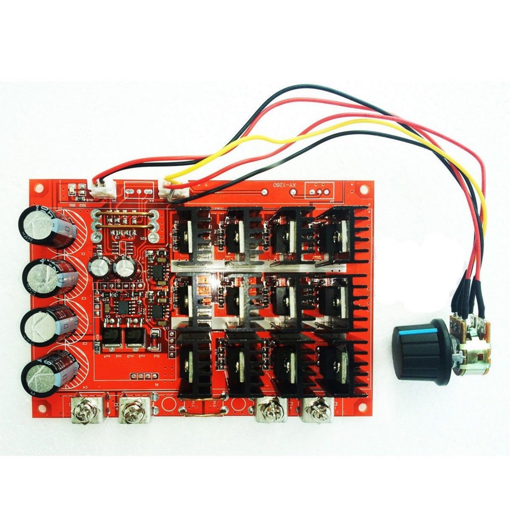

Any suggestions on a motor controller?
This one from amazon caught my eye.

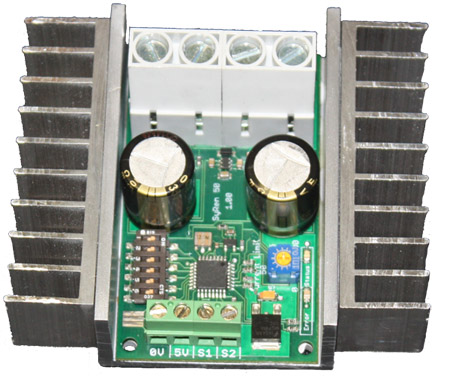

and this one from dynamic engineering
The one from dynamic is pretty badass will allow for all kinda of robotics and R/C
Any body with any knowledge of this stuff?
I am using the Sabertooth 2x60 in my mower and I love it. It was simple to wire up and has several options built in that are useful, however I am coming from using RC for control so your needs may be a little different. I also had some issues with the first drive that I got from dimension and they had no issue with honoring the warranty and let me use the credit from the warranty to go to a bigger drive. Overall they seem to be a good company with great customer service.

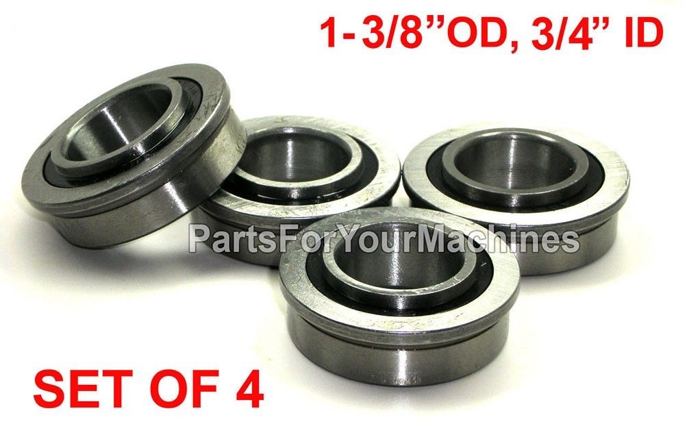

Been thinking about the rear axle. going to use 3/4" keyed rod. Want to use bearings on the mount. Would like to not use pillow blocks.
Was thinking about these from flea bay
With a 1-3/8"(1.375) OD they should fit in 1-1/4 pipe which has a ID of 1.380. Sounds like a viable option?
1-1/2" pipe maybe? And usually you would want a light press fit for the bearing outer race so it doesn't spin unless the ID protrudes enough to use spacers and get some preload on the flanges.
