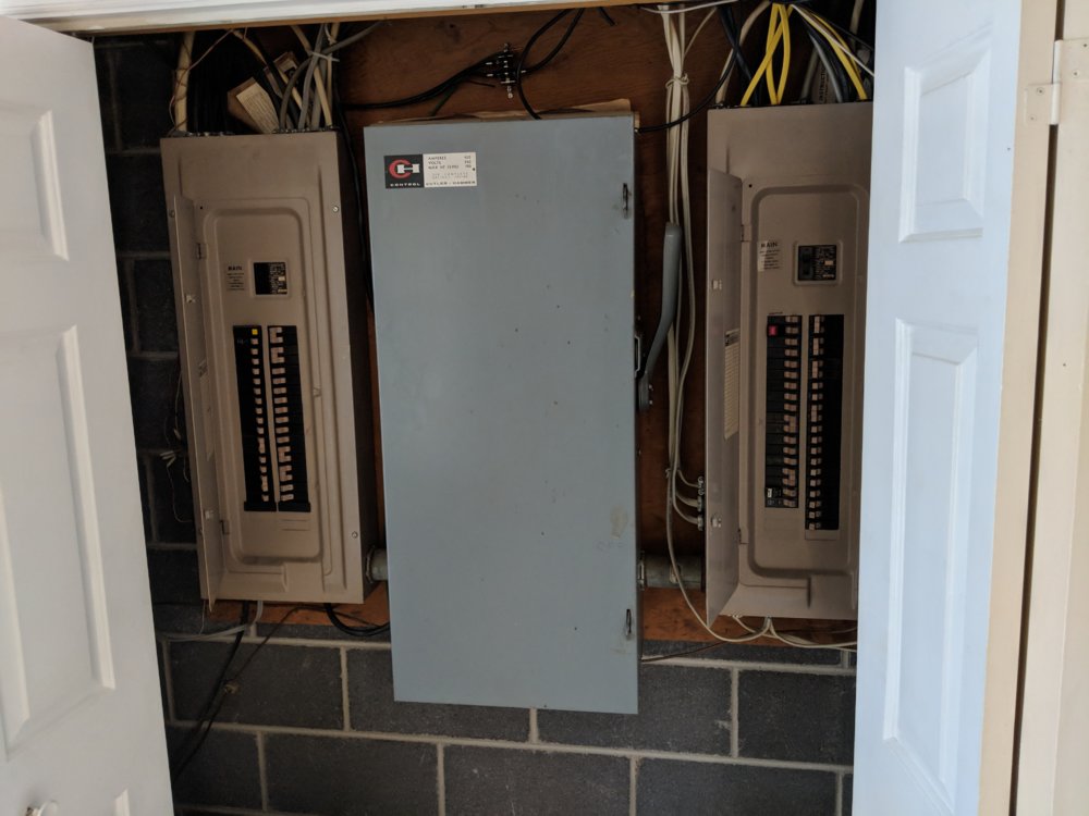

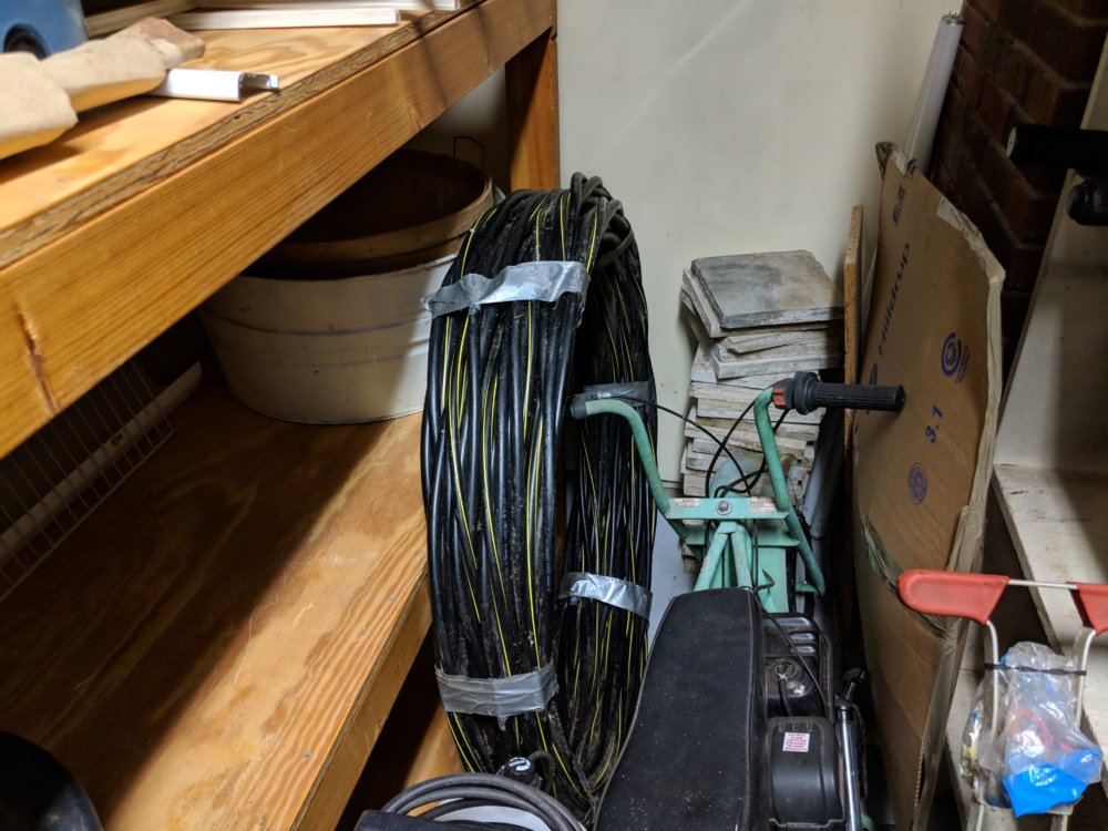

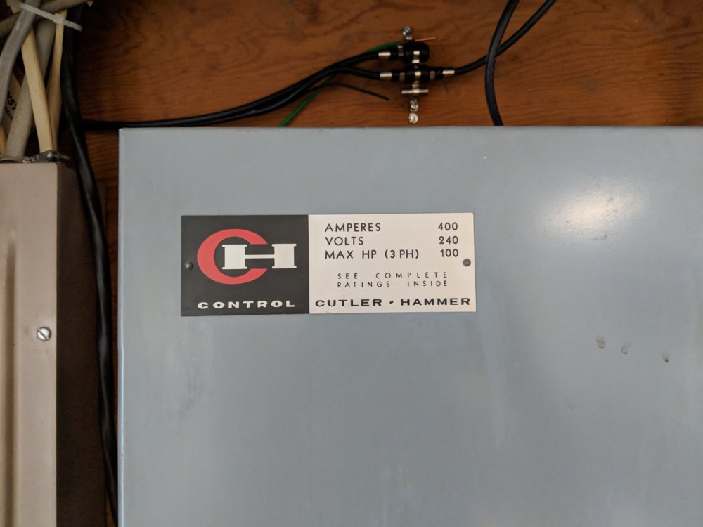

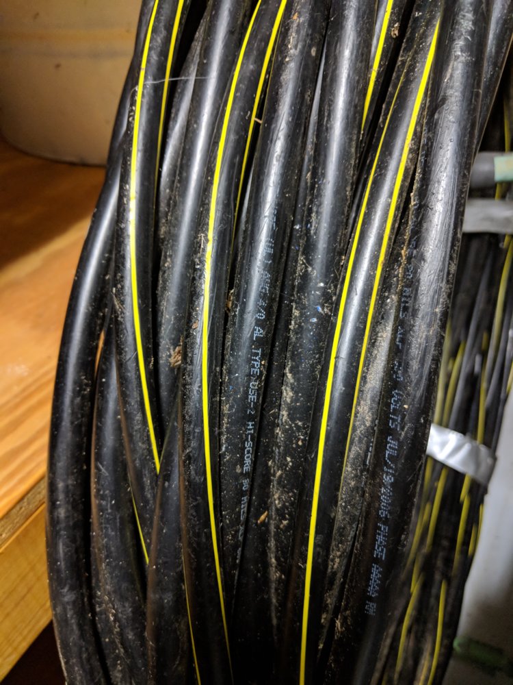

Kiss my ass. I didn't realize I was on kid duty today. He and I have been kicking around town picking up stuff for the new house. I'll take some pics in a minute. He just went down for his nap.

Assuming 90C breakers, it sounds like you're in honey badger territory.
I’m not an electrician but I know a little. I’d check with your utility as they may be helpful. My local utility would charge a monthly fee for a second service but it may be worth it. Not sure if there’d be any up front charge. Detached buildings are treated differently by code if you do feed it from your panel. I think the minimum rating is 60A and you’ll have to add a ground rod or two at the detached building. The neutral is then isolated rather than bonded to ground. Asking the inspector first usually helps clear up any misunderstandings. If you direct bury the cable it needs to be 24” deep. If in pipe it’s 18”. Even if you direct bury the cable you have I’d consider running conduit while you have the ground open—it helps the next guy if the wire ever fails. Oh, and don’t forget to call 811 before you dig to get underground utilities located.
If you’re pulling 4/0 you’d probably have to go a larger breaker to be able to fit the wire. Don’t forget to use oxidation inhibitor for aluminum conductors (“No-Ox”). I can’t tell from the picture, but you’ll need four conductors (two hots, neutral and ground) to the detached building whereas service wire may only have three wires. I think you are required to mark them too. My advice is do as much homework as you can, form a plan, then run the plan by the inspector before doing anything. Codes are there for a reason but nothing a handy homeowner can’t do.
