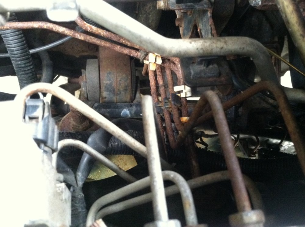

I had a brake line blow out on my Ram as I pulled into the Northern Tool parking lot last Saturday morning. It is one of the metal lines off the MC. There are seven lines in this tight small area. Five of them are rusty and should be replaced. I found a kit on Ebay for every metal brake line on the truck, but I don't need every line. I really don't feel like trying to bend all of these short lines in this tight area. Where have you guys bought your pre bent metal brake lines?

Those things are crusty... Interesting mix of corroded and non-corroded in the same area, obviously have different surface treatments.
