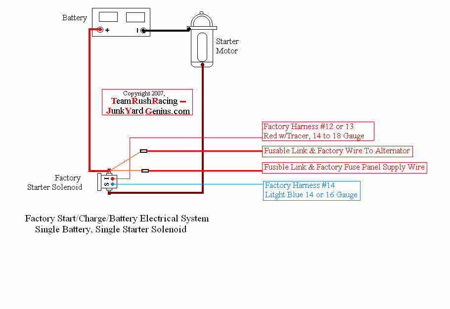

And for a jeep like, dropping in a battery to test fire is breeze! Connections needed:
- Battery = ground (to frame/block/body) & positive to starter solenoid
- Coil = short-term connect positive post to battery+ with test lead (wire with alligator clips)... longterm, the older coils only get a full 12V during cranking and 8-9V in "run" position via ballast resistor, so too much 12V will let the smoke out of the coil. Connect the coil, try to test for spark at plugs/start and disconnect anytime you're not actively testing!
- Starter solenoid = Battery+ should connect to larger lug on one side, starter lead to the opposite large lug; To energize the solenoid, use another test lead from battery+ to the small lug marked "S", touching the "S" terminal to activate the starter, removing the jumper to stop it from cranking. Also, be CAREFUL with the loose end of both test leads when connected to battery+! if the touch anything grounded, the smoke comes out!.
I've started DOZENS of jeeps like this, completely bypassing ALL the existing wiring & ignition circuitry/switch all together.
BEFORE YOU BEGIN, INSURE IT'S IN NEUTRAL AND CHOCKED! IT WILL STILL ROLL/MOVE IF THE PRESSURE PLATE IS RUSTED TO THE FLYWHEEL! (which can make for interesting situations) :eek:
You should be able to crank the motor with a set of jumper cables (and a jumper wire if you want it to run). The CJs use a starter with a separate solenoid. You should be able to ground the negative cable to a bracket on the motor and touch the hot to the starter lug and it should crank. This does leave you laying in a dangerous position should the vehicle not be in neutral or slip into gear or something crazy like that. Make sure its in neutral and hook the positive cable to the cable that runs from the starter to the solenoid and it should do the same thing (I doubt they cut the heavy starter cables). If it cranks and you want to see if it will run, then run a jumper wire from the starter cable to the ign terminal on the solenoid. Short the 2 small terminals together with a metal tool and it should engage the starter and provide power to the ignition (if the ignition is the original 74 delco points type). If its the newer type of ignition you can't bypass it (unless it has an HEI swap).
