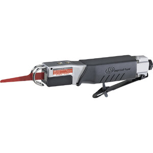

I've needed a precise reciprocating saw on several occasions and usually it's in tight places I have an air recip saw and it's hard to manage and isn't really a good saw. I've looked at Milwaukee and haven't see anything yet. What do y'all use for this?
What do you mean by precision? A short blade? Makes a super fine, thin cut?
A sawzall can really butcher things sometimes and is too big to put in tight places. The air saw I posted is the idea but it sucks. I was just wondering if there's something else that will work that's a bit more refined.

Short answer. Ingersoll air saws have worked or held up as good as any I've used. Tool truck units and these are very comparable. I have no experince with Horrible Freight or the like with these.
