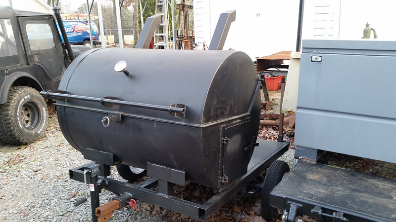

Even easier....buy my already-built cooker. Hot pig this weekend!!
$950 if sold before I have to move it to the new place this fall. Just needs to go!
But, this isn't a for sale thread....if anyone is interested, PM me!
