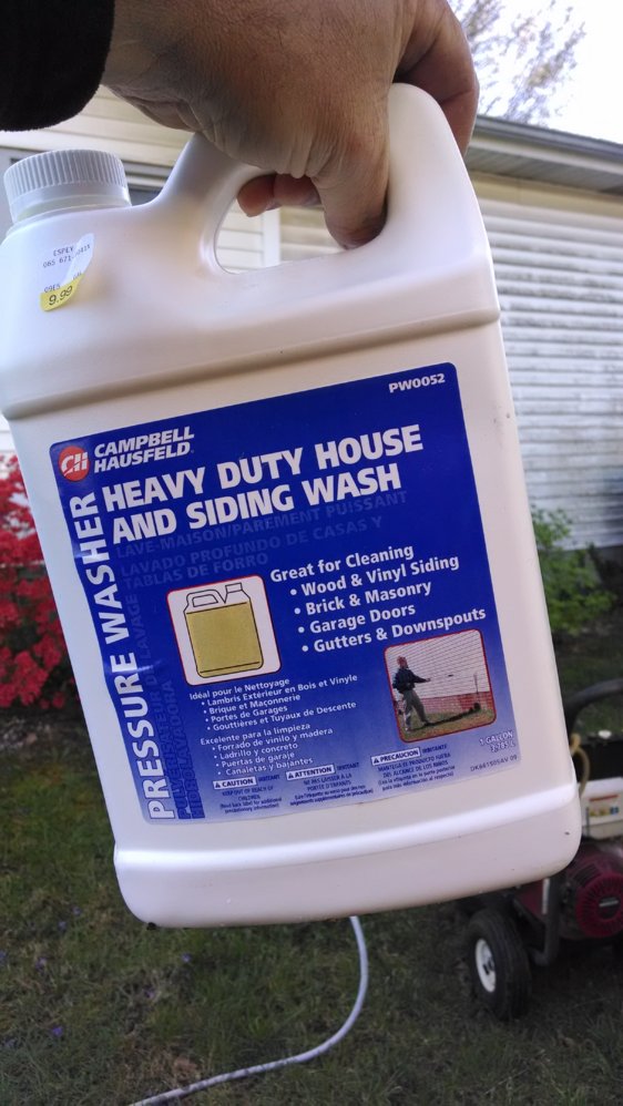

I used this stuff to do a whole hose yesterday. It worked pretty good. $10 gallon. Took me about two gallons to do a 1500 sq ft house.
