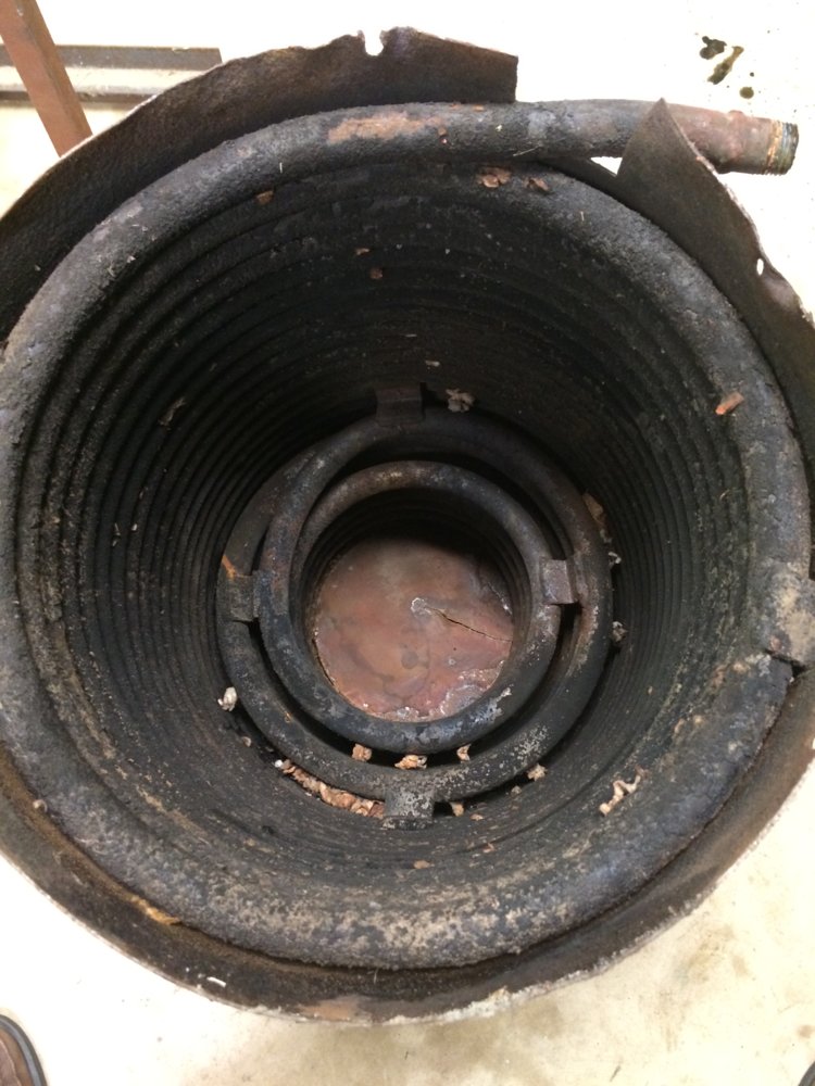

The heating element is a large canister that sits over the flame. It has 3/4" copper or steel pipe coiled inside. It is very heavy. But, there is a clog some where in the coil. How to i find it and clean it?

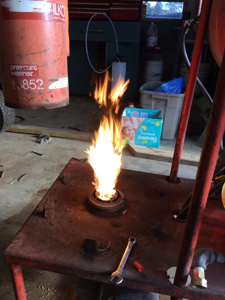

Why do you think there is a clog? Sorry I missed that part! What model burner is it? Two I run are landa

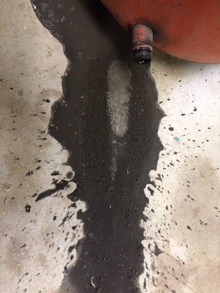

Inside of tank. I ran a clothes hanger into the inlet as far as it would go. This seemed to loosen up something. After putting some compressed air on it. There was a bunch of black nasty liquid that came out. Where it wasn't flowing at all before.
The coil is not copper. Its very magnetic. So I'm going with steel. That's really a secondary issue to the pump not putting out pressure.

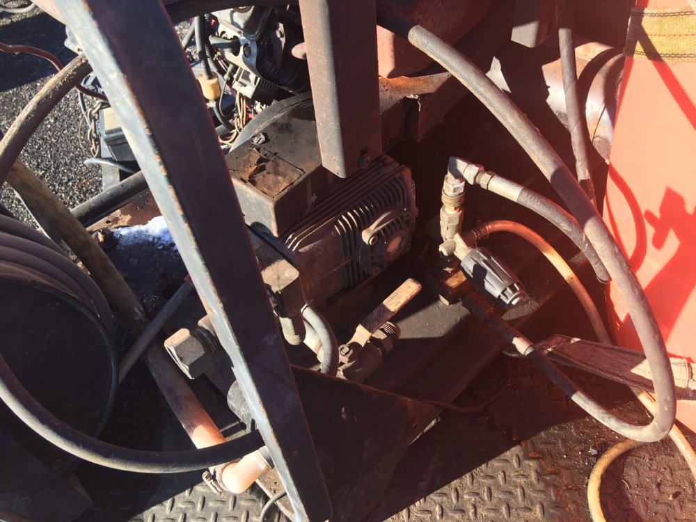

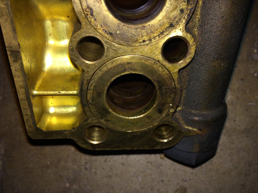

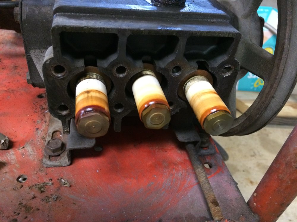

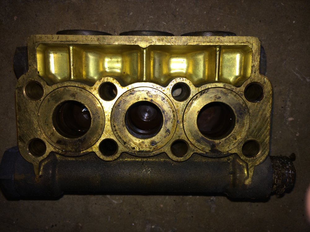

No problem in the pic of your pump the washers that I think are causing your issue are behind the circles in the head their a pita to get out be careful not to damage the housing it'll cost you a head I been there! Envirospec.com is where I get all my comet and general pump rebuild stuff I've also ordered just washers off of eBay I believe for the t9961 general there 30$ but that's not o rings and cylinder sleeves!! the black stuff doesn't seem like it'll cause you a issue if you can get pressure to clean it on out, your burner has good flame also so your good there the coil may need replaced mine is over 12 years old and it has some black stuff in it when I start back up after winter but usually doesn't affect pressure! Are you running a unloader to a tank?

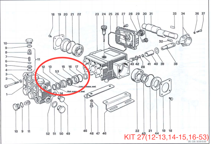

This is what I found for the T9961. It looks like part #17 is the round circle as seen in the above pictures. How does it come out?
That kit isn't cheap looks like it's 27.42 per cylinder from envriospec.
Should I replace the O-Rings as well (#9, #4)?

On the pic of the video you can see the round piece in his right hand that's where the trouble washers are the others you just unbolt the ceramic rods but those shouldn't be your issue only ones I ever have to replace is #17 & 16 the o rings #9 & 4 if not ripped should be fine!
This is the unloader I run with bypass it allows load to be taken off the rig while not pulling trigger. I use channel locks to get round piece out of head that's where the washers are! Hope this helps!

This is my oldest machine but it shows ya how I have unloader setup the tank is to the right in pic pressure relief valve and bypass all one part of this unloader
Took the pump head completely apart. Rust and tarnish on the inside. The tubes feeding the pump are pipe. They are all very rusty.
I'm not sure I'm thinking right on unloader vs bypass.
Took the packing out. Visable damage on the seals. Will need to order some more.
