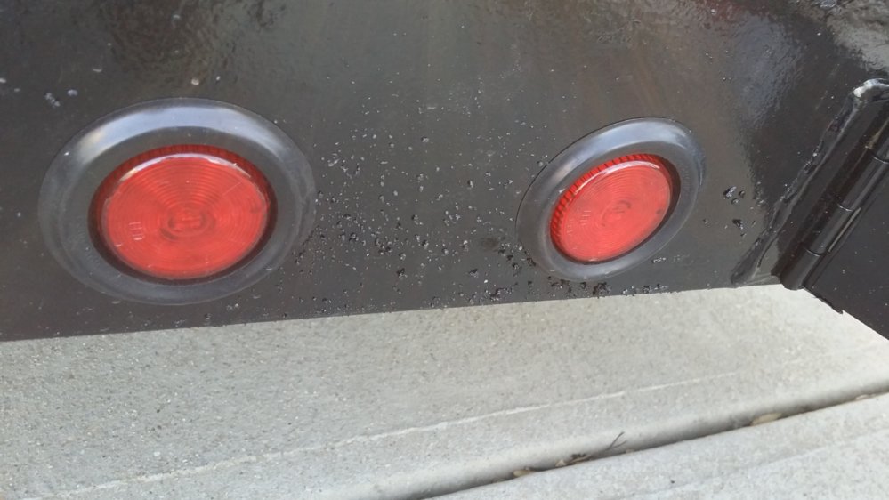

I know a lot of people on the forum have a kaufman trailer and are happy with it, but I believe Kaufman may have made some changes to the way they build their trailers and also treat their customers. My brother was in the market for a new trailer to haul our rzrs on and received quotes from Kraftsman and Kaufman. Kaufman got the business due to the fact that Kraftsman had a 4-6 week delivery time and Kaufman was 1 week. Up to that point we had heard good things about both companies. Well when my brother got his trailer home he noticed some additional issues that he had missed while going over the trailer at Kaufman. Here are the emails and his conversations with kaufman regarding the issues.
1st email to saleman:
There are alot of paint issues, including the back were they didn't even clean the metal pieces off after they cut the holes for the back center lights. Just painted right over the pieces. I'm sure there was cutting oil used and if the metal pieces were never cleaned then I can only assume the cutting oil is under the paint and primer as well. This may not show today but will certainly show at some point. Please forward these to tim as he has left me a message earlier.
Thanks in advance for you help in getting these issues resolved.
Johnny jackson
Salesman called him back and told him they would take care of any issues and he could take the trailer to a local shop for the repairs. After that call he received another call from the customer service guy. This is a recap of that conversation.
After talking with my sales person from Kaufman yesterday and him assuring me that they would handle the cost to make these issues right I was told that someone from Kaufman would be calling me back to talk with me about taking care of the issues I'm having with my brand new up-graded diamond deluxe car trailer. I received a call from a Tim Johnson and he let me know he had reviewed the attached pictures and that his position was that this is what Kaufman Trailers delivers to its customers and that he didn't see anything that would justify a warranty claim or them to pay for any repairs. right down to letting me know that there is really know way to produce a car quality finish with the dust and dark spraying environment they are working with (yes he told me that the spray both was dark) Mr. Johnson also pointed out that if I compared his pricing with others that I would find that even with the issues I have pointed out with this trailer that I still received a great value. As a side note I could have gotten a custom trailer from Kraftsman with the 16" cross-member centers in-lo of 24", 4400lb dexter axels in-lo of 4000lb easy lube axels, lifetime warranty on welds in-lo of one year, one year warranty on paint in-lo of no warranty, at a cost of $70.00 less than the Kaufman Trailer. If I had it to do over I would have waited the 4 weeks and went with the Kraftsman trailer.
The pics of the upgraded sealed harness and automotive paint are attached.

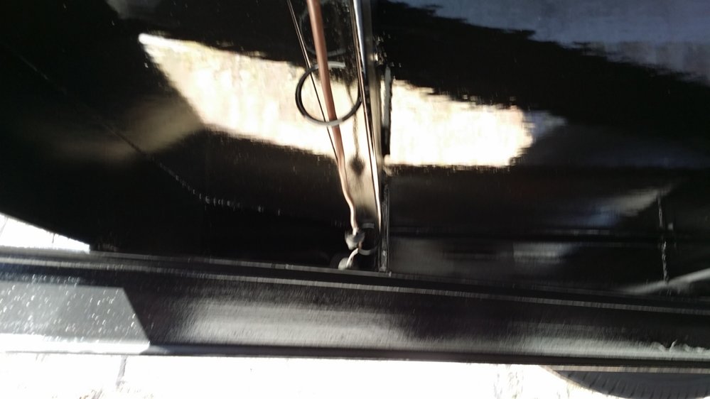

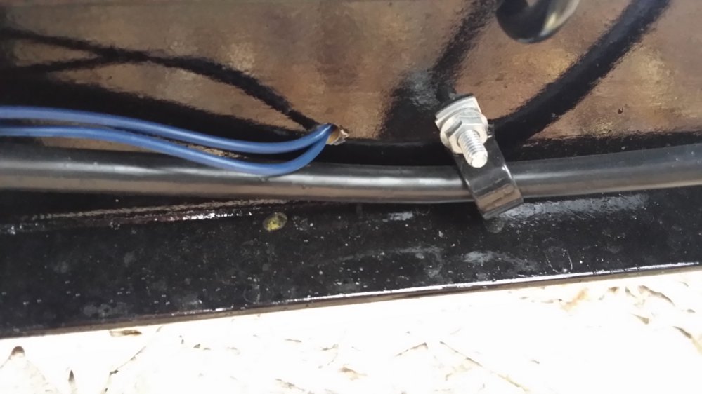

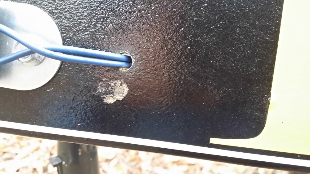

I like how the holes for the wiring don't have any kind of grommet or protection from rubbing. I know for cheap stuff you'd expect that, but you can predict where you'll be replacing wires in 5 years.

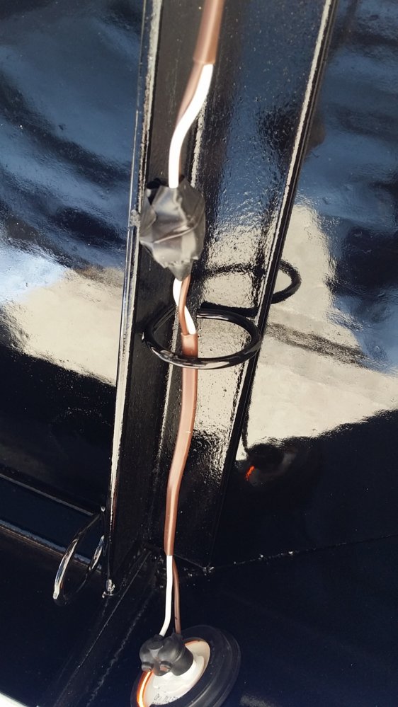

Since this is what they call an upgraded sealed harness I would hate to see the standard one. Also if that was as good a paint job as my painter could do I think I would find another one. It's not hard to clean the damm thing before you paint it. I think that's painting 101 lol. Or how about the weather proof connectors that they didn't use a heat gun on, they should do their job well.

IMHO, the paint is a non-issue to me. Its a trailer not a show car. The paints job is to keep it from rusting. I literally wouldnt waste a second of thought on the paint issue. The wiring on the other hand, is piss poor. But is also better than average for a trailer in my experience. My dad just bought a custom equipment trailer to haul our tractors on. I went with him to his supplier of choice to "spec it out" because he says "I know about these kinds of things"...the guy taking the order was confused when I asked for the lights to be mounted but no wiring done on the trailer. He explaind the lights wouldnt work to even take it hom without wiring. I said we'd bring "tow car" magnet lights to get it home if necessary.

put a little silicone in the wiring holes to keep them still from rubbing & use your trailer..
