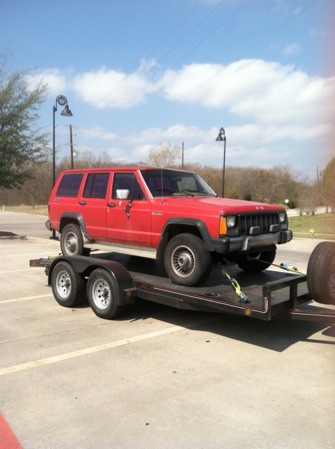

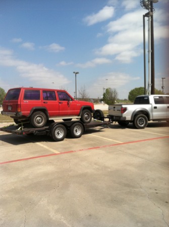

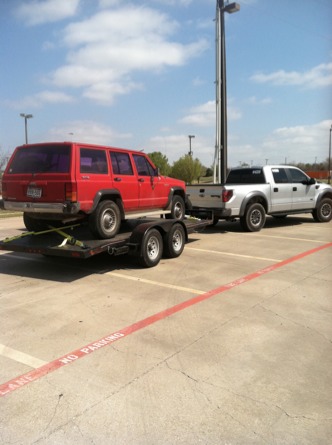

Started with a quick Craigslist search, 1 phone call, hooked up to the trailer and $900 later...

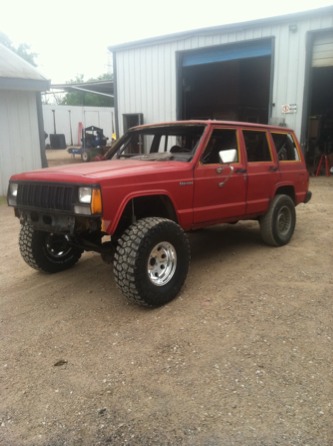

1988 Cherokee with 244k on the clock. Purchased on 3/17/2011

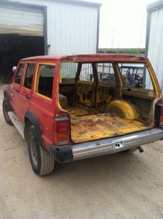

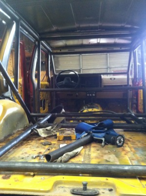

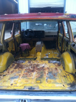

Interior was stripped and the original color showed it's face.

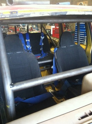

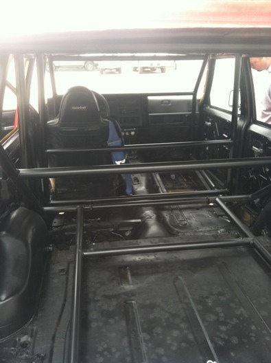

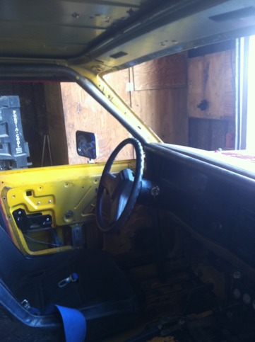

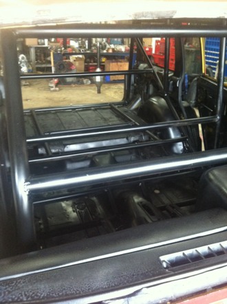

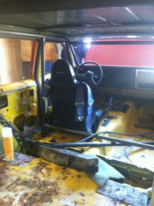

1st up was safety. I started bending tube and laying out a design as I go cage in 1.5" x .120 wall DOM
Recycled some seats and harnesses from a rig I just tore down
Ready to burn in
Several feet of .030 and a case of rattle can later

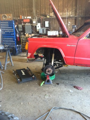

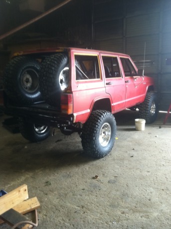

Now it's on to the outside. 4" lift going in
Desert stance

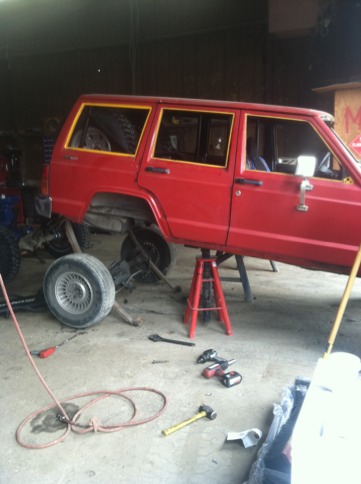

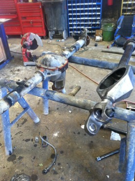

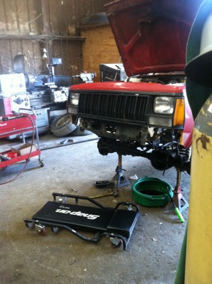

Out with the D35
8.8 ready to go in
Quick shot on all 4s

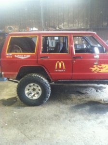

Sponsorship idea lol, but I think you have to have big rims to get sponsored like that.
looks badass though, wish I had your tube skills, would throw a ecors racer together, just worry I would roll it and hurt myself after seeing a few races.
This sponsorship idea has already been branded...

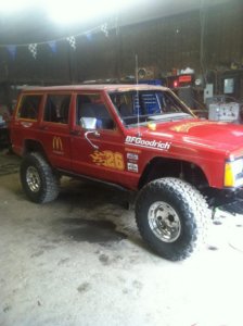

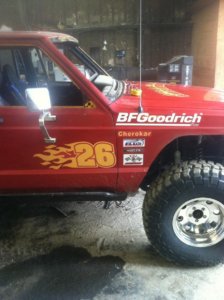

And we have a racer ready to rock

Looks wicked, yall gonna be running this one in auburn?

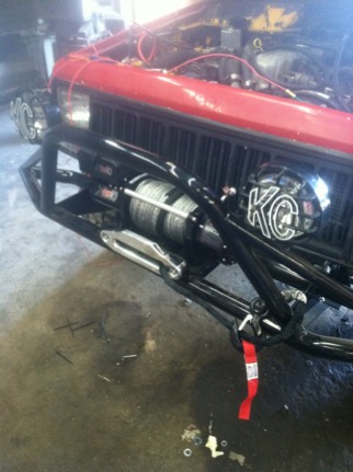

I might have this covered with all the steel attached to the unibody rails. If not, I'll build a tube "chassis" kinda like a Yota I've seen around. I almost bent 1.75" x .188 wall tube to run the entire length but said screw it, I'll fix it if I wad it up.
Race prepped, cleaned up and after a quick upper control arm swap and front axle alignment it will be ready to roll in the trailer.
