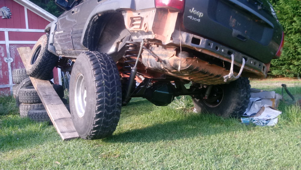

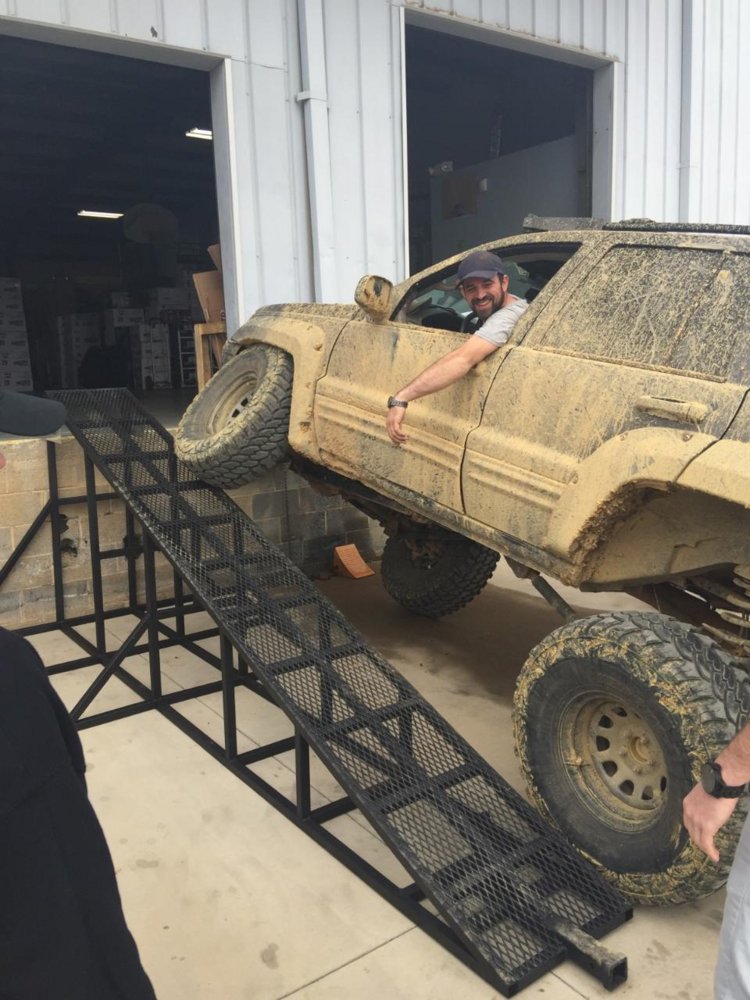

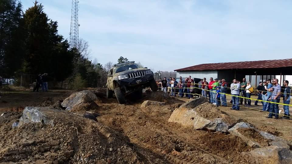

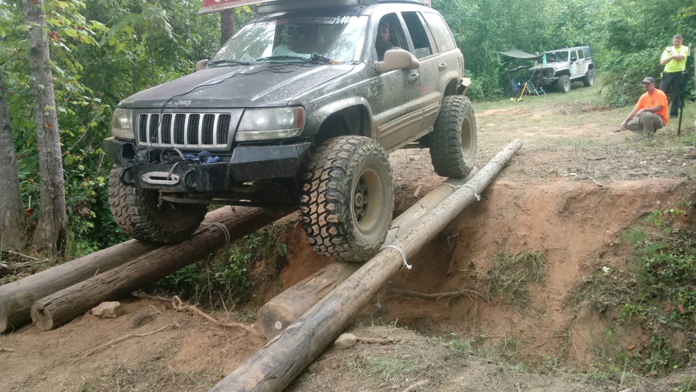

Here's a couple pictures from the past weekend on the RTI ramp and obstacle course at the Santa's for Soldiers event in Mooresville yesterday.

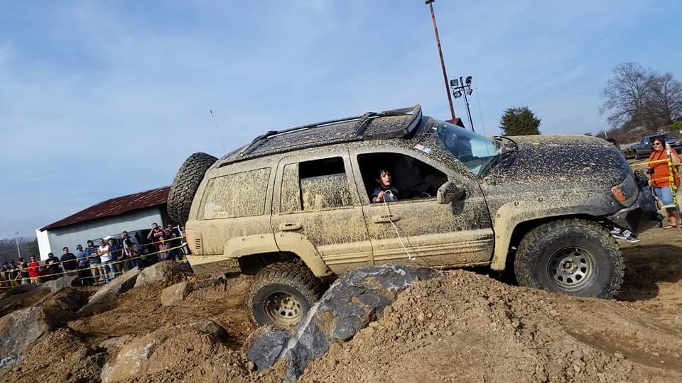

And a couple from URE the other weekend

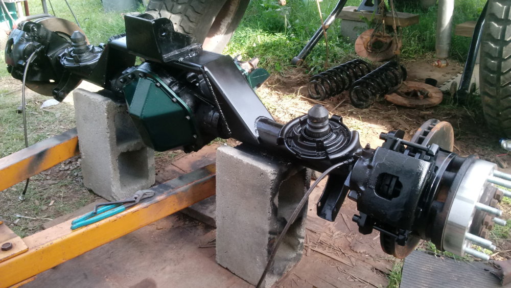

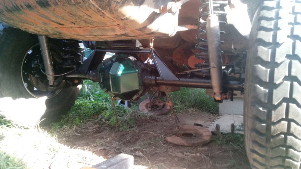

So i decided to go a different route on axles. I sold the 44HP and 9", and started to build a 14 bolt i had.

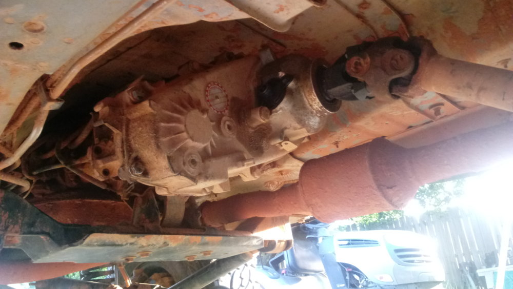

@Barnes 4wd supplied truss, pinion guard, shave cover and disc brake brackets, autozone rotors and calipers (diamond level pricing helps) @ecgs supplied 5.13s and install kit, np231 w/ sye installed, used my front Tom Woods driveshaft in rear.
Front build up coming soon.

* update*

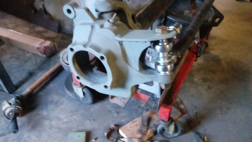

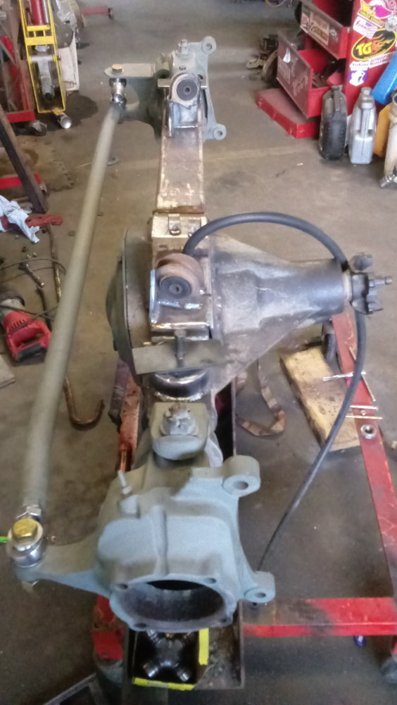

Fromt axle needs LCA mounts, trac bar mount, sway bar and steering stabilizer mounts to be finished with bracketry.
Have new Warn hubs for it. Its been geared 5.14 and spiders are lincoln locked.

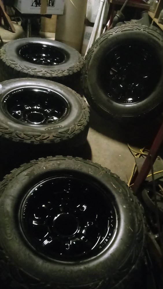

Gladiators (37x13.50x17) are ordered and should be here 7/7.

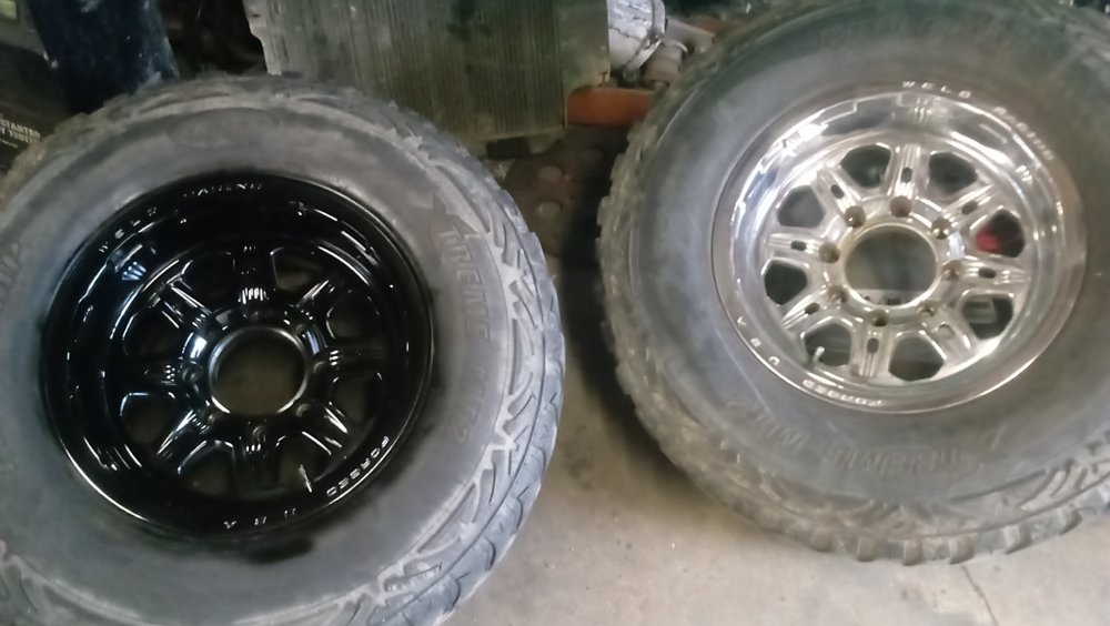

Weld racing 17s i picked up from my brother have been black tinted and clear coated ready for tires..

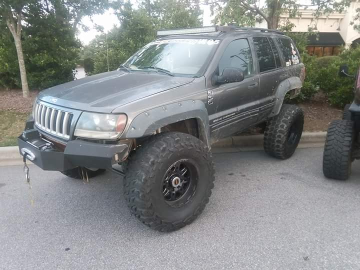

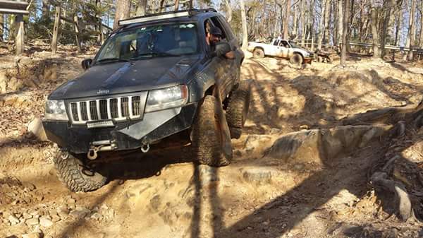

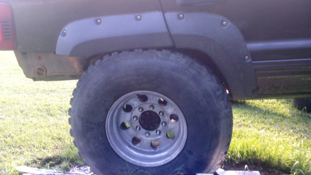

Just need to whip up some coil spring retainers and trim the fenders some. Happy with how it turned out
