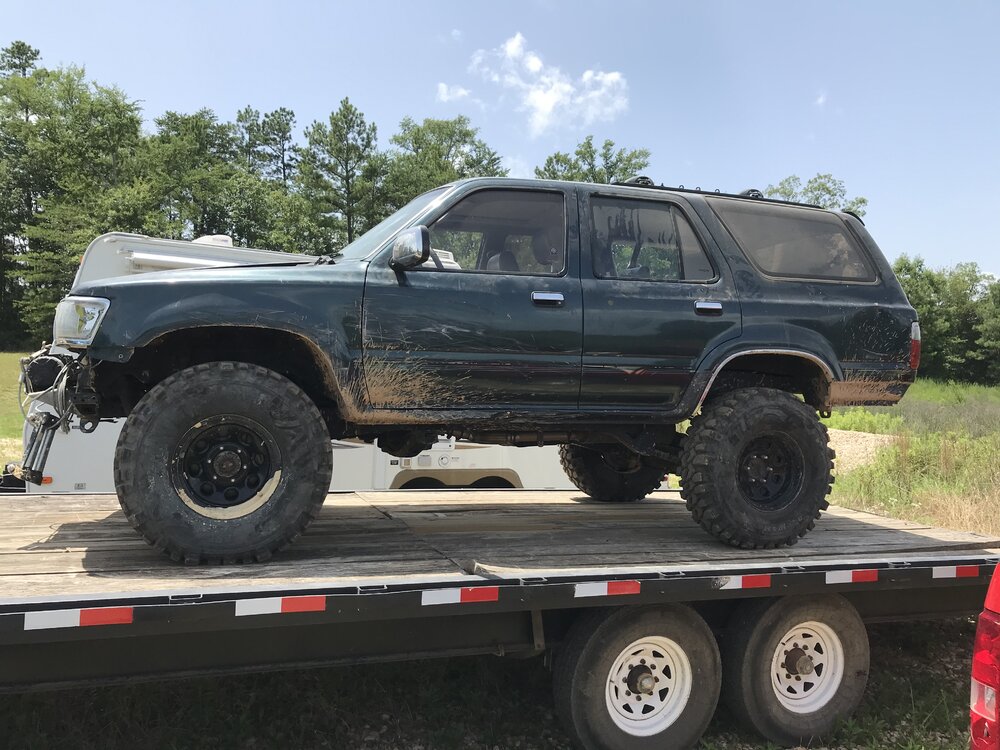

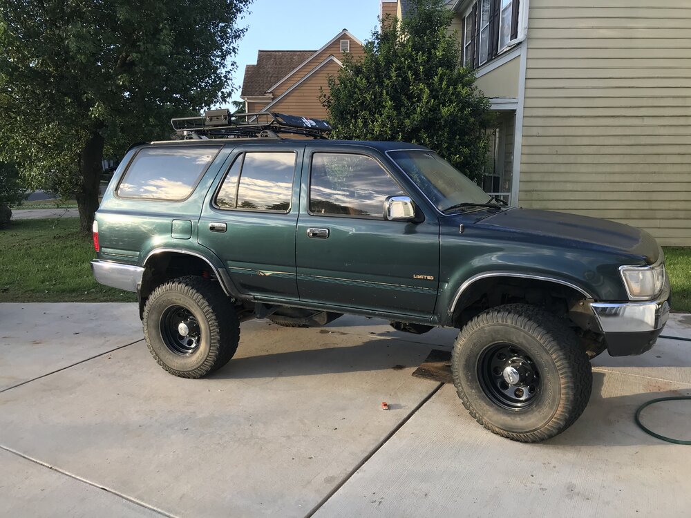

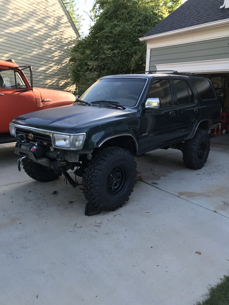

Picked up a 95 4Runner Limited to build a new dedicated trail rig:
The day I bought it:
Truck had a fresh top end and a rebuilt bottom end on the 3.0 V6.
A340h automatic trans.
Already lifted 2.5” with 33” A/Ts.
Sweet roof rack.
Factory 4:88 gears.

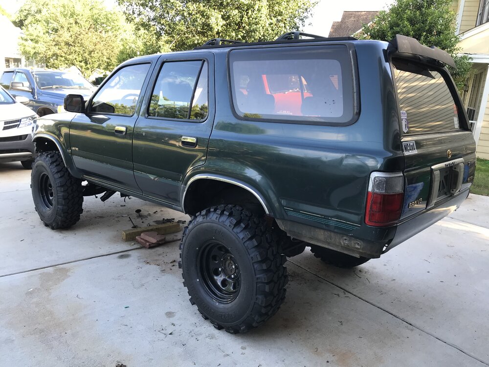

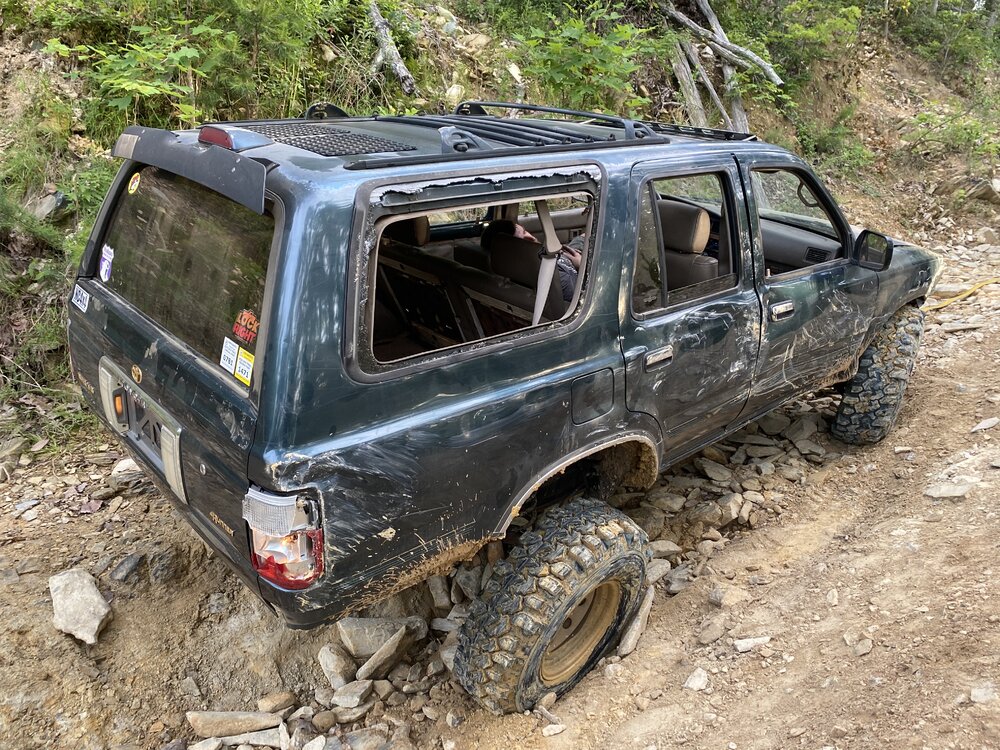

Wheeled it..

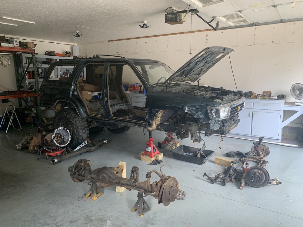

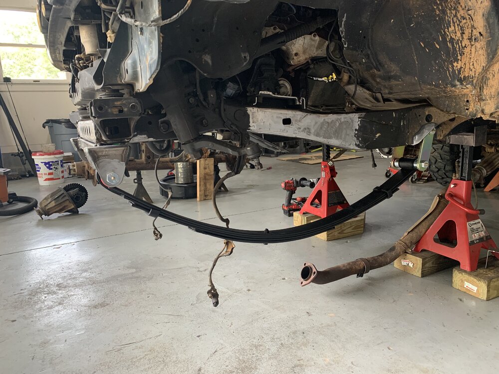

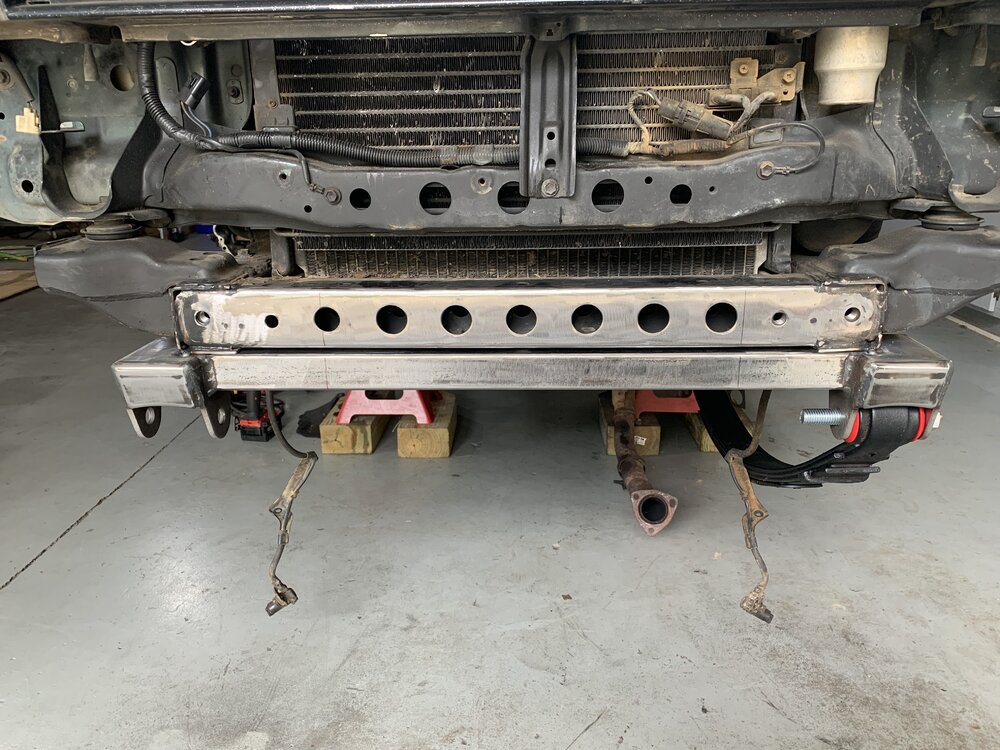

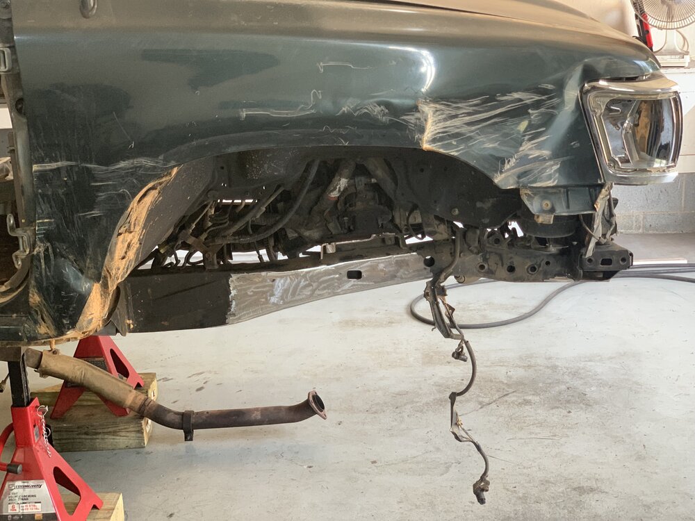

Enter Stage 2:
Obviously IFS does not hold up to “Kyle Style” wheeling.
So I bought parts, and then a 5spd equipped parts truck, then some more parts, then another parts truck, and then some more parts.
So all these parts weren’t going to glue themselves onto the truck, and since I can’t fabricate a Ham Sandwich, I called in some help.
Contracted @Kickdeez to finish up stage 2.

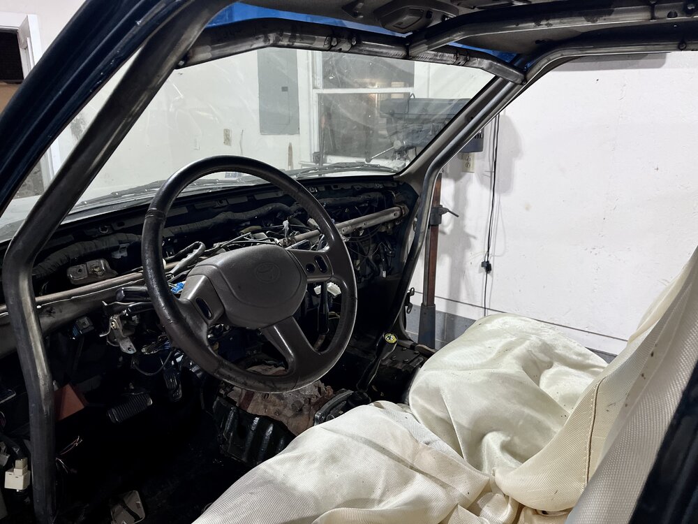

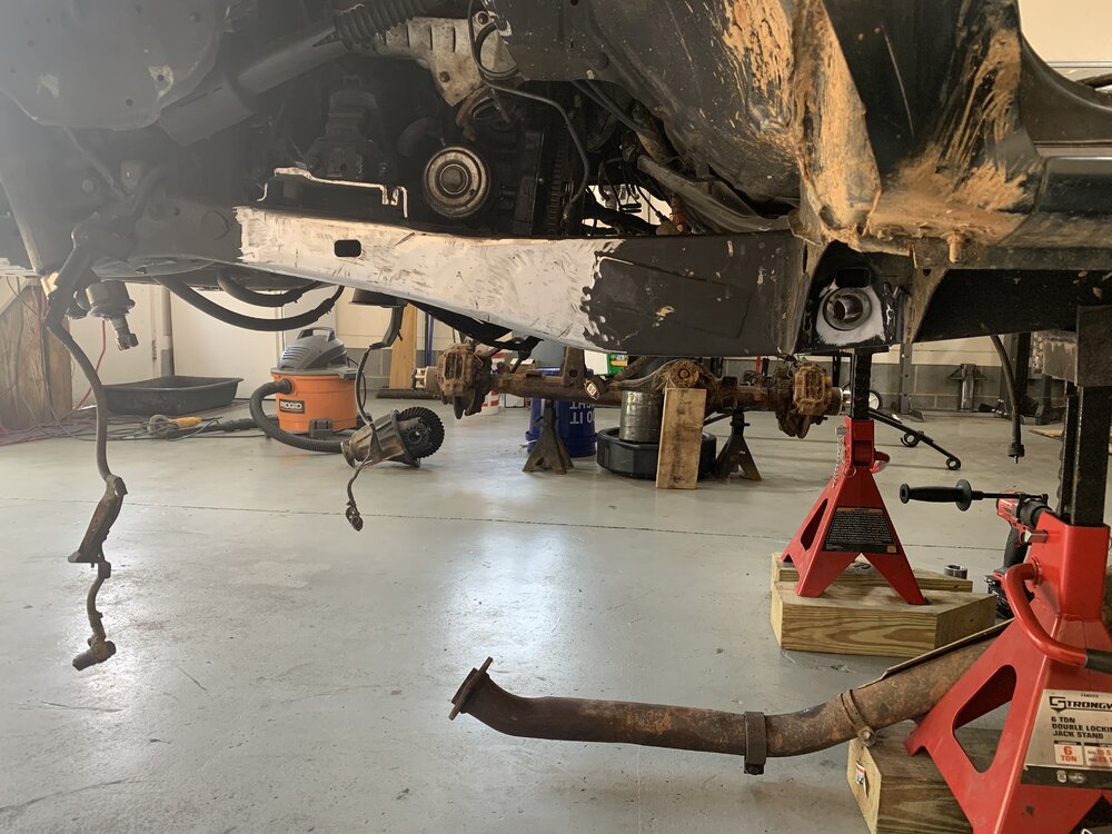

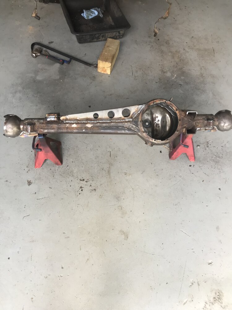

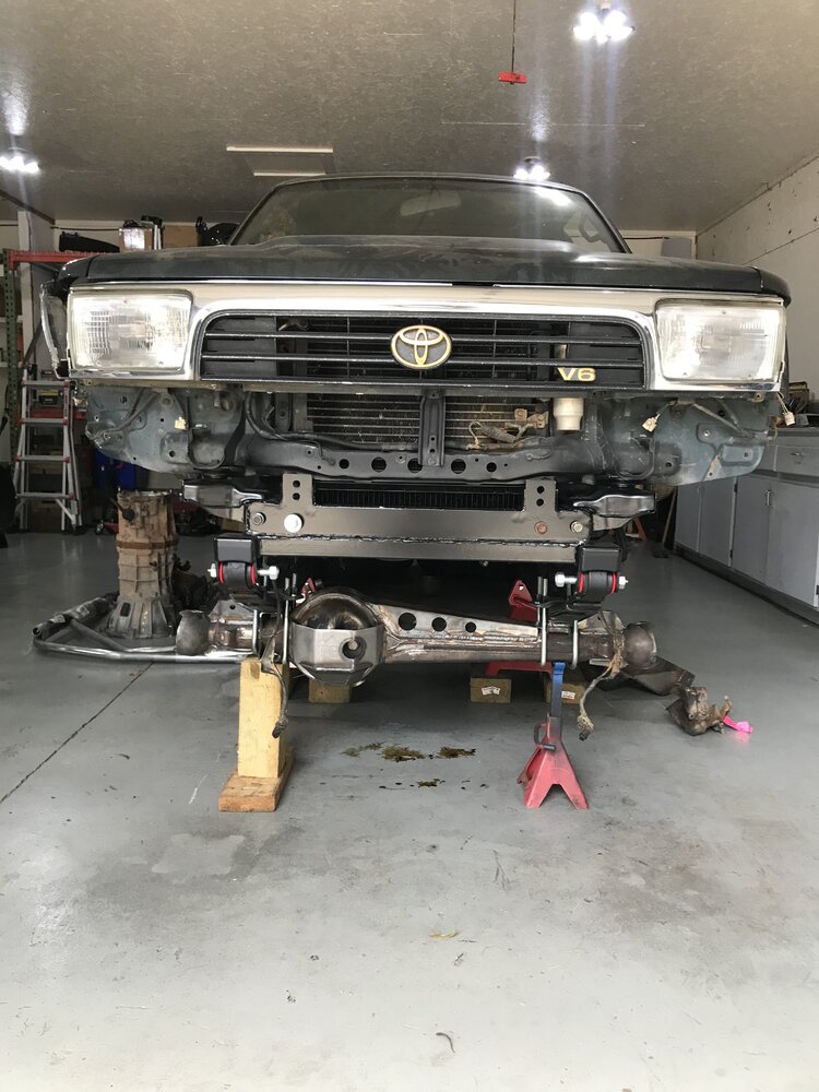

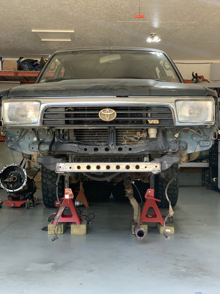

Stage 2 consists of:

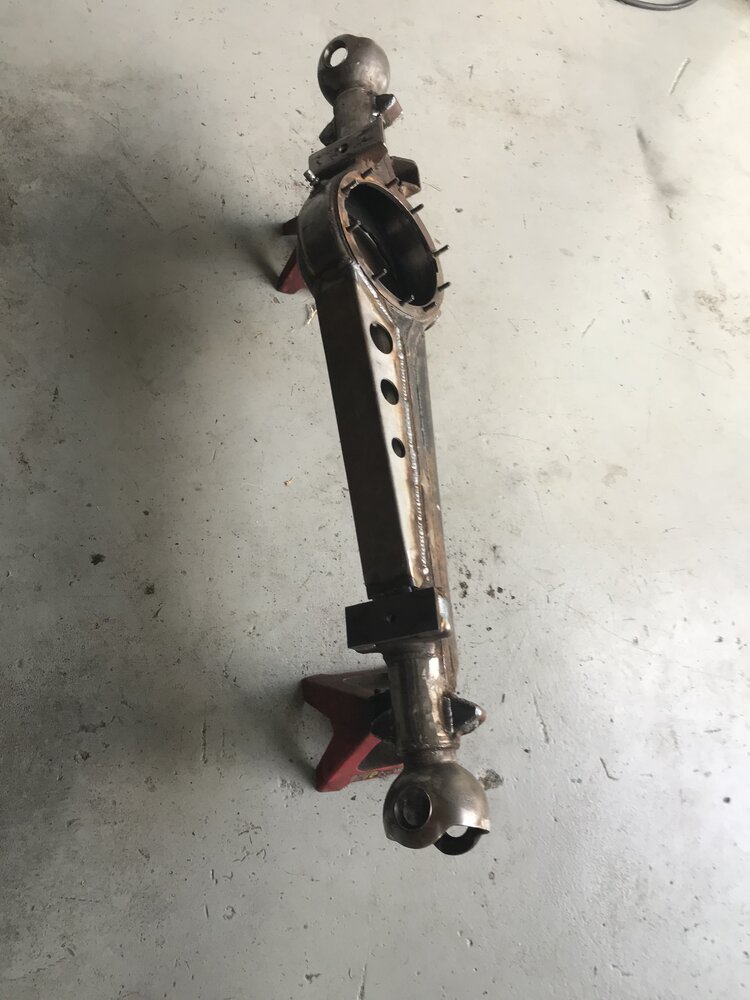

SAS with 84/85 axle including 4:88s, Spartan locker, 30 spline Longs, ARP knuckle studs, armored and gusseted, etc.
Doing Rear springs up front, leaving the rear factory 4 link with 2.5” lift.

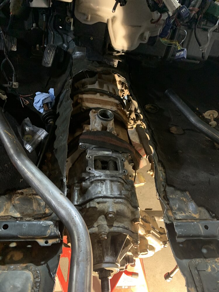

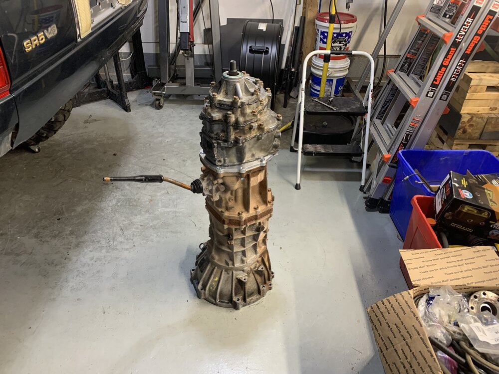

5speed (R150) swap with gear drive case adapter to a 4.7 top shift case.
Budbuilt flat belly crossmember.

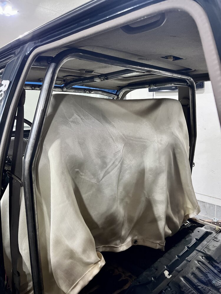

Marlin Crawler cage kit.
37 BFG Stickies on aluminum wheels.
