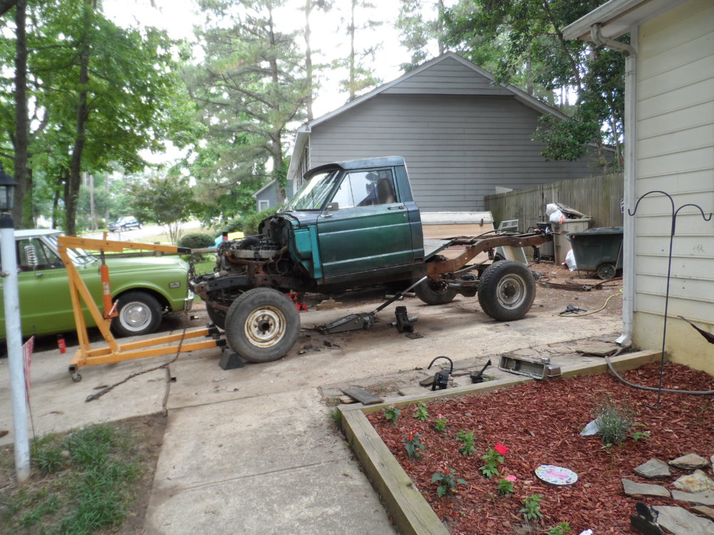

Well last year I picked up a 67 Jeep J-2000. It has no engine ,trans , or t-case .
I have some cab sheet metal repair to do but other then that it is pretty solid .
the axles are not staying with it either .
Here is the plan
I need to relocate the springs on the chassis and install the axles . the engine trans and drive train will then be installed Once that is done I am going to set the cab on the frame and remove the bed to make a tube bed . The spring on it are modified front lift springs off a chevy truck front . We are going to in stall 52 chevy springs front and 63 chevy springs rear .
1.Engine good ole chevy 350. still need
2. Trans Th400 . have it just needs rebuild .
3.Transfer case Dana 300. Also already have
4. Rear diff sterling 10.25 4.56 I have already
5. Front Dana 44 have this also ( temporary use )
Here are the pic's as it sets with a M715 clip on th
e front
