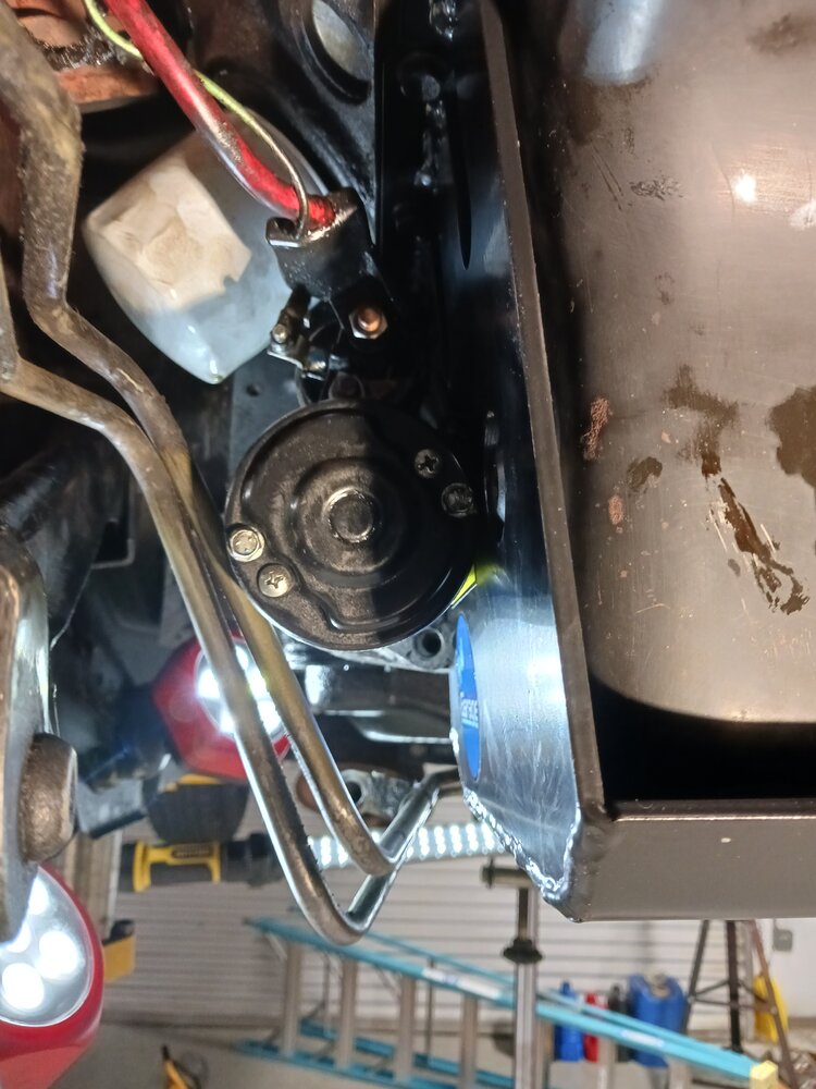

Wow, got bumped down to page two! Guess I'm slacking. Not a whole lot has been accomplished since the last post. I did have an oil pan skid plate sent to me by Taboo Customs to try out on the ZJ. I had to remove the exhaust head pipes and starter to install it.
It fit great, until it didn't :rolleyes:
Starter made contact so I had to take it back off. Otherwise, it fit great!
In the company's defense, it's simply listed as fitting "Dodge 5.2 Magnum" but isn't listed under the ZJ parts list. Oh well, he's working on a revision so maybe we'll get to try another one out later on. He's also working on a transmission pan skid to fit the 46RH. I don't foresee any issues with fitment there since nothing is too awfully close to it.

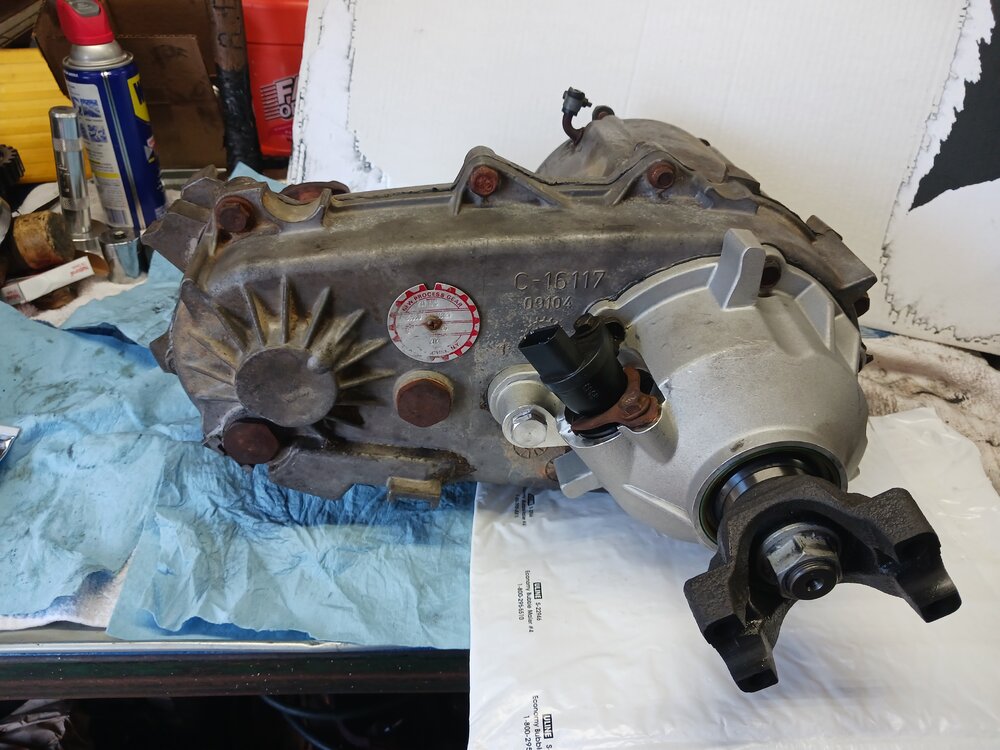

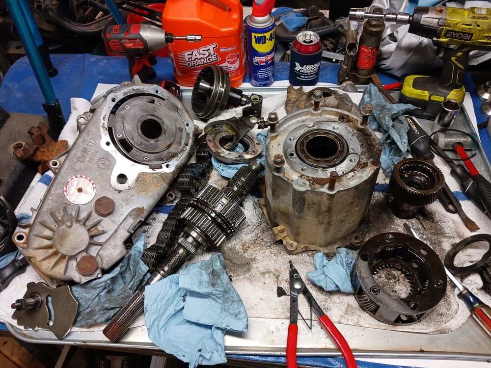

Started on the transfer case build yesterday. Will swap in the ZJ input, a 6 pinion planetary, wide chain and SYE. Still waiting on the SYE but I got the case torn down and ready for a good scrubbing in the parts washer

Got the transfer case done. Wide chain, 6 pinion planetary and a JB Conversions HD SYE, 1350 yoke. Gonna be throwing it in the Jeep tomorrow!

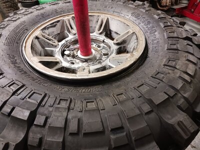

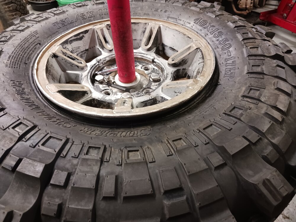

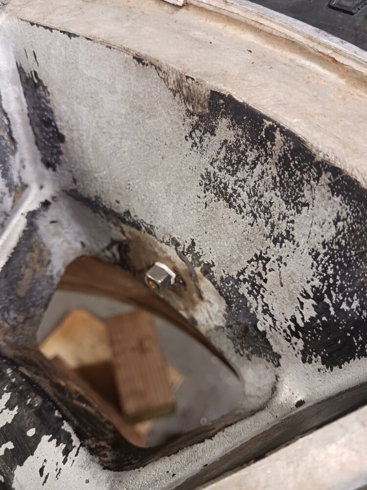

Bought these H2 wheels from Glenn (Ghost) a while back. Holes had been drilled in them for internal beadlocks. Tapped the holes and jammed a pipe plug in there. Still leaks a little, but my real problem is the tires won't seat on the beads.
We initially were using the duct tape trick, but I thought it was making it too difficult to seat. It was just tearing the tape trying to seat, but even with no tape at all they just won't seat. Went up to 65 PSI and it still won't "pop" and seat. Left the shop defeated, then came back today to see both beads slipped off the wheel because the pipe plug leaks, but that shouldn't have happened if the beads had seated so I'm at a loss.
Edit: I'm way more inclined to think it's a tire issue than the wheel. Maybe a mismatch trying to use a comp tire with a DOT wheel?

have you measured the thickness of the bead on the tire vs the width of the bead seat on the wheel?
I have had to put 80+ psi in a tire to get it to seat on a taped bead. It is scary for sure.
edit: are those the stickies from the BLEM list? If so, the bead might be out of spec. I had a set of 30" SX2s from the BLEM list once, and the bead was too large to stay seated on the wheel.
I was going to get that hole welded up. Do you think you can get it ti seal that way?
The bead of the tire is definitely wider than the safety bead on the wheel
Im not sure youre going to get it to seat then. Id say Inner airlocks or new wheels are in your future.

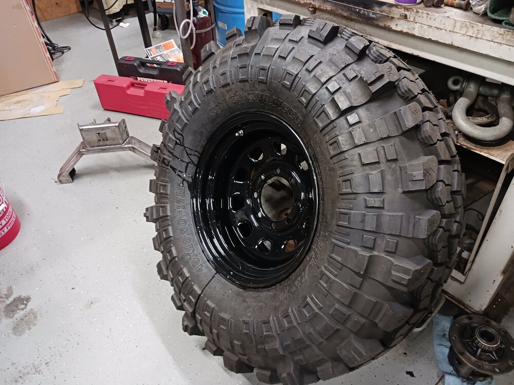

I ordered a pair of black steelies today to see if I have better luck with those. If I do, I'll buy another pair for the set.
It may not be but it looks dry in the pic I've used wheel bearing grease with a brush those super swampers have a really tuff bead to seat.
We used plenty of tire lube, but we're gonna try again tomorrow and I'll be sure to luber em up again before trying!
As for the holes drilled in the rims I'd go by a tire shop and buy some short big truck bolt in valve stems and bolt them in backwards.

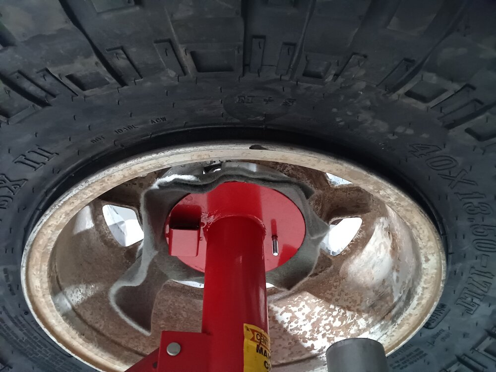

Problem solved. Tire popped onto the bead of a new steel wheel just fine @ 75 PSI. I tried the aluminum wheel one more time and tapped out @ 90 PSI without it seating. Spent the rest of the night trying to take the tire off that wheel and had almost no luck. Got the front bead off, but couldn't get the back one off for hell. Get that......doesn't want to fit on the wheel, doesn't want to come off :rolleyes::dumbass:
I'll take it to a tire shop and let them deal with it lol
