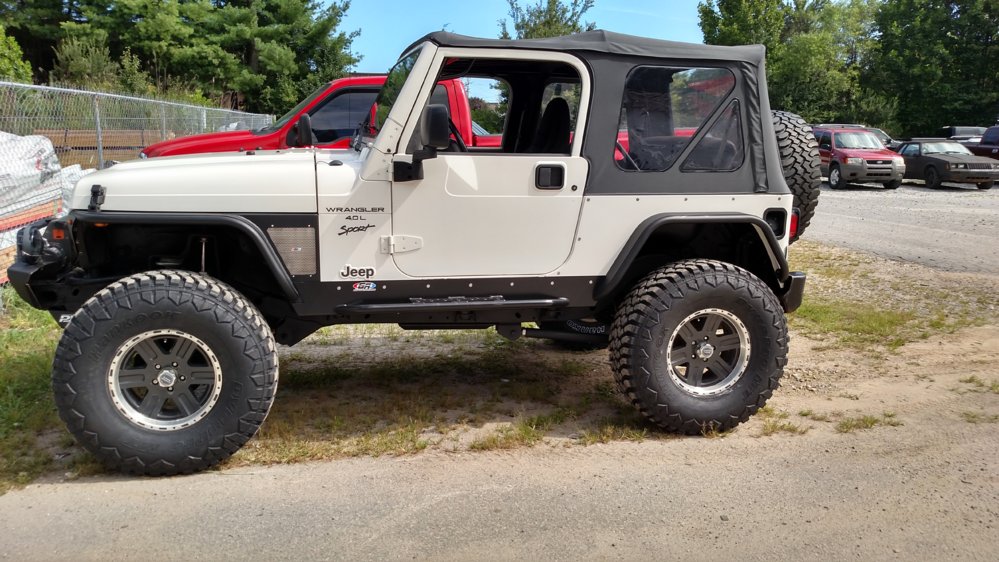

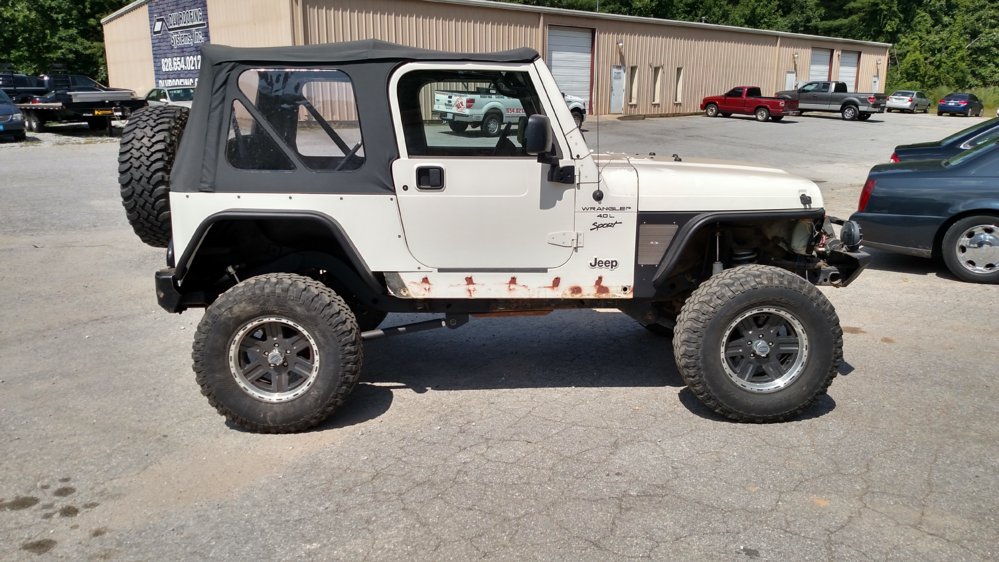

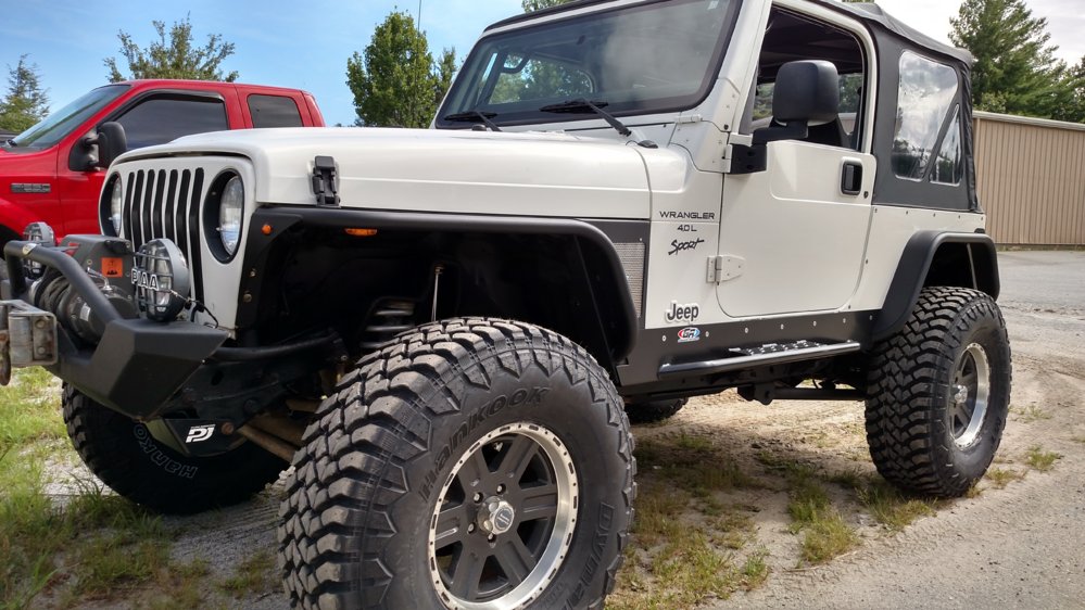

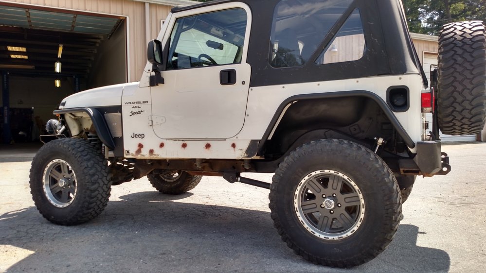

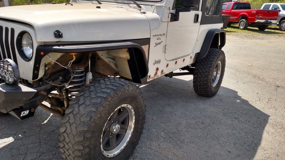

The fenders, corners and most of the associated new lighting wiring is done. @thebrotherinlaw decided on a set of Genright rocker guards to match everything GR and they should arrive in about 10 days.
He plans to add 35s really soon and they should fill the fenderwells a little better than the current tires do.
Aaaaaaand she's done! New tires went on today and the Genright rockers were installed earlier this week.
35" Hankooks fill out the new fenders nicely. I swapped out the TJ RE 3.5 rear coils for a set of stock JKUR rear coils.
Austin is super happy with it and it's time to get it in the woods!
