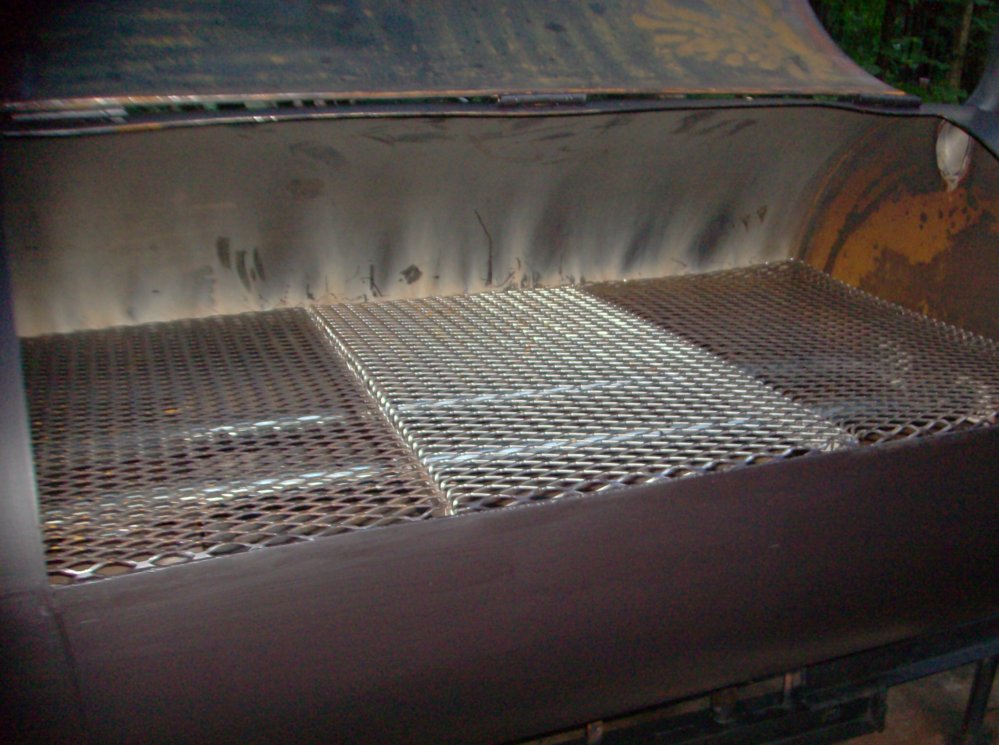

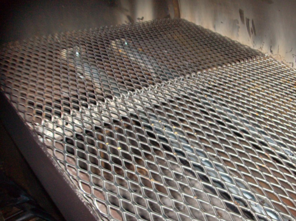

Sorry I didn't get pictures of step by step for the next few. I welded angle to the inside of the tank and cut and bent my grill tops out of 10ga 3/4" hole expanded metal. Also welded support to these to give them strength. Everything is removable for easy cleaning, I even made the grill top in 3 pieces.
Smoke tubes installed, I bolted these in just in case I want to try something different later.

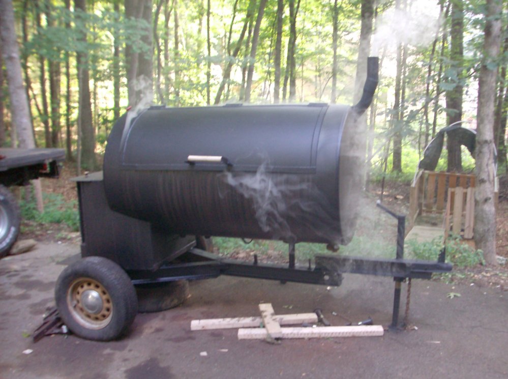

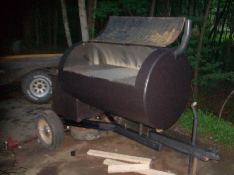

Installed an exhaust tube and trailer jack then finished painting!

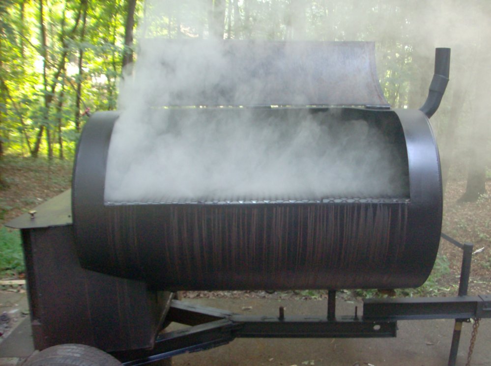

Fired the smoke up a few times this week trying to get my draft right and season the smoker.

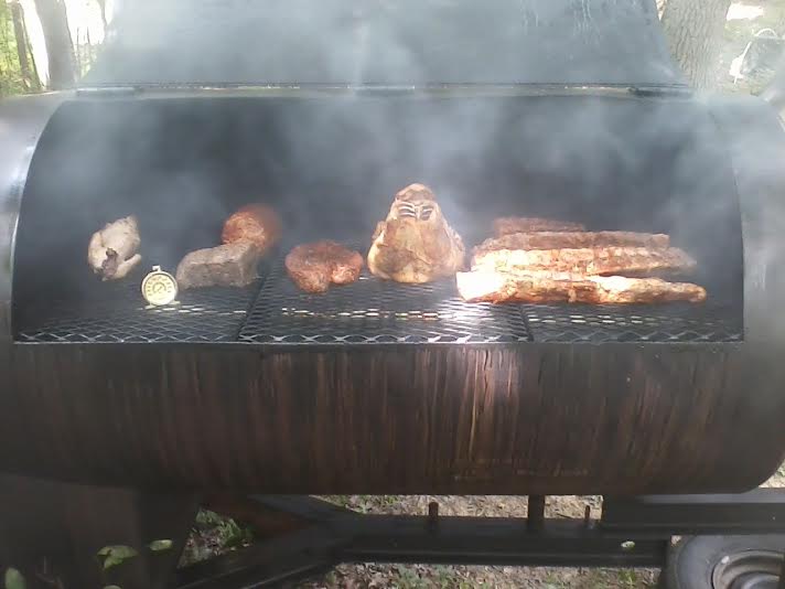

Trying her out today, have a turkey breast, a whole chicken, beef chuck roast, boston butt pork roast, and 2 racks of ribs going! Will post pics later!
cool use of the old wood stove, that turned out pretty big! how tall is it to the cooking surface?

Cooking surface is right at 38", too tall for some but perfect for me.
thats a good working height..... I built all my work benches 38" in my shop. My welding table is 36

Thanks, smoked pretty good but had a hard time getting it above 175 degrees. Modification to tubes coming soon.
175 is awesome if you have the time, but I agree you should be able to go higher.
