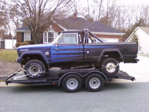

Merry Christmas to me! Always wanted a J truck. Picked this one up from a fellow member down in Spartanburg.
1977 J10, Short bed. 360, T18, D44's, Factory A/C, 70,000 miles. Cab is very solid and the bed only has minimal rust.
Build plans are to do a M715 style truck with the better parts the more modern J truck offers. I want to add the round fender wells/extensions and it already has the correct Kaiser grill installed. Going to modify the short box to take the rear round flares. If I get real ambitous, maybe adapt a NV4500 to make the road trips more RPM friendly. Planing on it being a driver/hunting rig with decent offroad capabilities. I am keeping the A/C and other creature comforts like working heat and wipers!

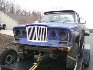

Awesome with the Kaiser Front end!! What a find!
I know, right?!! Love that Kaiser front end, it's so ugly it's awesome! Makes the whole truck look 20 years older. I am sketching up a grill guard and bumper that mimics the M715 but is beefier and hides a winch behind it.:huggy:

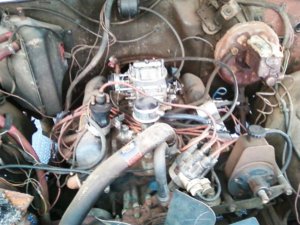

Ordered a HEI and a carb kit for it last Saturday. May get it fired up this weekend. Got the pistons soaking in Marvel Mystery Oil just in case a ring got stuck while it was sitting. Going to prime the oil system after I make a priming tool out of the old distributor. The old electronic ignition box had melted down the fenderwell a while back, so I got a HEI to eliminate the hassels that come with the factory set up.
