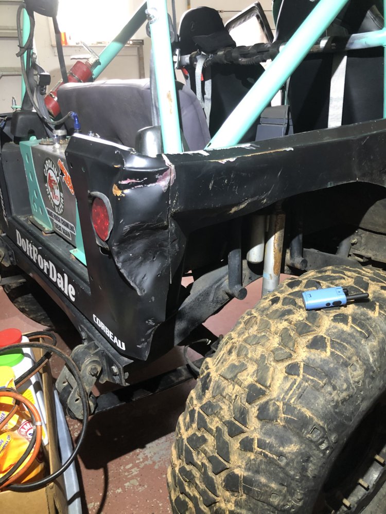

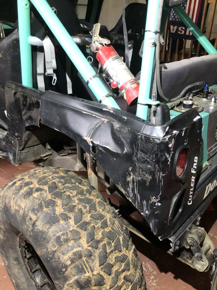

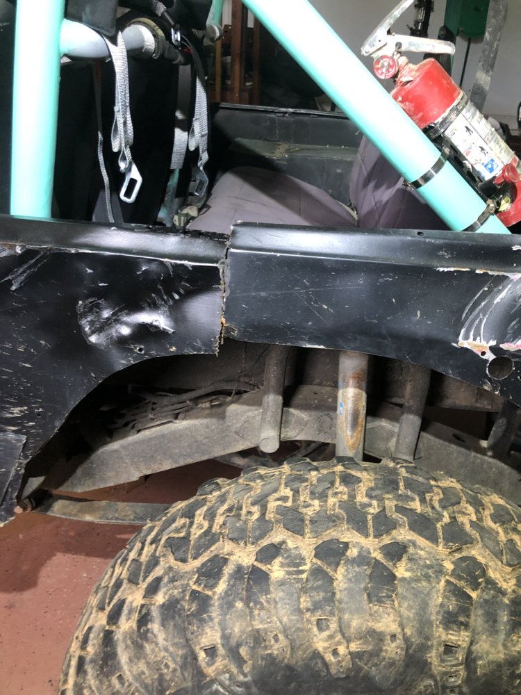

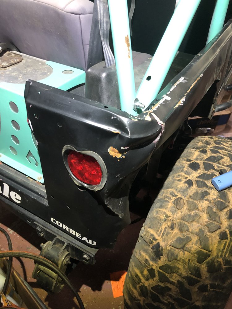

I snapped some pics of mine to show you what happened to mine. When I bought it the rear corners were TRASHED. I mean terrible. I took the time to cut the back tub off and graft a new tub on. It looked fantastic. The very first trip out to AOP I wrecked them all over again.
I was too cheap to buy armor and thought with my tires and width it would not be that big of an issue. Turns out I couldn’t have been more wrong. I hit them every single time I go out. I’m stopped caring now, but man I should have put some armor on there.

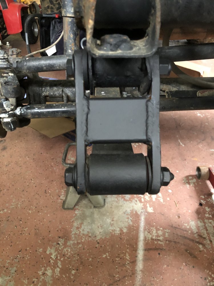

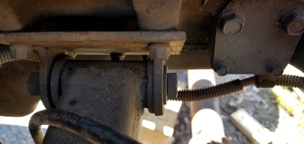

Also, on your rear shackles, weld in something in the middle of them. I did not have center support on my front shackles, when I welded in some flat tube recently I was blown away by how much side to side movement went away. Without center support it moves a ton and will wreck the bushing pretty quick

Also, on your rear shackles, weld in something in the middle of them. I did not have center support on my front shackles, when I welded in some flat tube recently I was blown away by how much side tire side movement went away. Without center support it moves a ton and will wreck the bushing pretty quick

Good point about the rear shackle, I just made them and slapped them on. The rear springs are Dakota and fronts are RE 1.5 soa. The front shackle setup sucks and pinion angle is badddd. I plan on moving the shackle from under the frame to in the frame..... Or slider boxes.

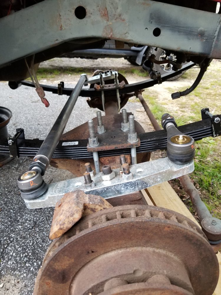

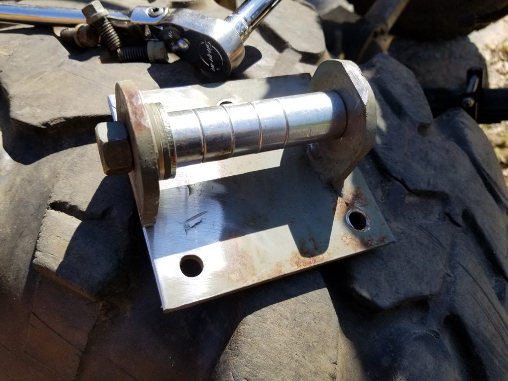

Today I got a lot of things done that were bothering me. I cut the front shackle hanger off, shifted the engine back a 1/2" and cleaned up all the old brackets on the front half of the frame. Also yesterday I mocked up the high steer.
