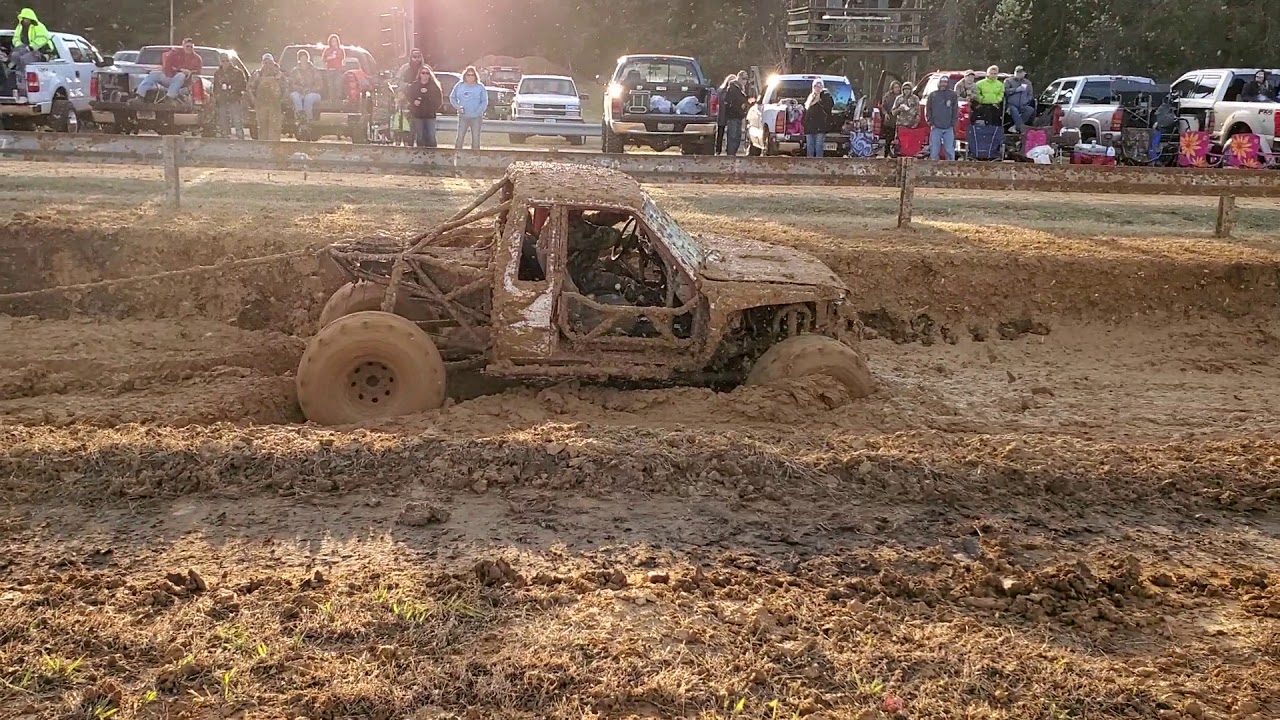

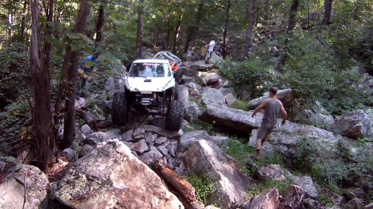

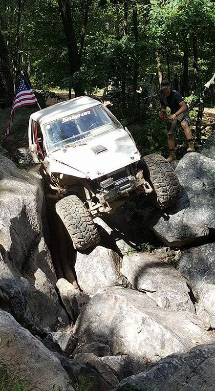

Here are some old videos and pics of the truck.

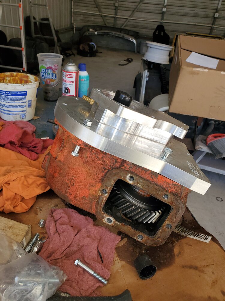

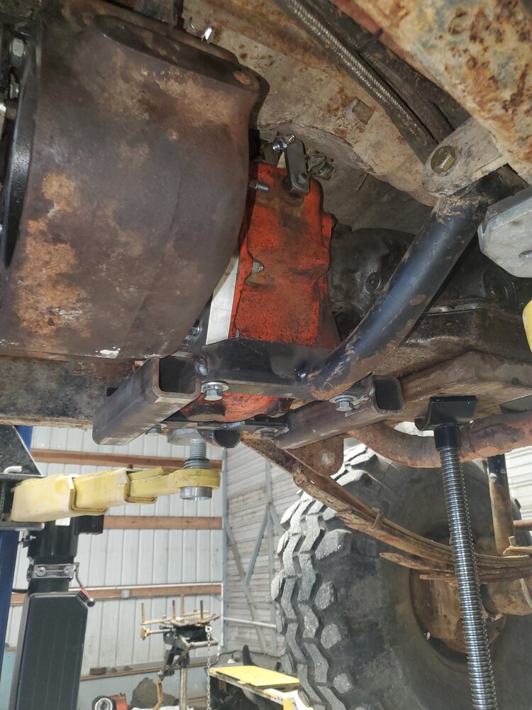

Doubler showed up and got it and the 203 mated. Disassembled the 205 and dropped it at my machinist to get the input bearing pocked opened up for the large bearing.
Also picked up a 60 front. The yota axle where as "built" as they could be and lived OK with the 40s other then the occasional ring gear. I figured with the added weight and extra gearing no way they would make it so a ton swap was in order.

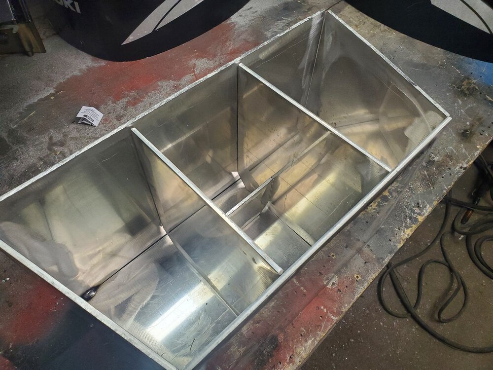

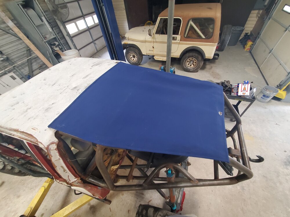

Also made a top to keep some weather off the kid

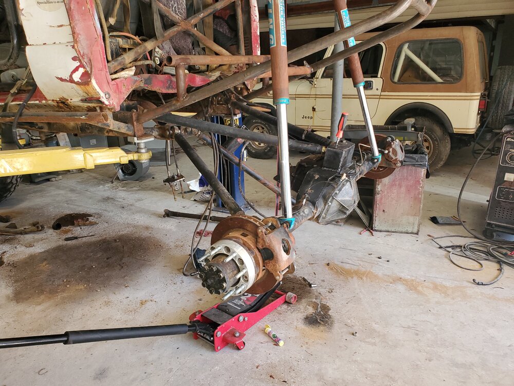

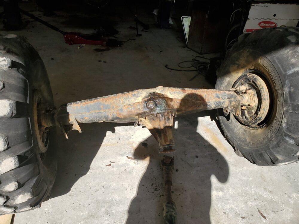

Found a deal on a 14 Bolt With 5.38s, linked disc brake swapped already.
Ripped both axles out this afternoon and started putting the tons in.
Gonna run 5.38s welded rear and some auto locker in the front. Probably what ever I find used cheap. :lmao:

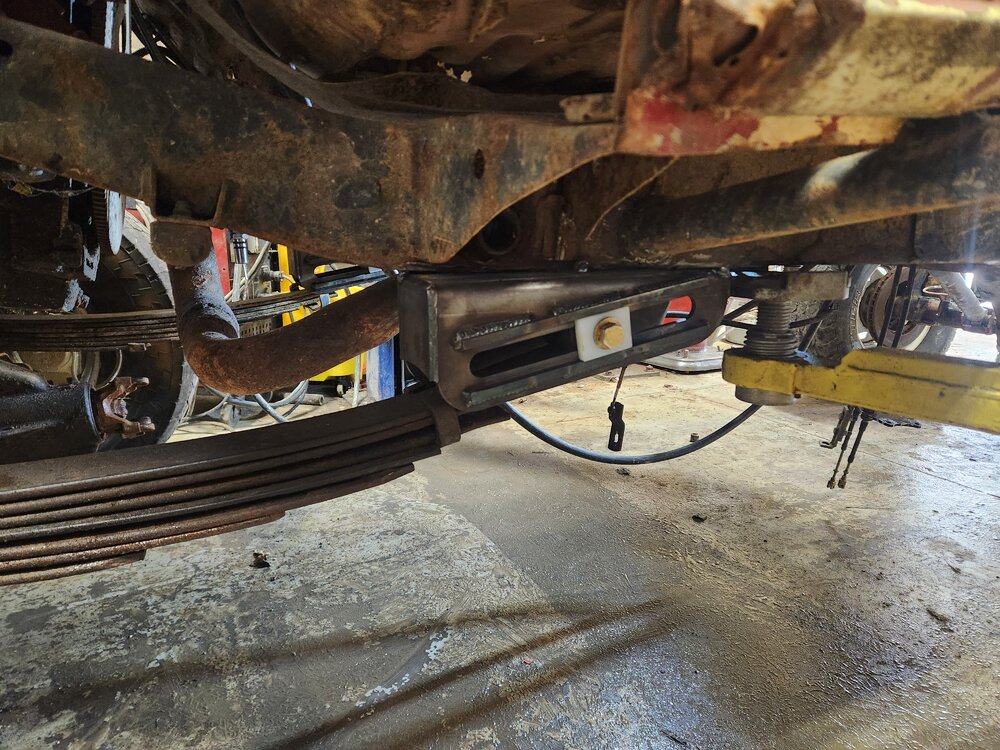

I installed some spring sliders from LII. I had horrible U-Joint angles at full droop, the sliders gave me about 3 degrees back and flex just as good if not better then the shackles.

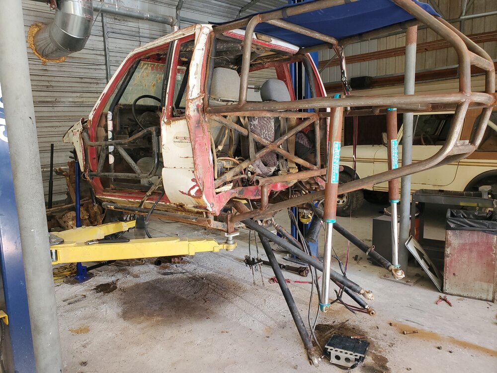

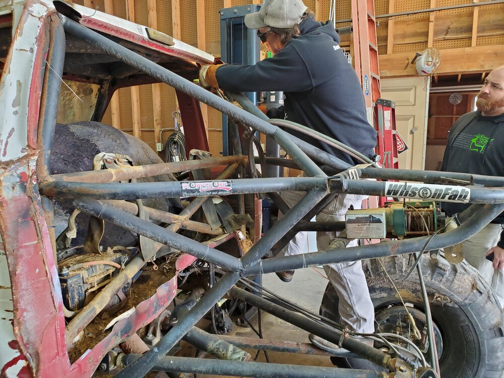

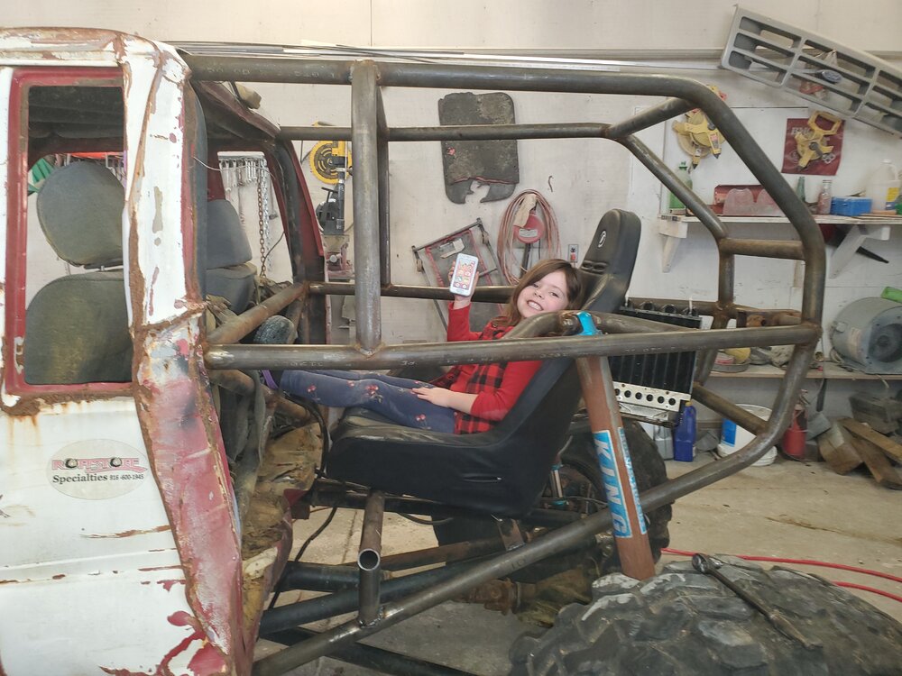

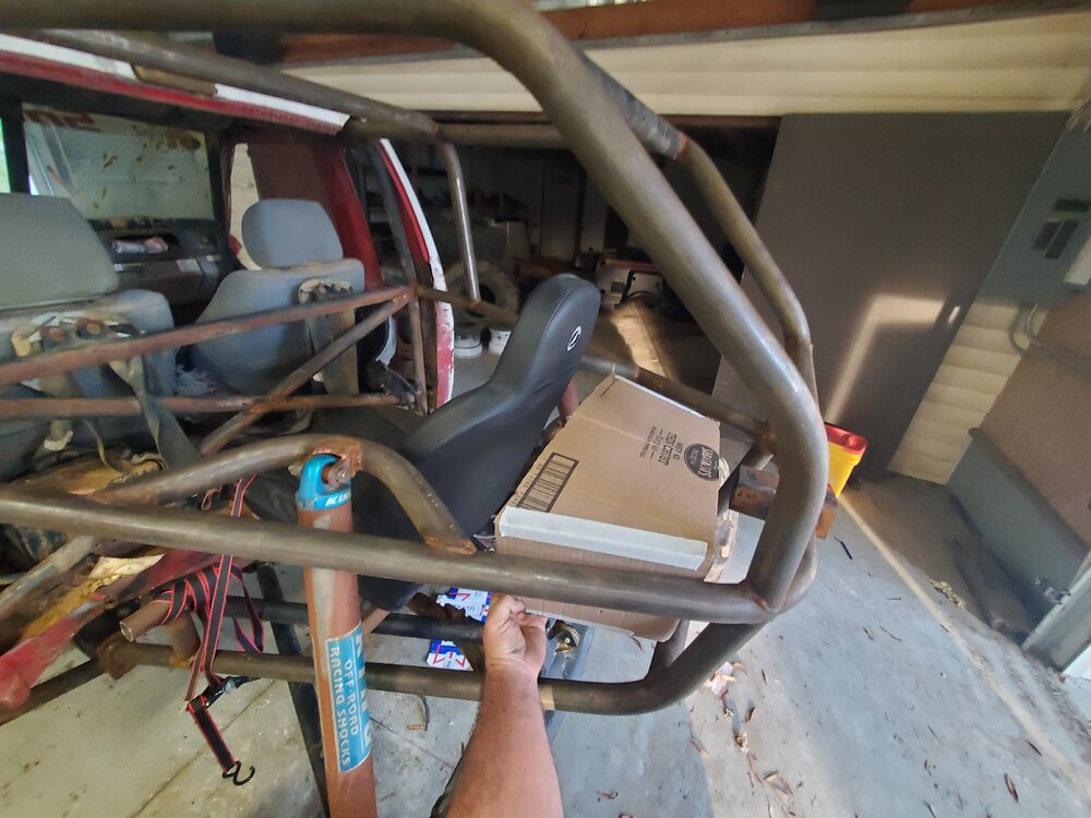

I also ordered two more suspension seats so I cut the old frame work and tunnel out so I can tuck everything up nice and pretty like.
