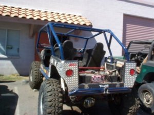

OK im lookin to start on the cage within the next few days. This will be a first for me but ive read up on the subject. Heres what I got in mind. . . (and I done it in paint so it sucks, I miss having cad)
in the angled shot the blue is whats there already(2 1/4) and the rest is what I plan on adding (also 2 1/4) except for the yellow. I want to use 2" or less on the two side bars for clearance issues and for the grab bars in the top corners.
Whats do the experts say? Also best place to buy tube?? I figure i'll need 45' of 2 1/4 and 15' of the other.

I wouldnt base my cage off the stock rollbar, but thats just me... Also, you arent gonna like the price of 2.25" tube, and will have trouble bending it... I would stick with 1.5" or 1.75"
also, if you have the stock ebrake pedal, you probly wont be able to use it anymore when you put in your cage (unless you plan for that area when bending tube)
I can get 1.75 $35/ per 20' stick so that is taken care of. Now why not tie in to the factory bar? Wouldnt it be the same if I took it out and made a new hoop in the same place?
and I didnt say it earlier but it will be tied in to the frame not just floor.
I would add one or both of the red bars shown in the pic below.

Otherwise, the whole cage can fold to the side.

I have built a couple working off the factory cage. Nothing wrong with it at all, but it is very little more work to build entire cage from scratch, then it will be all uniform and same size tubing. Definately need the red bars in or some type of cross bracing.
