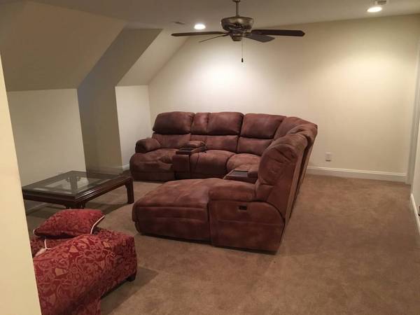

So I'm relatively ignorant when it comes to electronics...I want whatever I'm using to turn on and work as it should when I turn it on. That said, the foundation is being laid for the man cave, I was originally thinking I was gonna go with a tv in the 65-70" range. However, I started looking at the room and if I flip everything 180*, I have about 20' of wall I can play with as projection screen. I know absolutely zero about projection TV set ups. What I do know is there are two windows that will have direct sunlight on them for half the day (but can be blocked/shaded), and if the movie theater is any indication, I know light is bad for a projection system. If possible, or if it makes sense, I'd like to have HD tv capabilities (but not sure if a projector can be as crisp as a television), play movies/games and maybe live stream from a device if the situation arises. Thoughts, opinions, advice???
You get what you pay for. HD and even 4k aren't a problem. But I'd think big picture. What are you doing for sound? Do you want to put speakers behind the screen?
Contrast and black values are the biggest drawbacks. Look into special/projector paints for that wall, or a proper screen. If you're painting, sand that wall down dead flat (including paint texture from roller nap on previous coats, etc.) and fix any issues too. It's cheap and you'll see the benefits. No matter what, luminous intensity and contrast is a problem with projectors.
