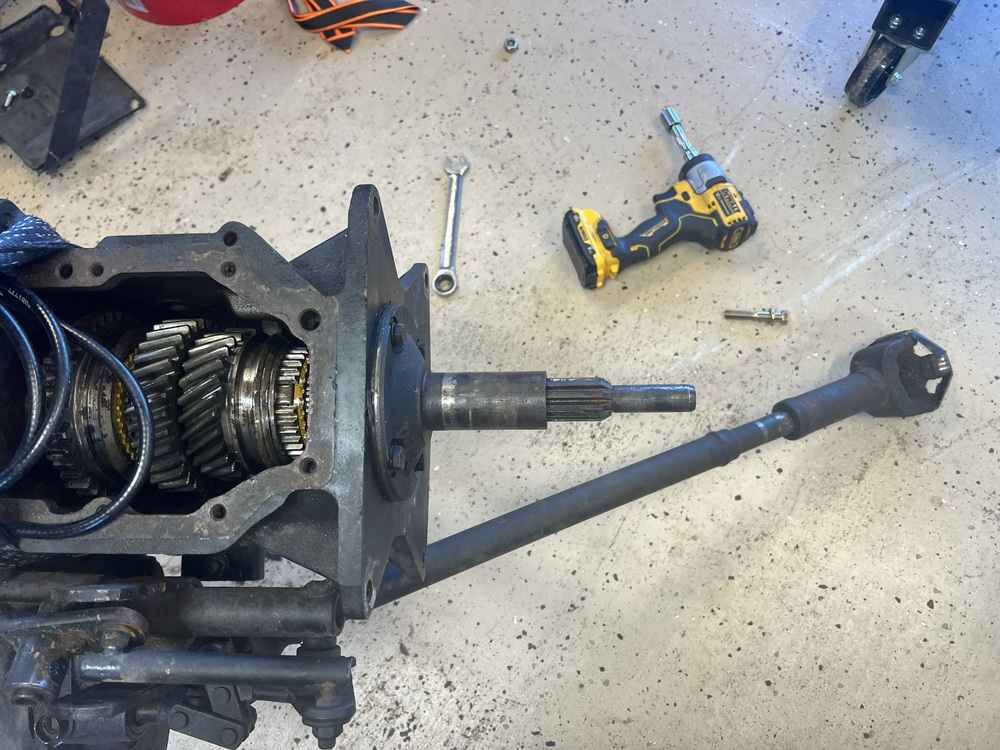

Can anyone tell me if this is the proper mainshaft for a T150?
It was in a Chevy 250 and rebuilt for that engine. I am now putting it on the AMC 304 with the correct bell housing. It is FIGHTING me.
The pilot bearing and clutch fit. Everything seems to measure up correctly.

Did you use a clutch alignment tool?
Hard to tell from the photo if the shaft looks right not. length form face of trans to splines and to end of input shaft. then from bellhousing to clutch splines on clutch and to inside of pilot bearing, As well as diameters and spline counts. hard to say.
Yes I used it, then I cross checked the clutch splines, depth, pilot bearing measurements.

The input shaft looks right. The nipple looks a little long to me, but it’s been awhile since I’ve seen one. Looking at online images, it looks right. But without actual dims…
What’s the issue you’re running into?
Chevy and AMC had different pilot bushings. Chevy was a little under 0.600 and AMC is around 0.675. Could be an issue there.
Chevy would have had a 10 spline 1 1/8" clutch. AMC up to 79 used a 10 spline 1 1/16". Later models used the 1 1/8 clutch, but no T150's after 79.
You didn't mention how close you get to mating up to bellhousing. Several inches away would most likely be a problem with the clutch splines or possibly the throw out bearing sliding onto the bearing retainer. Anywhere from a 1/2" to an inch would point to a pilot bearing or line up issue. If it is the last 1/4 to 3/8, that is probably the bearing retainer hitting the bellhousing.
