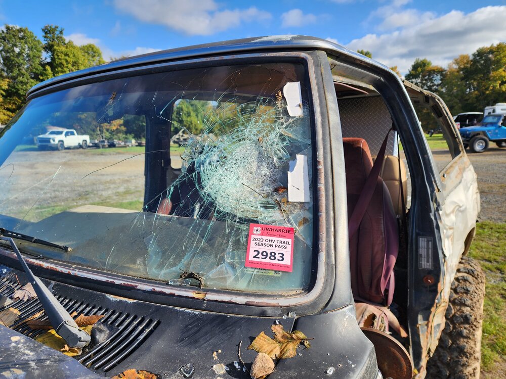

Just a friendly reminder to check your tow/recovery points. While recovering the RamCharger yesterday with a kinetic rope, the welded on tow loop of the recovery vehicle broke, launching the broken metal loop back into my windshield. The rope was being used in a kinetic fashion, with the tow vehicle using forward momentum while trying to bump the heavy ass pig of an RC uphill. Thankfully no one was hurt, and that I still run a windshield, or the outcome could have been very different.

Honestly I had glanced down when it happened so all I heard was the bang, then felt a hundred needles stinging my leg from the glass. I thought the cheap Amazon soft shackle had let go, but the end of the rope landed right by my door and I could clearly see the shackle and rope still in tact. Then we figured out what happened.

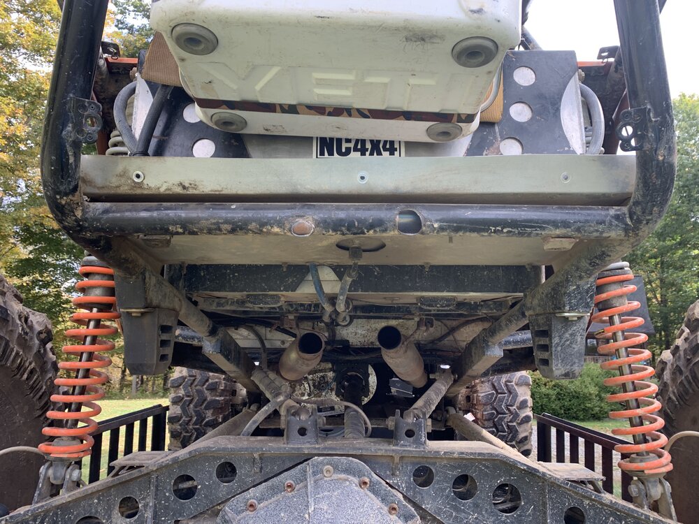

My rig. My tow point.
@CLRracer came over the radio, rig was dead at the entrance of Rubicon. The obvious answer, that many of us have and will continue to do is go help.
Got down there and got hooked up and I gave her hell trying to get traction pulling up the trail to get him out. We ended up hooking @Mrxdieselx YJ to me, and essentially had an offroad train chugging up the trail.
We made it a good ways up, before the loop left the chat. It’s an absolutely horrible feeling, and a horrible sound. I’ve seen seen some videos back in the day, of guys getting cut, hurt and worse and the sound of metal tearing and cracking at the same time, is one I do not ever want to hear again.
The loop was 1.25”, .120 DOM welded to 1.75”, .120 DOM.
I’ll state this for clarity, I did not weld it; Not saying I’m a professional, or that mine could or would have been better, I’m saying it because I can’t get the sound out of my head, nor the feeling of ‘what if,’ especially when a friend and his family are in the rig being pulled. After it happened, and everyone was ok, I left to go find Bobby and the dozer to pull him the rest of the way.

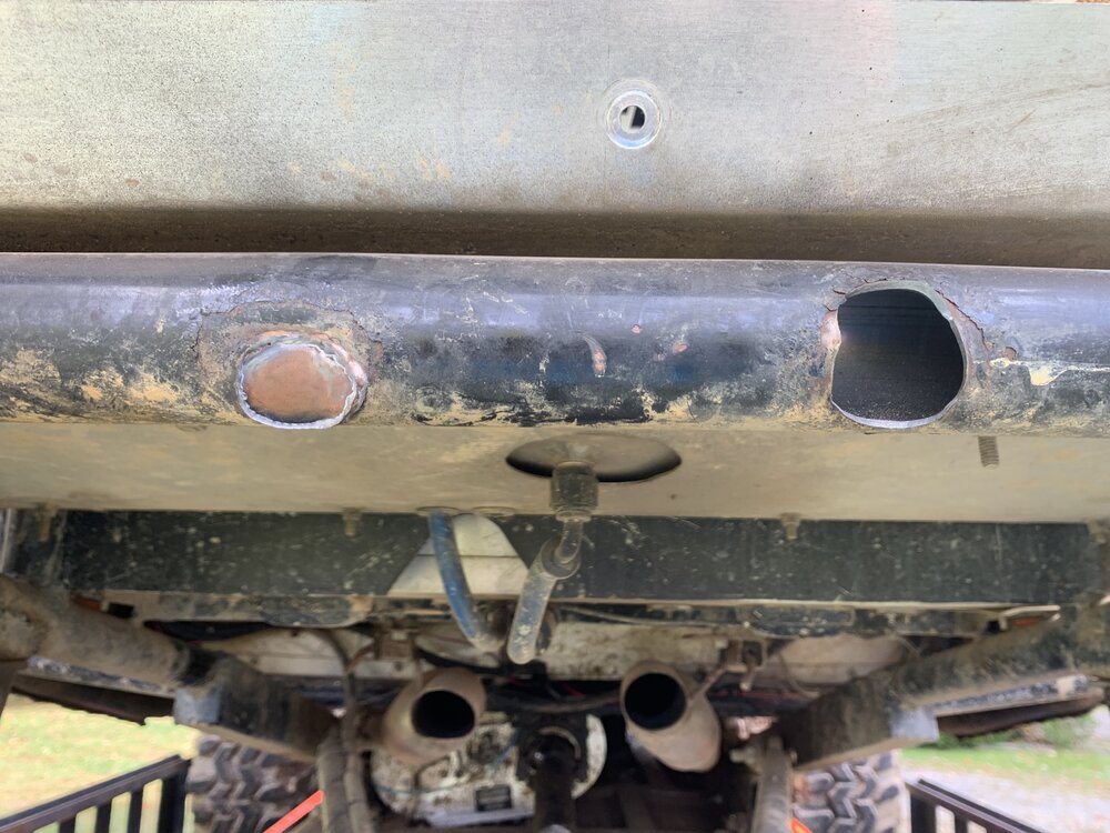

Looks like one side the metal gave and the other the weld did. I’m leaning toward soft shackles and going around my tubing for future uses.
That’s what I think, but I’m not an expert.
The cross tube itself is deformed slightly, and there is a crack on the left side weld on the bottom side.
