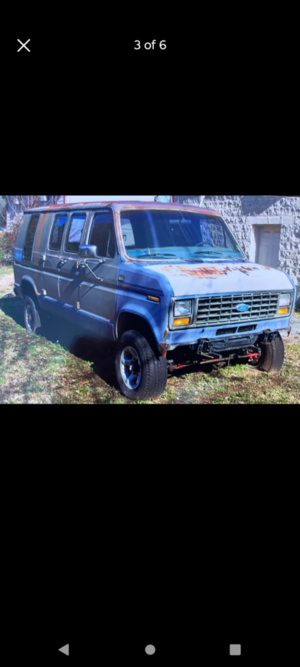

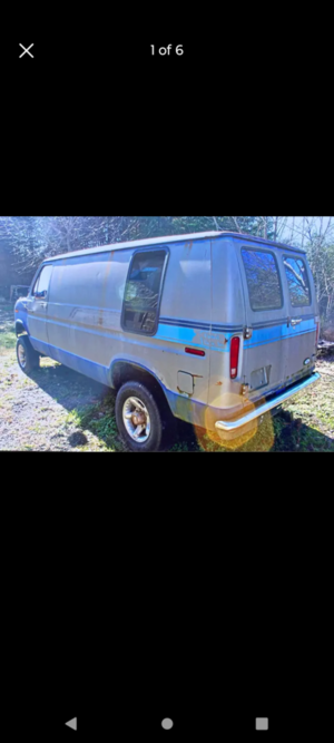

Ok, so I'm picking up a 86 E250 Van tomorrow. It's a Quigley 4x4 and it has no keys. I was thinking to disconnect shift cable at trans and find neutral...maybe move forward/backward two clicks? Now Im wondering if I can just put 4wd shifter in floor in neutral and winch onto a rollback?
Any suggestions, and any idea if either could do any harm?
