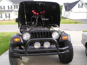

I cracker patched a bracket to hang the horns from the underside of my hood. This was the most difficult part of the whole thing.
I booty fabbed some slotted brackets to mount the horns on, 3 above, 2 below, then put this whole mess on the fender next to the starter relay. I like the hood bracket up ther, wish I thought of that.
