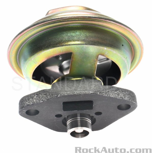

EGR on that should be vacuum operated, and if it gets stuck open, is essentially a vacuum leak directly between intake and exhaust, which would make the MAP sensor read all crappy.
pull the dog house and reach the bottom of EGR valve, you can move it by hand (do this when engine is cool) as the bottom should be open, see how freely it moves. should be smooth and easy, you probably have some vacuum hose issues to tend to as well, because its 24 years old and all....
