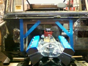

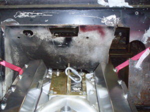

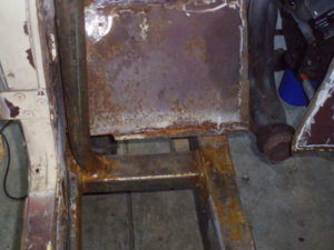

Might take you up on that after I fit it all up. This is what I am dealing with (pics). Big engine setback is making me get creative with the foot boxes and firewall. The old Scout metal is some really thick stuff! Since the MC and steering originally hung on the sheet metal I may need to just hang that stuff off the cage instead.

Me thinks I've seen this Scout, but 'da engine wasn't in it. And that was just last week!
Chris is the man Tommy, if George picked him that carries a ton of weight to me.
Scott, Coming from you thats a pretty good recomendation, cause you are like fabrasauris Rex yourself. Big Jeff up at Advance Auto in Harrisburg was telling me about Chris too. Says he is da' man.

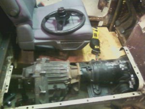

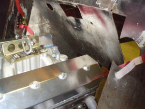

Got the drivetrain all mocked up and mounts fabbed. If Chris can roll me some beads I should get the firewall and tunnel done this weekend. Nope, never mind. The TORC race this weekend.

As long as you don't use material thicker than 16ga. I can roll all the beads you need. Tomorrow works, Friday and Saturday I'll be out of the shop then back Monday if you wanna do it then. Keep in mind whatever you need me to roll will have to be flat. It can't have any bends in it yet.
