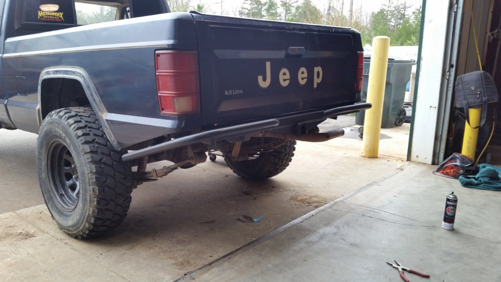

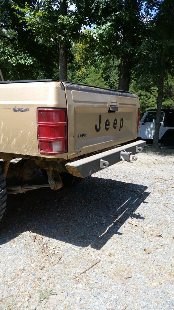

Like said already any XJ bumper will fit the front, but not the back. I just bought a rear XJ bumper cut off the mounts and made plates welded them on and bolted it to the truck. Found only one company that actually makes a rear, and it had to be welded together. Came as a kit.
