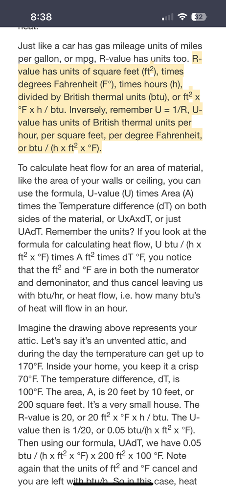

Start there. That at least gives you the basis of the formulas for r and u values.
You should be able to then compare btu difference between current and hypothetical change.
Then change btu into your desired rate whether it be watts ( cooling) or leave in btu for heating.

This is screenshot from that link
