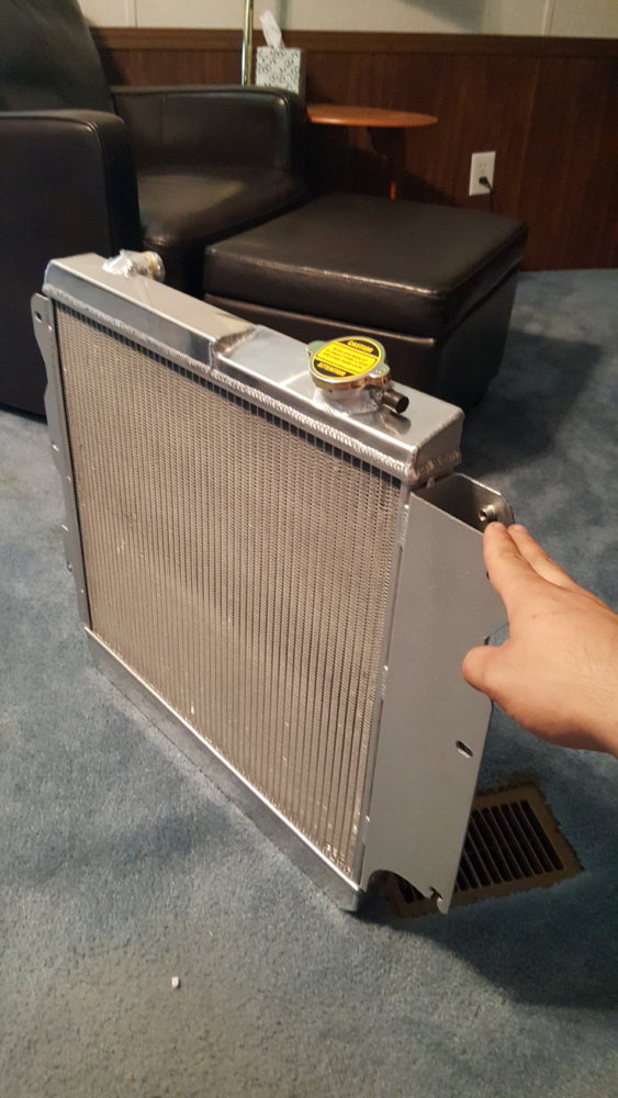

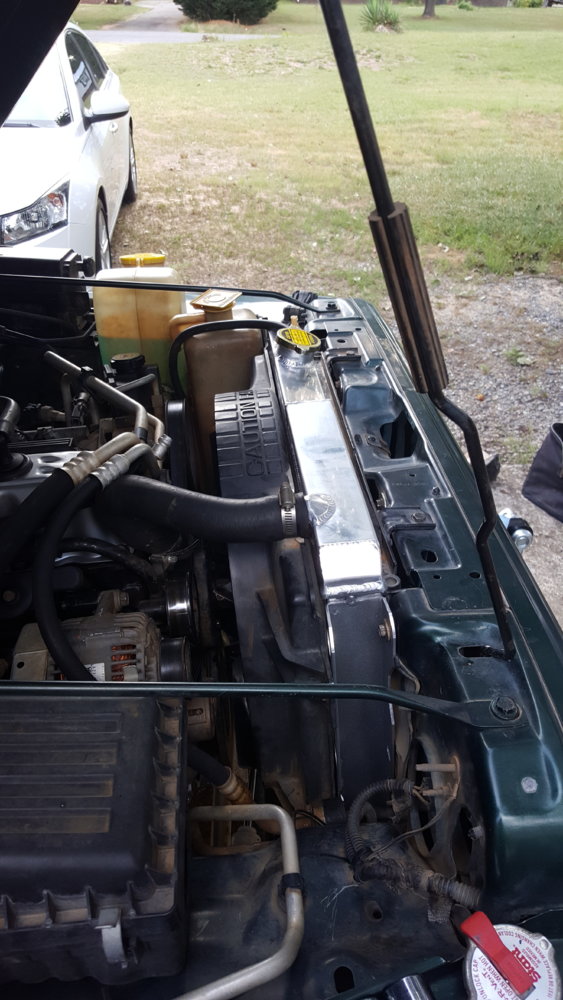

just put this in my tj, the quality was surprising and it cools awesome. For the 140 bucks it seems too good to be true but side by side it's just as nice as a 350+ alluminum rad

I've been running mine for a few weeks now...just drove it 6 hours to the outer Banks and back without issues, ran the AC the whole way.
I have a psc dual mount auxiliary cooler setup for my power steering/tranny in front of the evaporator so my stock style cheap replacement fan wasn't cutting it. jeep runs nice and cool but if left to idle it will warm up and with the ac it will get pretty warm if it's not moving...this is all due to the crappy 5 blade fan and clutch setup tj's had early on. Slightly more airflow at idle would fix the issue.

totally worth it, for 138 bucks shipped it's incredibly nice....welds are solid, also it actually fit up really good and the cheap rock auto oe style radiators are crap in my experience. The one I bought was very low quality and a single core unit...this one is a triple core and cools the jeep awesome given it has some airflow

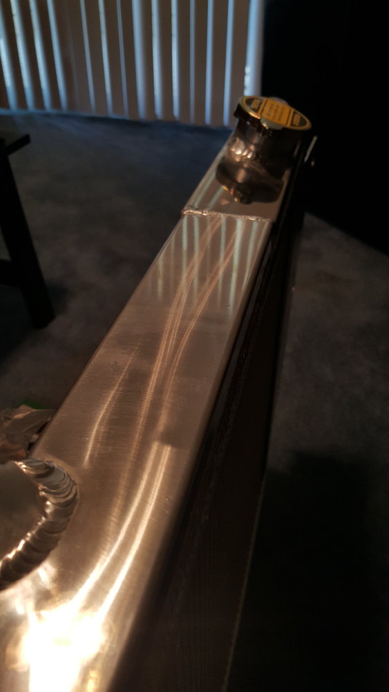

The one in the photos above is a two row, not a three. If it were a three, it would be about 3-1/4" thick.
Not sure on Jeep availability...but I've been having good luck with Champion radiators cooling 5-800hp 460's in mud pits and the trails the last couple years. $230ish from box stores, cheaper on ebay.
positive shawn? you can count the 3 rows with the cap off? (also advertised as a 3 row but I don't take that's stuff for face value)
That would be my guess, just based on aluminum cores typically being about an inch thick.
