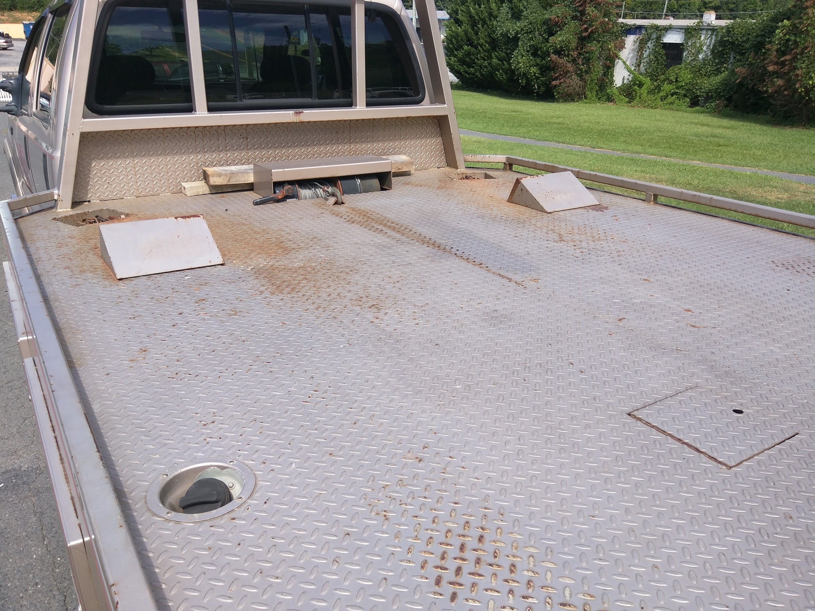

I picked up a cab and chassis F-550 recently and am considering turning it into a ramp truck to tow my land cruiser around to the various parks. The ramp truck would also have a hitch so that I can tow a camper or another trailer behind. Has anyone used, or had, one of these? If so, what do you like about it? What do you not like about it?
Trying to make a final decision. Here's one I found in Asheboro recently:

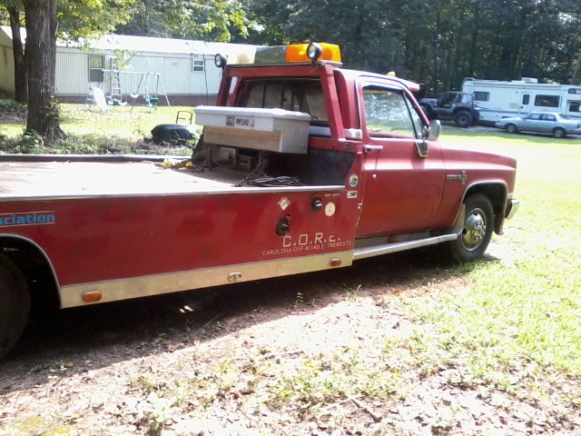

For hauling my crawler, I loved it. My family and friends loved it too. To borrow it, to call when broke down.
For me the down side was I was pulling a pop up camper, had to load the Jeep, then hook up the camper, put camping supplies in boxes, tied down on bed of hauler. Get to campsite, position and unhook camper, take off boxes, unload Jeep. Was just a pain in the ass for me. For day trips, it was perfect though.

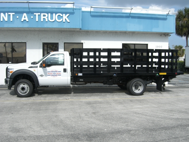

I want the ability to use this truck for stuff around the house (getting lumber / supplies, hauling off brush/trees) so my current thinking is to extend the chassis and make a large flat bed, like a rack truck, with a short dovetail, and use ramps to get up on top. Something like this but with the rack bed sunk down closer to the wheels to get the center of gravity lower.
Yes, she'll be long, but not unusable. Tons of parking room at work so I can take up as many spaces as I need in a pinch.

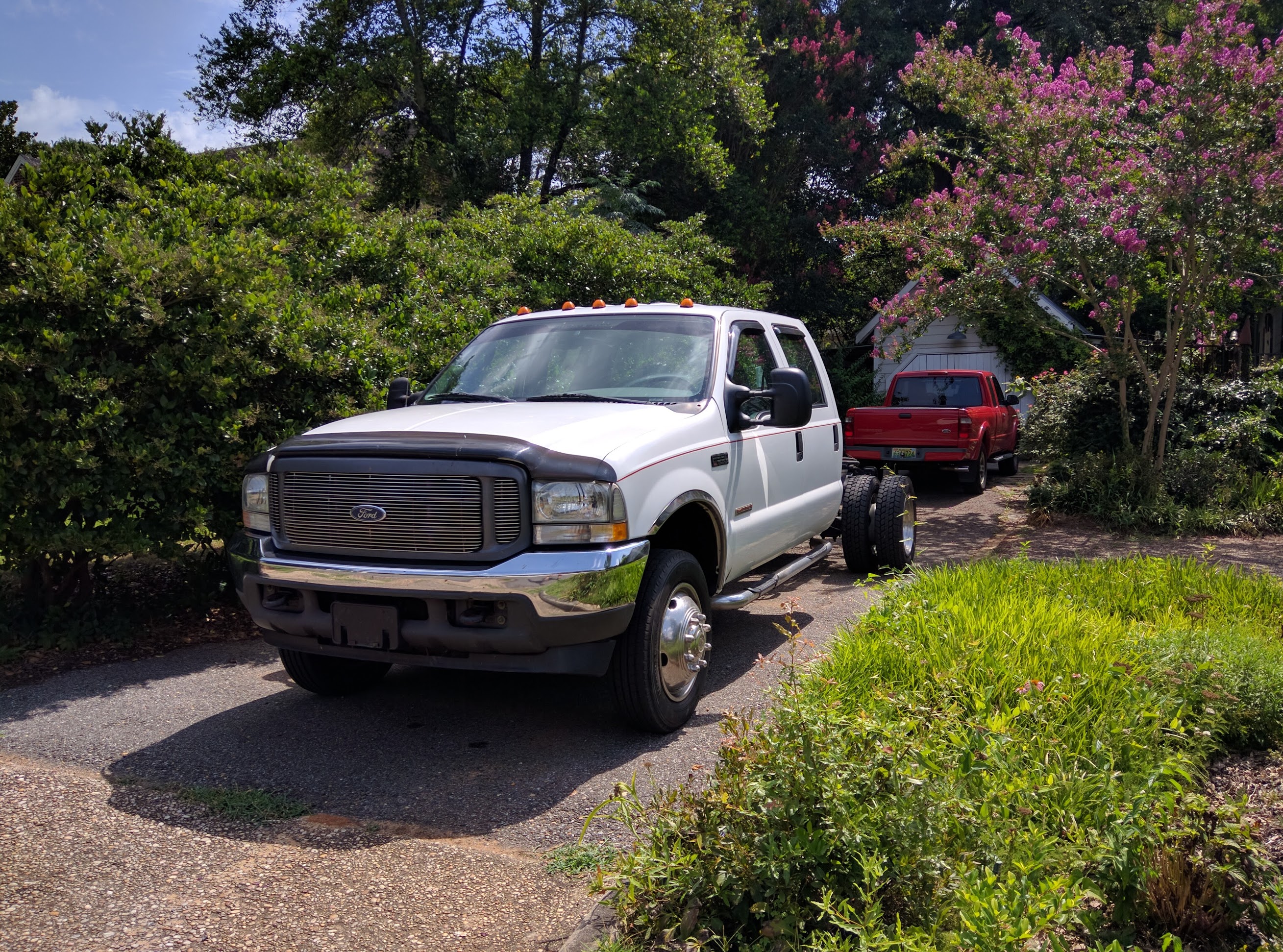

Here's the 550, an 04 manual transmission 2wd. I've since removed the wheel simulators, broken bug deflector and chrome wheel arch liners.

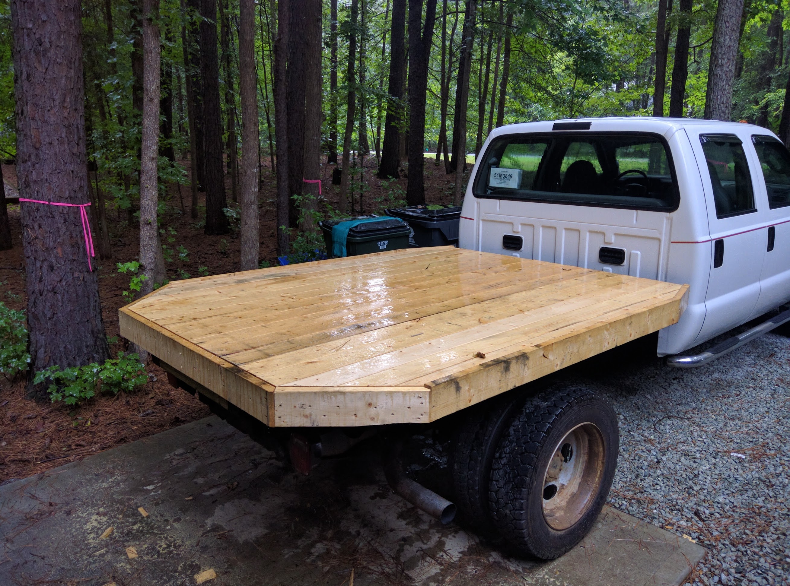

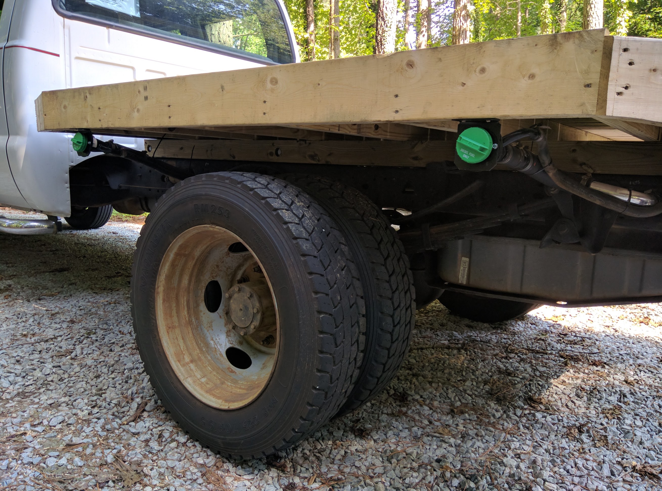

Put together a flat bed to use until I can afford to have the chassis lengthened:

The one in Asheboro didn't have a for sale sign on it. I think it was used by the dealership it was sitting at. Took pics of it so that I can build something similar.
