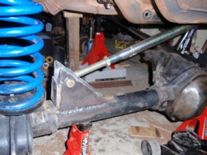

got some work done on the track bar bracket. next step is steering. i decided to go with the xkut reamer to fit the 85 blazer tie rod ends. should be here in a few days

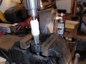

well after a few weeks of little productivity i finally am on to the steering. 85 blazer tre's with 1.5" DOM. went with the x-kut reamer, so far not disappointed.
reaming the knuckle:

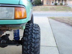

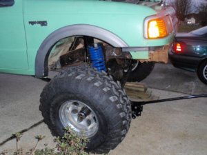

long over due for an update...

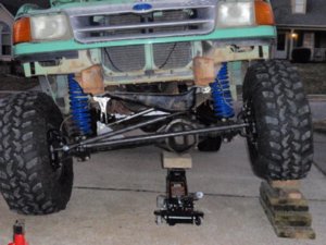

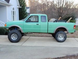

wasnt too productive over christmas/new years but worked on it a little here and there. had some trouble getting the pitman arm off to ream it. broke one puller and beat the crap out of the pitman and heated it but finally came loose. got the new calipers, rotors etc installed and finally got it on its own weight again. got the front end roughly aligned and took it for a quick maiden voyage down the street (no shocks yet). it did fairly well but getting major fender scrub on the driver side even with EB 5.5" springs! had to take a 18543249 point turn in the cul-de-sac! still need to get it better aligned and get the brakes bled then on to the rear 9in.
heres some pics:
It's nice to see something other than Toys and Jeeps. This is looking awesome, not fond of the color though.
nice, how far out did you have to space the coil buckets, I am about to do one on a 91 ranger, not sure if I am going leafs or coils yet. I have a 44/9 set and a 60/10.25 set at the house both with 4.10 gears. and a fuel injected 302
i think the spacing is about 2 1/4" cause i needed 3" on each side and with the coil retainer on the axle flipped, that put the springs inboard about 3/4"

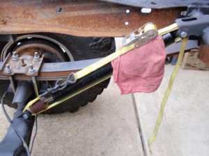

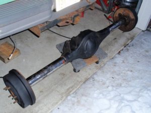

working on the rear right now. don't have any great pics but heres a couple rolling the old out and new in. cleaned it up a bit

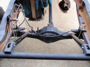

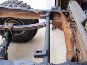

well i thought it might be time for another update. gotten a few more things done since i last posted. got the rear end put in but went for a long while with no shocks, cause i couldnt decide what i wanted. i pulled the bed off to clean up the frame rails and build the rear shock mount (for which i reused the old mounts off the 9in). i wont have as much up travel as i'd like outta the rear shocks, but i guess this is what i'll stick with for now.
onto the pics...
rear shock mount

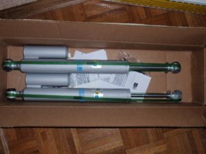

bilsteins for the front
