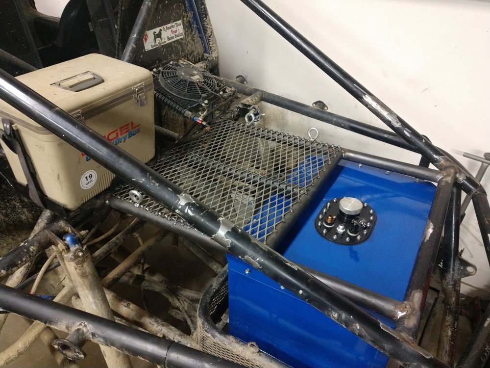

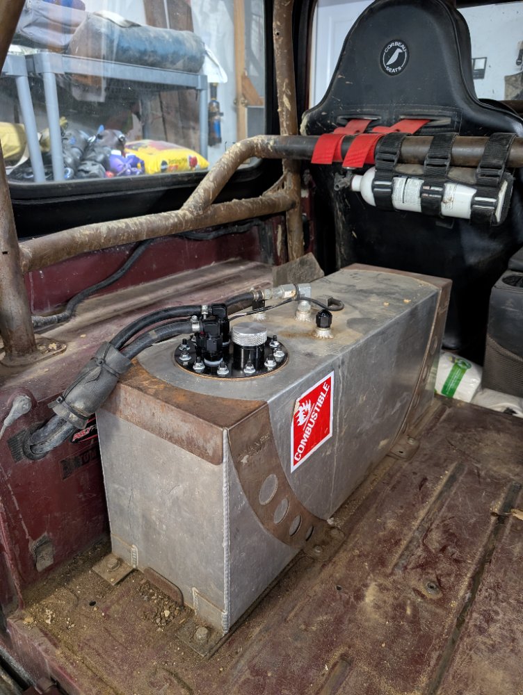

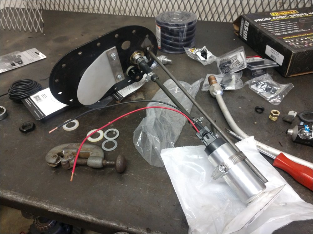

Would like to switch to an in tank pump for the Holley sniper 2 in my CJ. I've got the RCI 15 gallon fuel cell. Anyone know of a drop in fuel pump for this tank? Seems like it would be easy to find but no luck yet....
It's a pretty standard pattern, 12 bolts on a 5 and 3/8" circle...
Heck, looks like either of those Holley sniper pumps on @paradisePWoffrd's link ought to bolt right in, and they cost less than a TJ pump.
Figure out what lph you need and get a pump!
