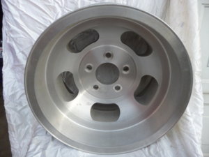

Would like to find a set of early Jeep Aluminum wheels(not the Honey cone style) Only reason is that I like them.
...Would like to find a set of early Jeep Aluminum wheels(not the Honey cone style) Only reason is that I like them.
These?
" I called my good friend Steve(89wrangler) who just happens to have heat in his garage and a lift"
think he was commenting on this
