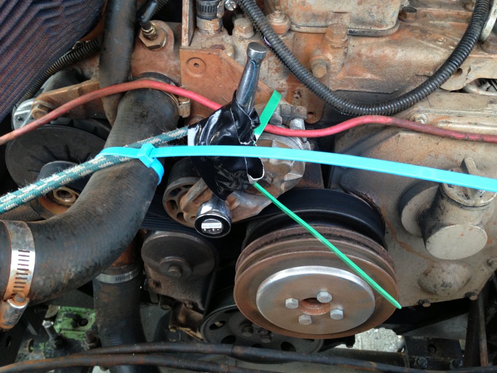

The belt tensioner on my Cummings Waggoner broke while we were on Ocracoke island
Used a ratchet, gorilla tape , bungee cord ,and zip ties to tension belt for two days till parts came in
