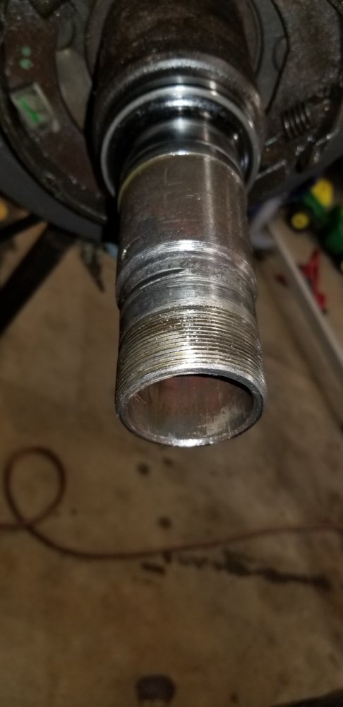

One of the rear spindles on the dually axle I bought is no good (oblonged and the threads shot). I have done googling and found a company called Axle Surgeons that supposedly fix spindles. Has anyone used them before? Has anyone used someone else to fix a rear spindle? Ditching the axle is not an issue, so only looking for options to repair this one. @Chris_Keziah can help me out with the technical correct terms of what is fubared haha

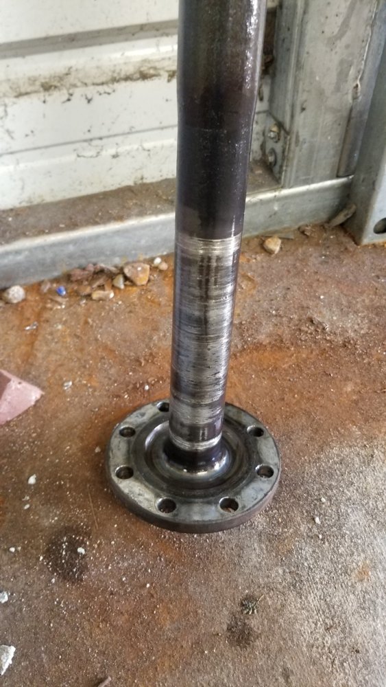

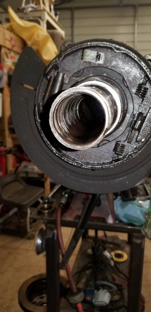

Spindle is probably beyond repair, outer bearing area is oblonged and chewed up pretty bad. Pics should speak for themselves, best guess is the spindle nut backed off. Spindle end ate the full weight and the axle shaft some.
