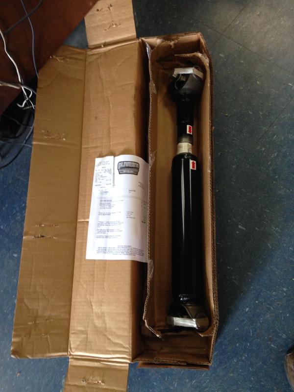

I broke his the first trip out. Twisted the double cardian. I broke his shaft at least 2 other times after that. Decided last year to try a local and got one from Carolina Driveline. I've been emailing with them. When I first found the break I thought it was a failure but after closer inspection I dented the shaft up at the Shop and this past weekend at Broken Nut it let go.
Carolina Driveline or @Oliver's can both make you a custom one equal to or better than the Tom Wood's version.
And they are local and sponsors.
CD said they could not do a 1410 on the 205. They also said the needed measurements of the seal and yoke. (Going off memory from my email today.) I have a spare so I'll likely through that one in until next month and I get some spare cash to fix it right. I'm thinking 1410 is the way to go since I am dreaming of a stroke or 5.9 swap. Thanks guys. I'll look up Olivers in the am.
